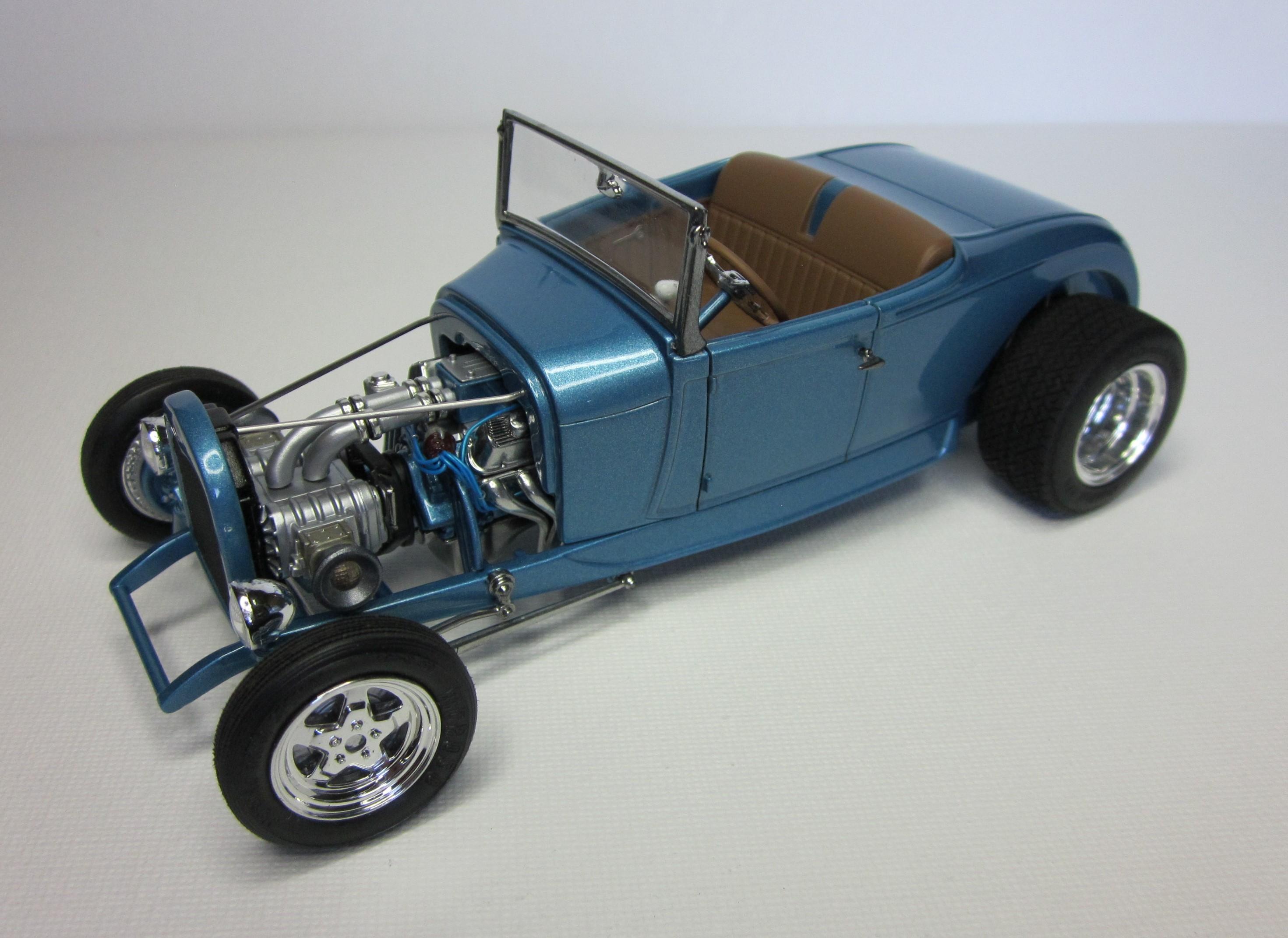

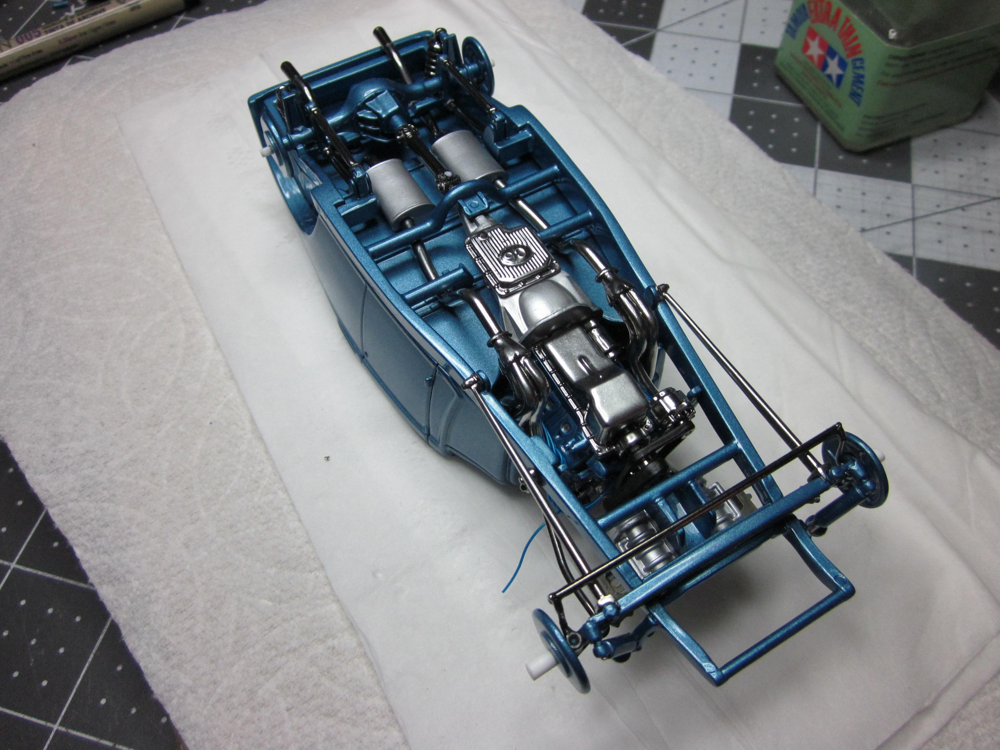

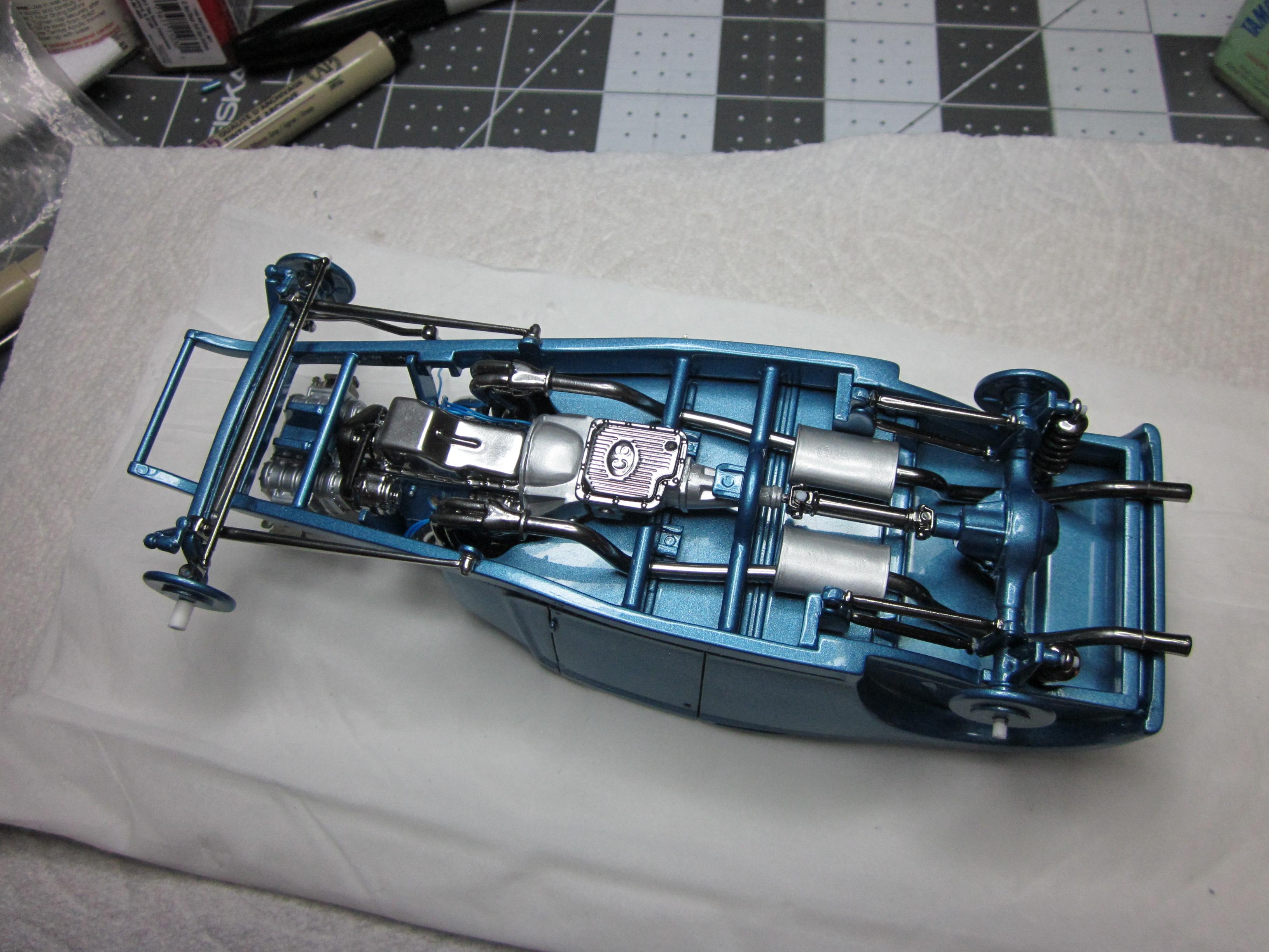

  9. Got a couple of things done on my '32. Picking up where I left off, the radiator/grill shell needed to be shortened due to the frame sectioning to channel the body over the frame. The grill shell height that was needed was figured out and then shortened. The hood needed something to land on at the front so the top tank on the radiator was cut off and mounted to the grill shell. Some small adjustments were made here and there, and things are fitting good at this point The next thing I decide to work on was mounting the fenders to the frame. But they could not be permanent yet, just want them to land in the same spot every time on the frame. I probably went a little overboard but now I am confident that the fenders will mount the same every time they are put in place during the build. The plan is to use 1.6mm rod mounted to the fender/running board and have holes in the frame to receive the rod thus holding the fender in place. Seems like a good plan. First thing that was needed to be done was to thicken up the frame rails so that holes could be drilled without the drill bit coming out the side of them. Even after adding the material, it was somewhat challenging getting the holes drilled. You can see in the pics how many starter holes were drilled, filled, moved, tried, before getting things to work. Had to add material to the running board where the pin holes were to be drilled. They needed a little more area to move inboard. All said, this was time well spent as the fenders just pop on and off making things way easier to work on. That's it for now.
