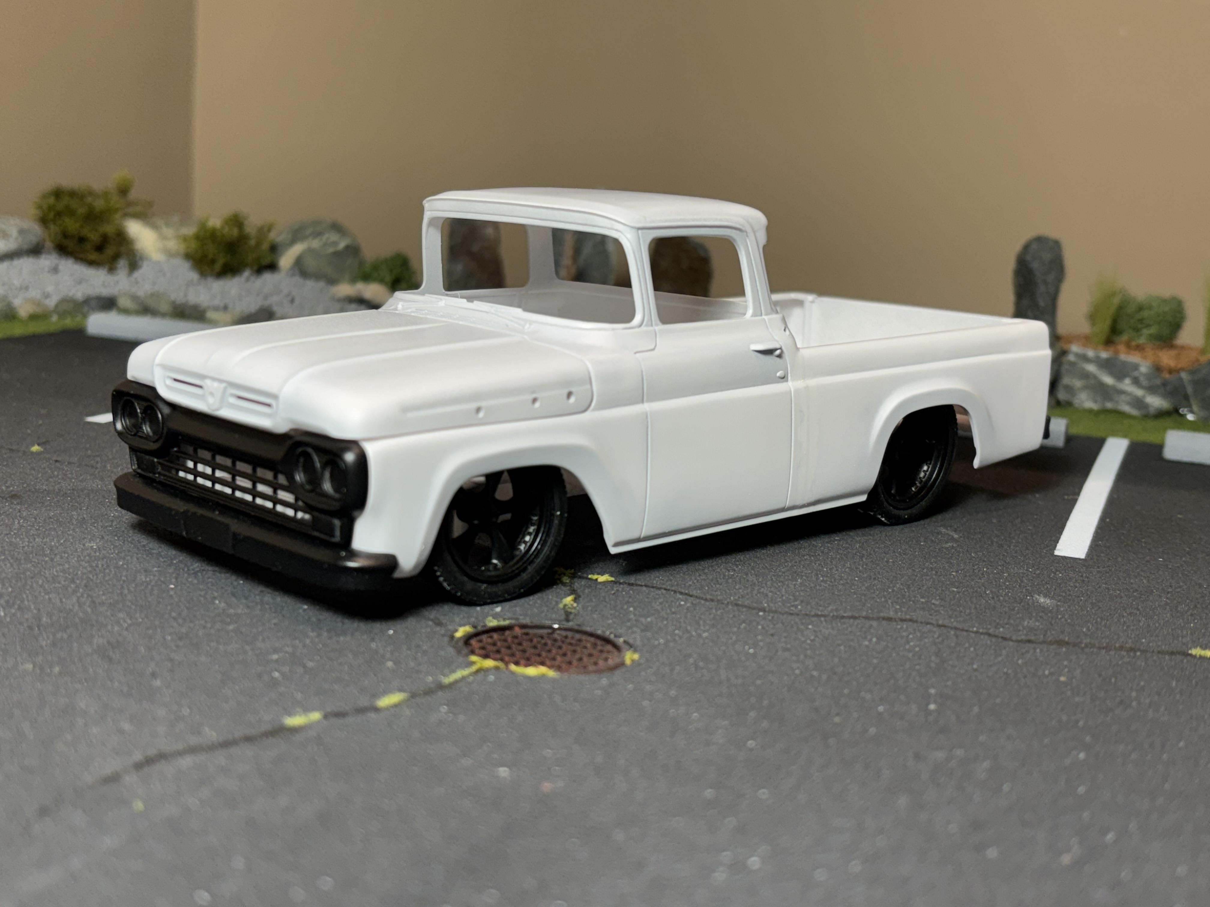

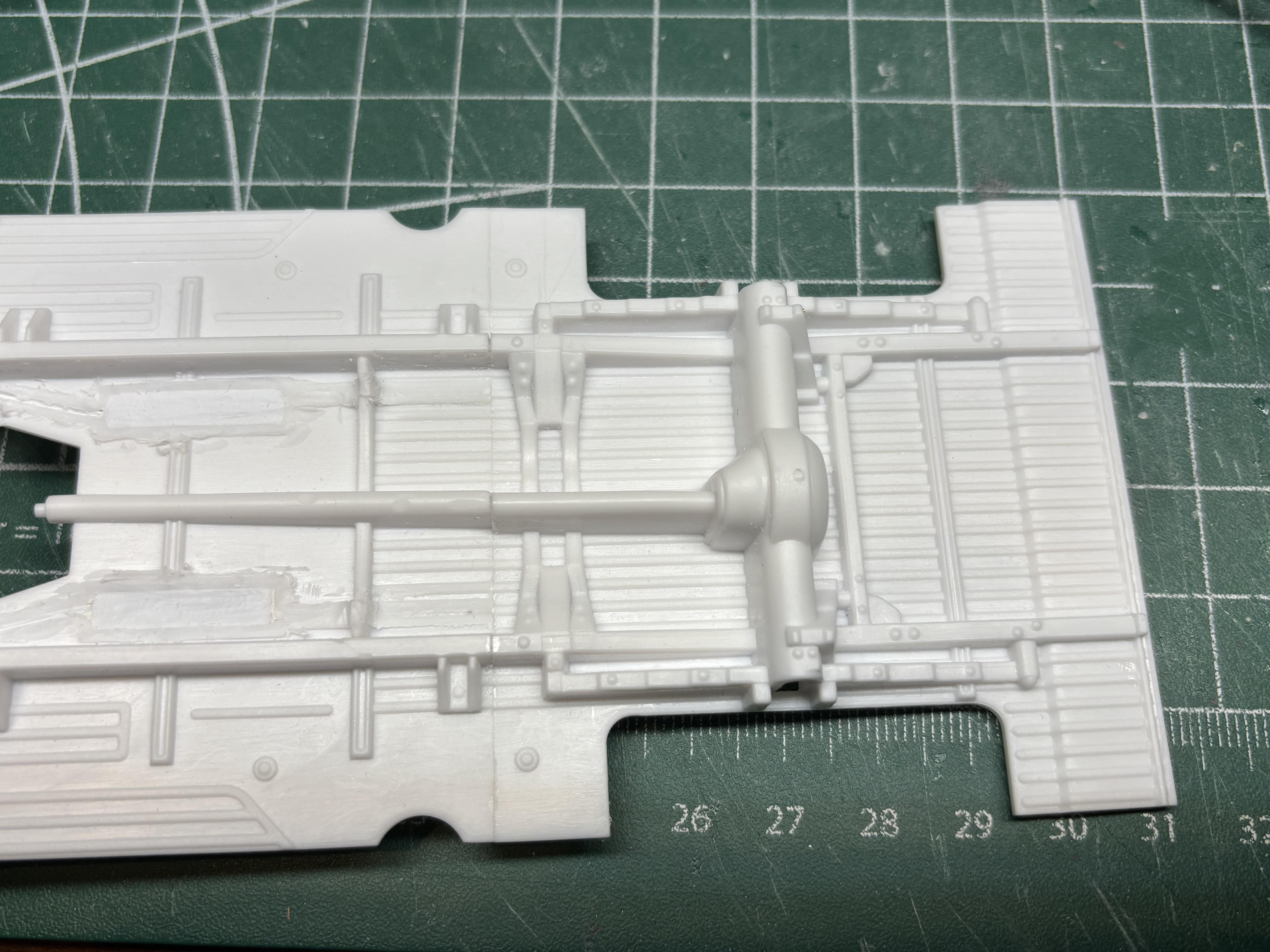

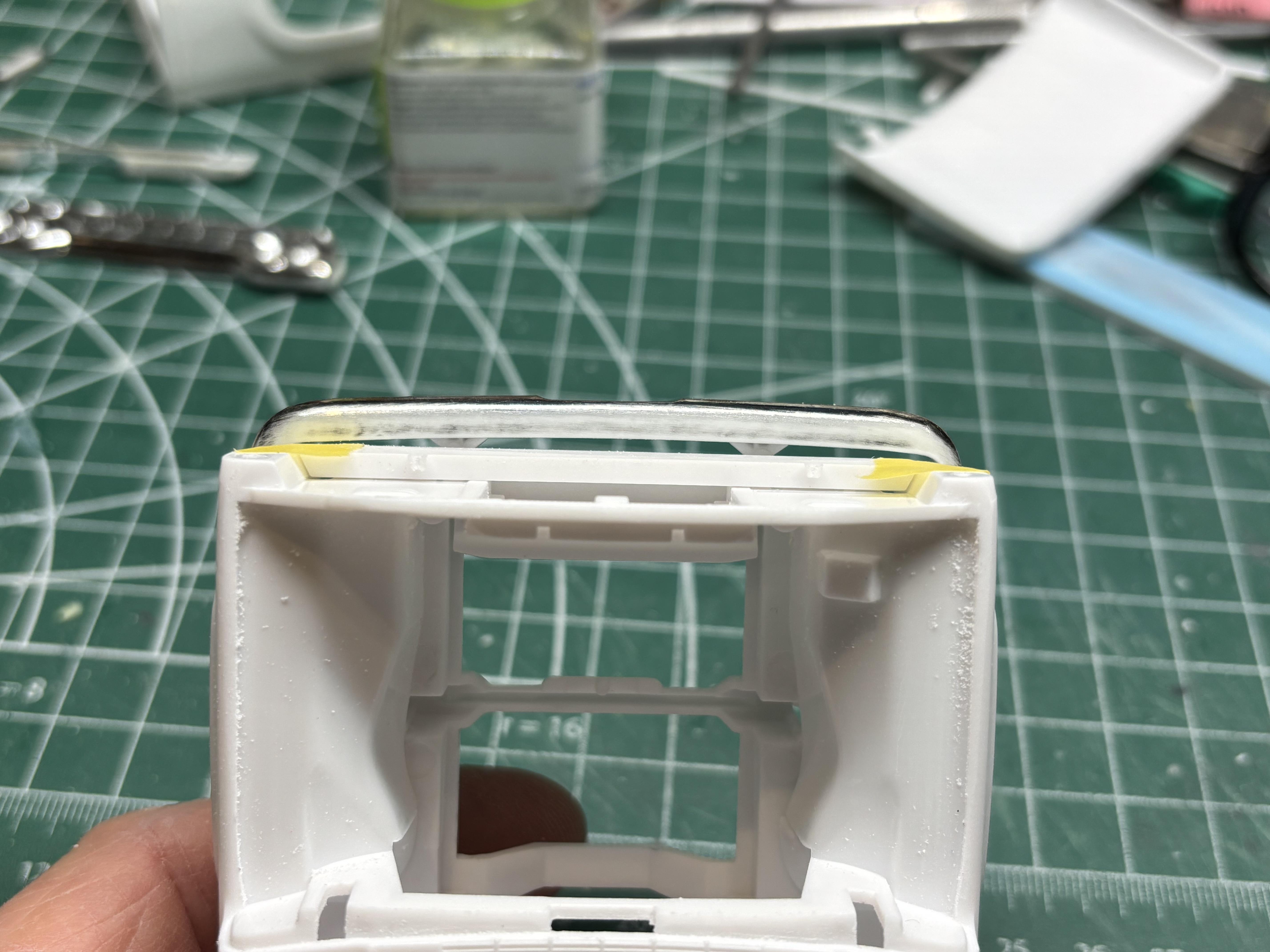

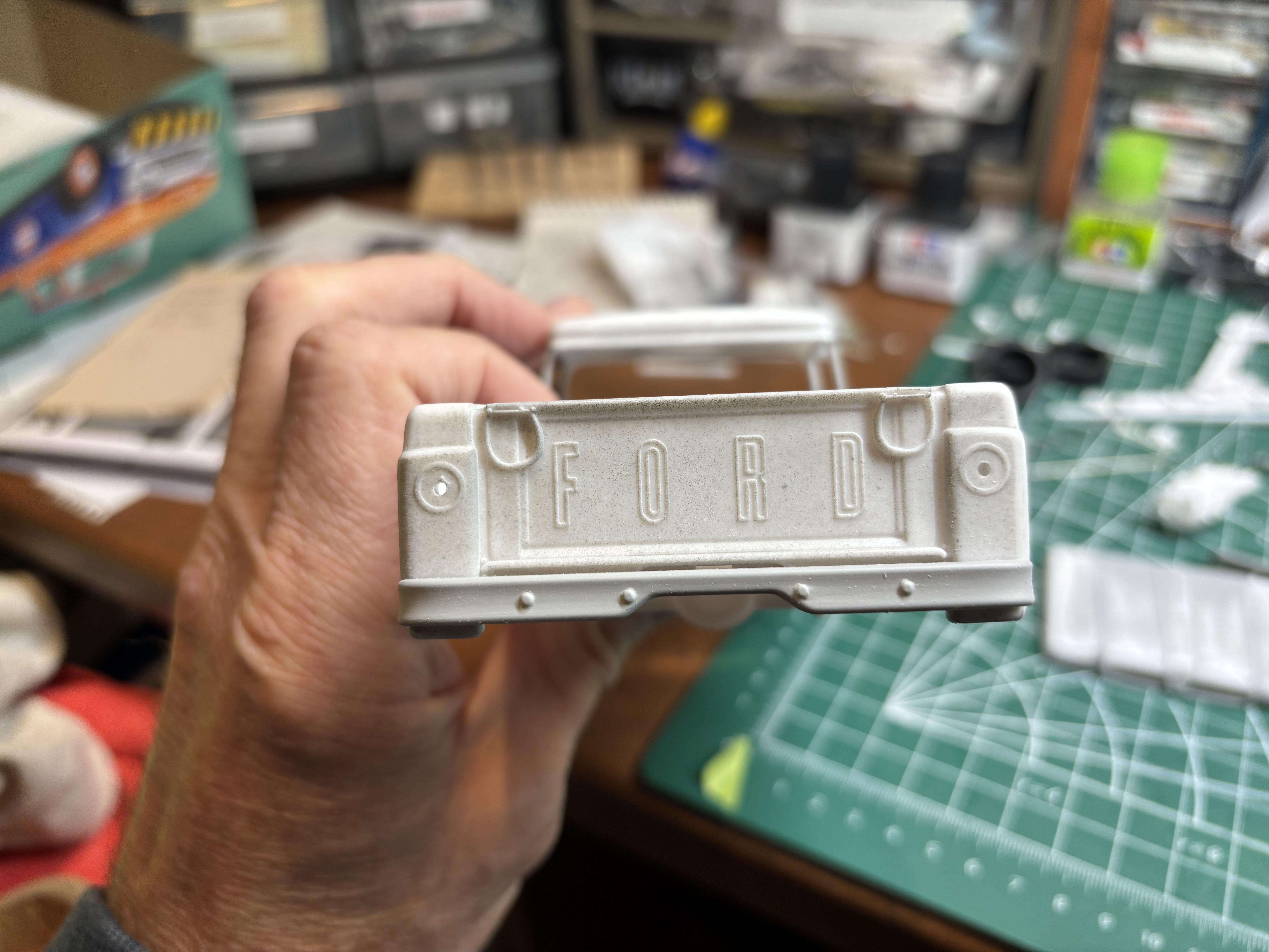

Rear bumper has also been tucked in about 2”. I am also flipping it upside down. This is something Roger was going to do on his, but went a different route. The license plate will hang below bumper, and I will relocate the mounting holes to get the bumper down about 2”. I have done A LOT… of sanding and filing on the chassis plate, the bed floor, and the underside of the body. I need this to sit low, yes that is obvious to anyone that follows my builds. So I have been nibbling, filing, and grinding away to get the body channeled over the chassis. I went with 3” in scale, (3mm) to get the look I wanted. I also wanted the bed floor to still fit the mounting points on the chassis. So after a whole bunch of super boring stuff, that really wasn’t worth showing, we get to the good stuff. Bumpers, grill, and wheels now painted. Body has 2 light coats of white primer, still a fair bit of sanding and finessing to do, but you get the idea. Ride height is VERY close to what I have in mind. MOCK TIME!! Thanks to all of you following along, I truly appreciate your interest and input. Don’t forget to, if you want to post a favourite build of Roger’s, post it!!

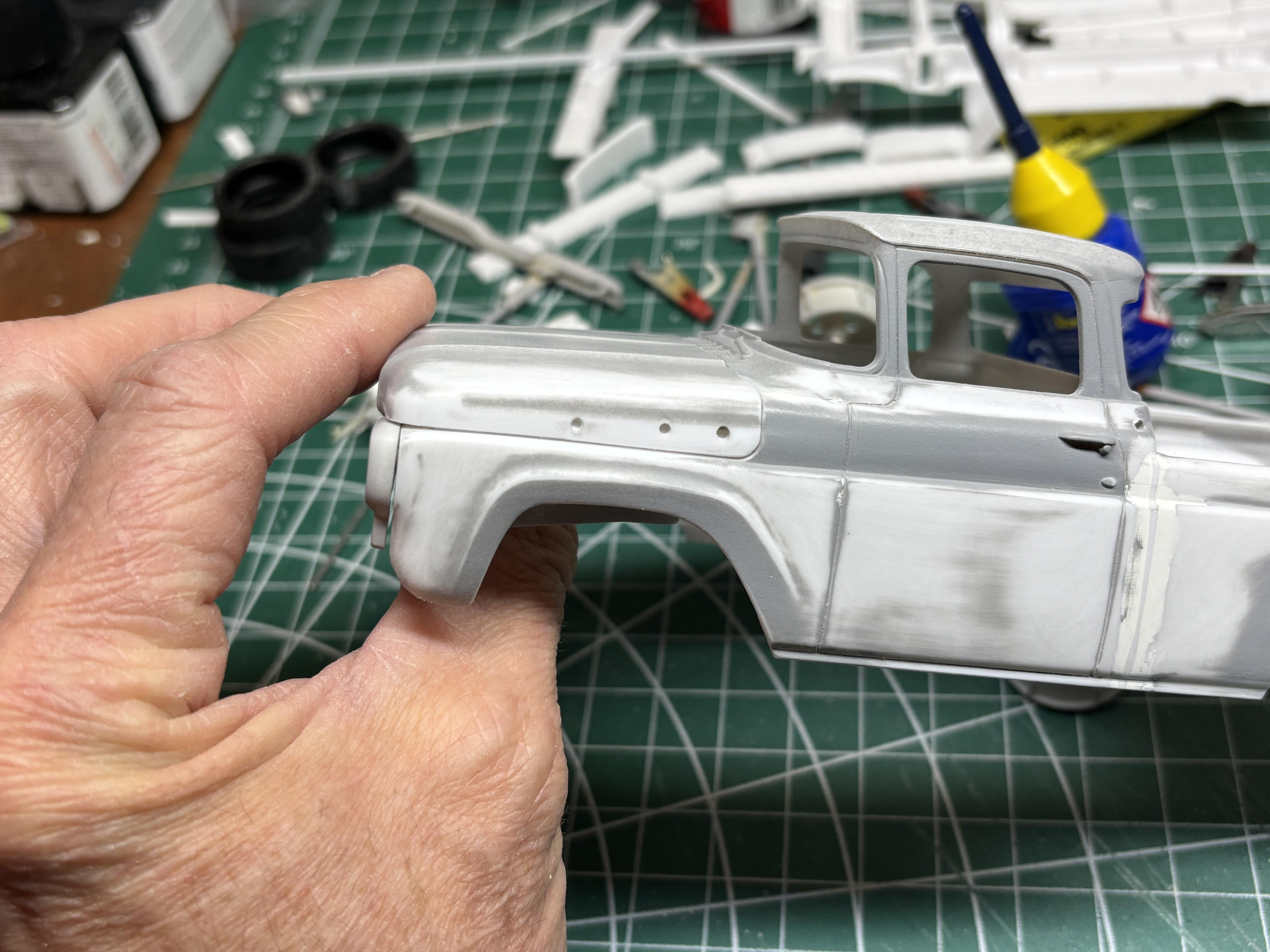

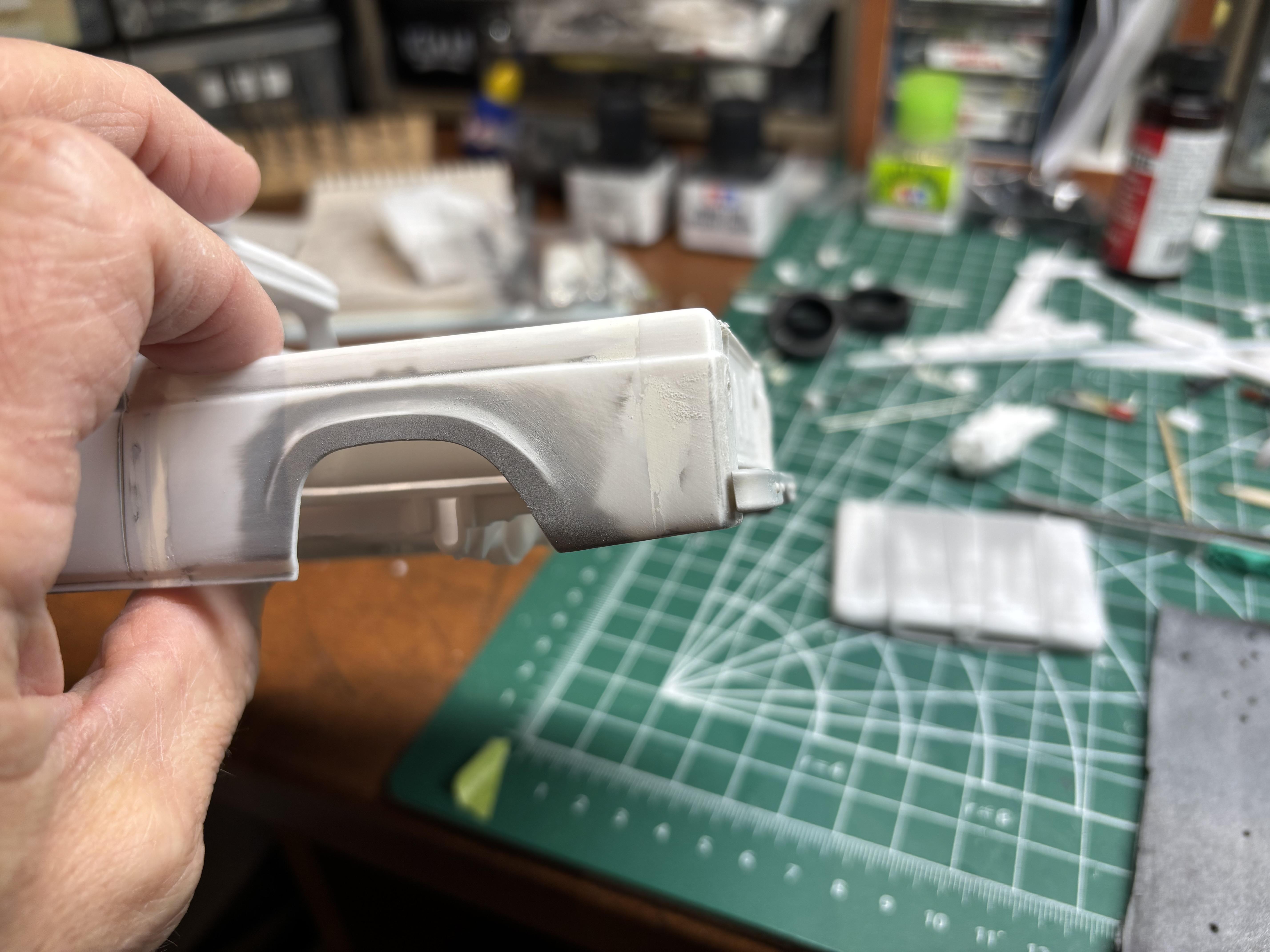

The front bumper was next. I wanted to “tuck it in a bit”. Shortened the front of the frame about 2 1/2 scale inches, and trimmed the inside of the fender to fit. Before… After… Chassis plate has been shortened and re-assembled. About 12 scale inches removed from wheelbase, and 10” from behind rear axle. I also ground off the molded exhaust. I will clean this mess up a bit of course. I’m probably going to end up removing the driveshaft too. Thanks for having a look.

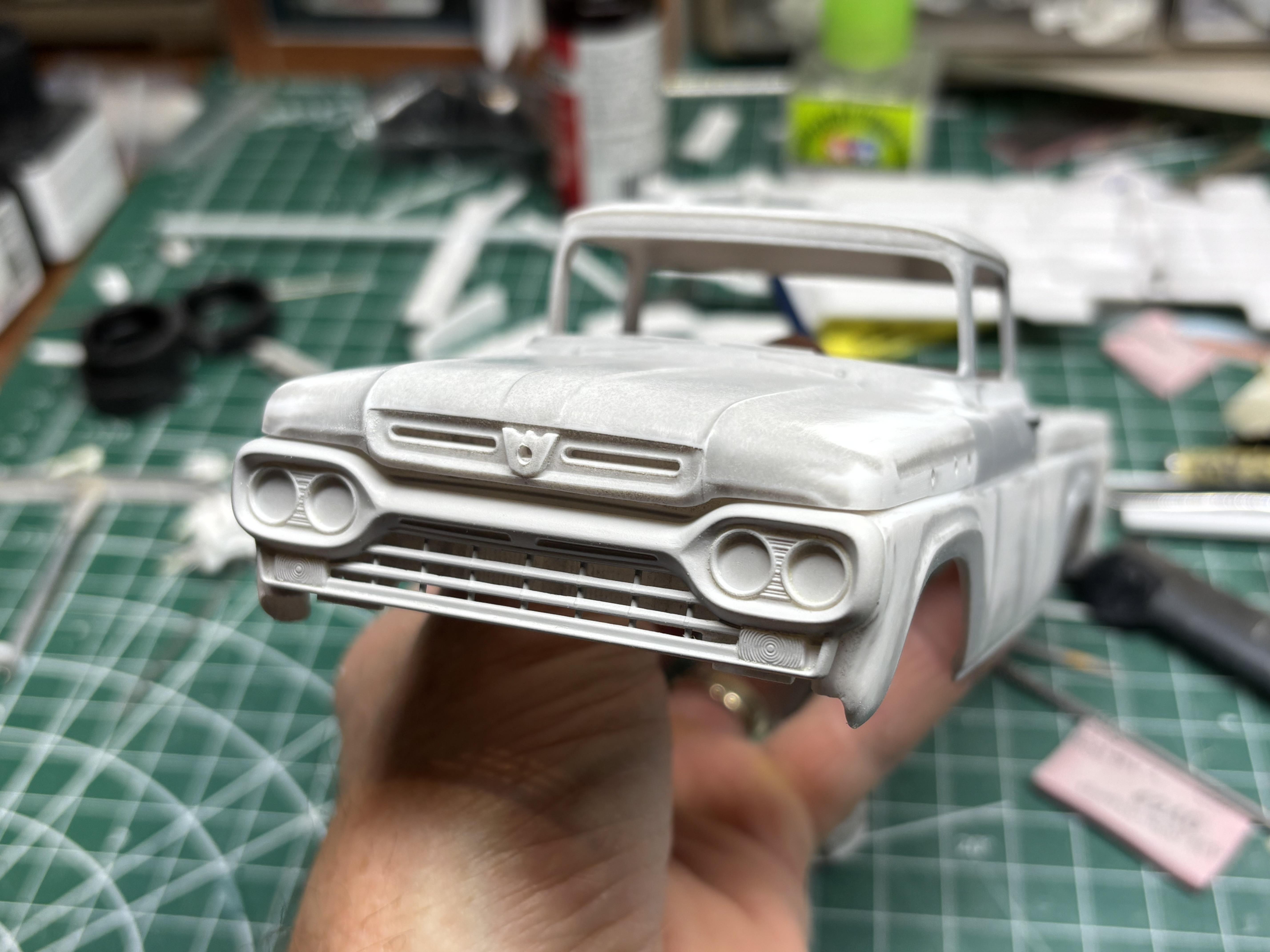

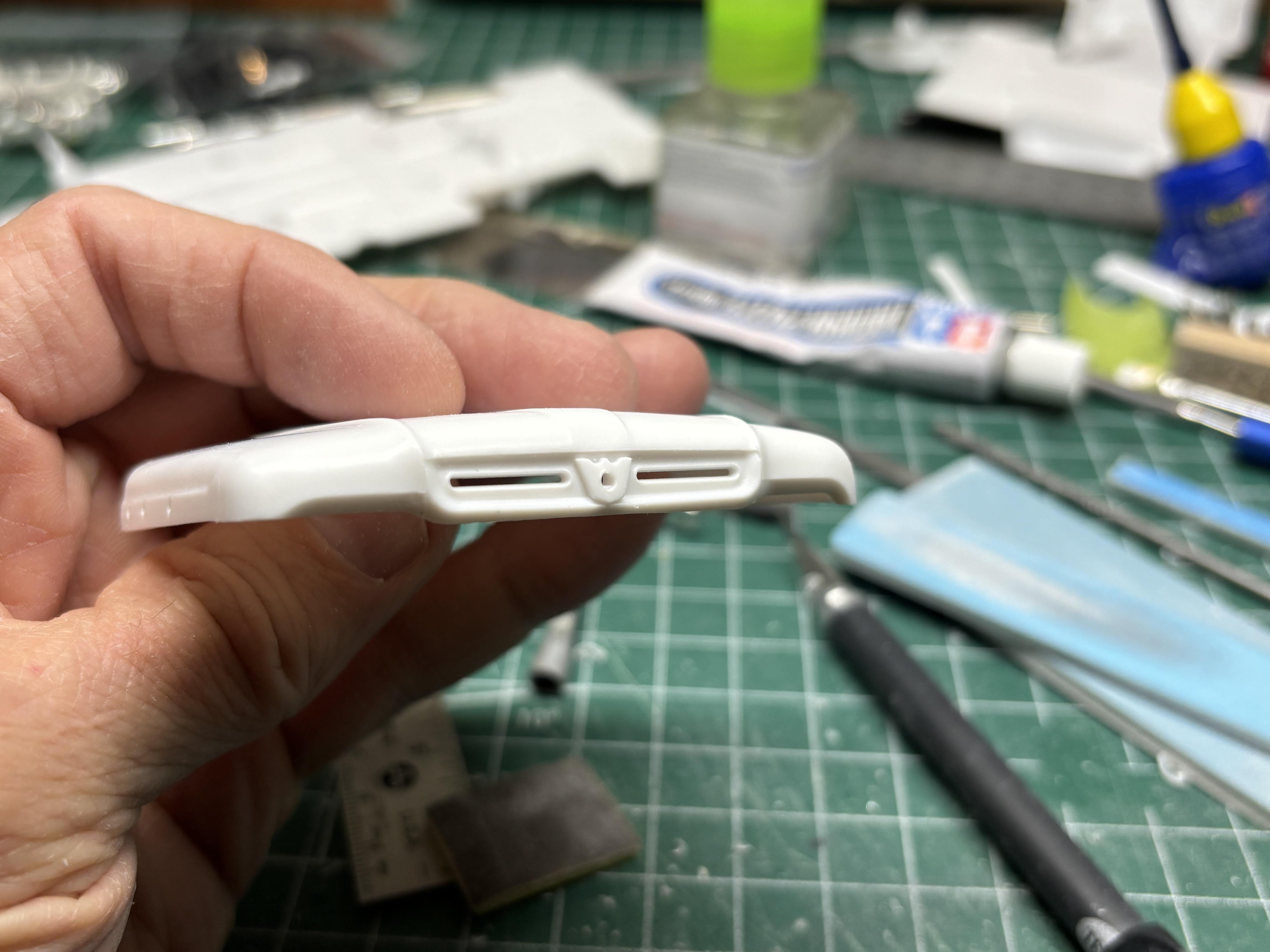

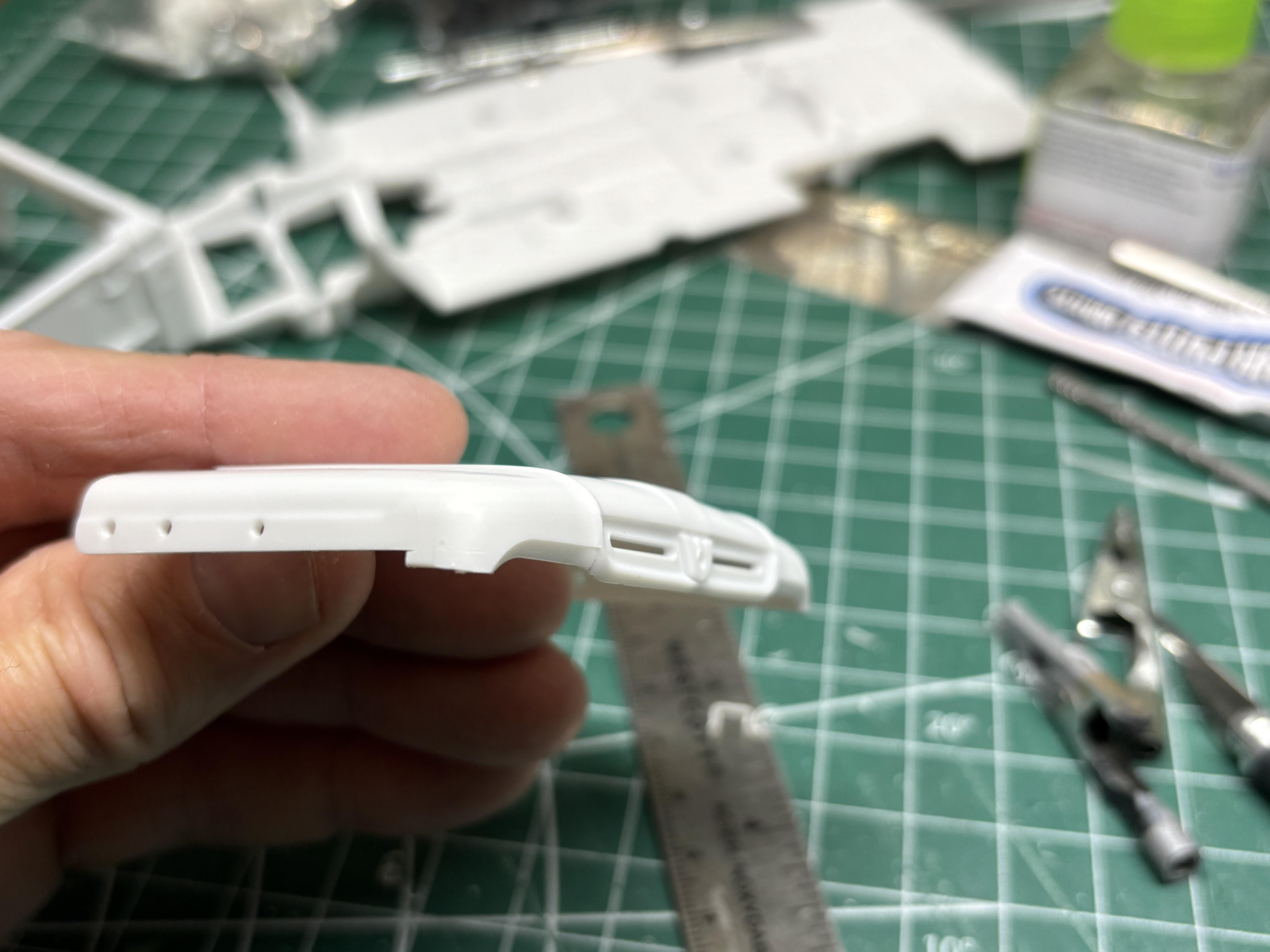

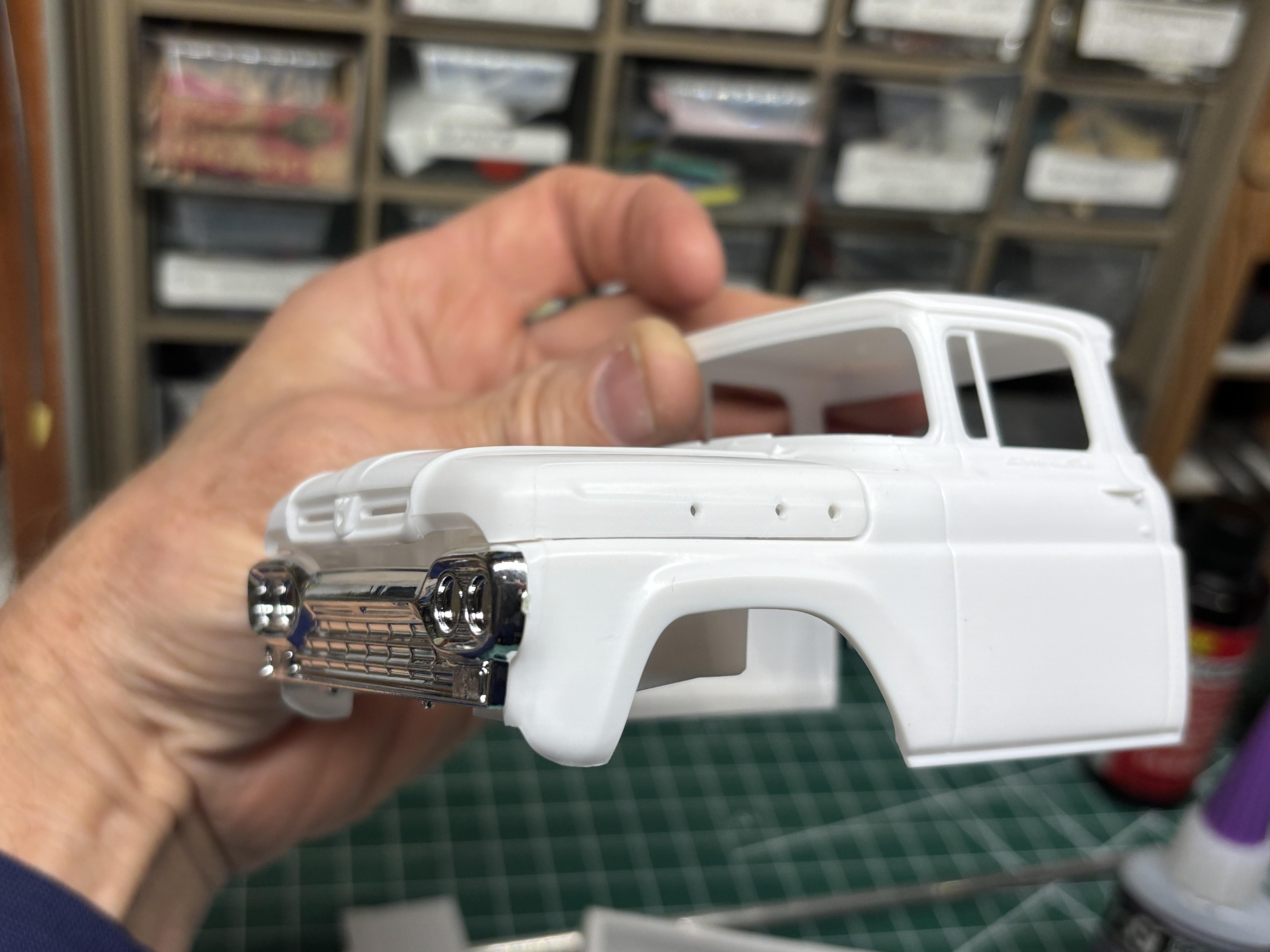

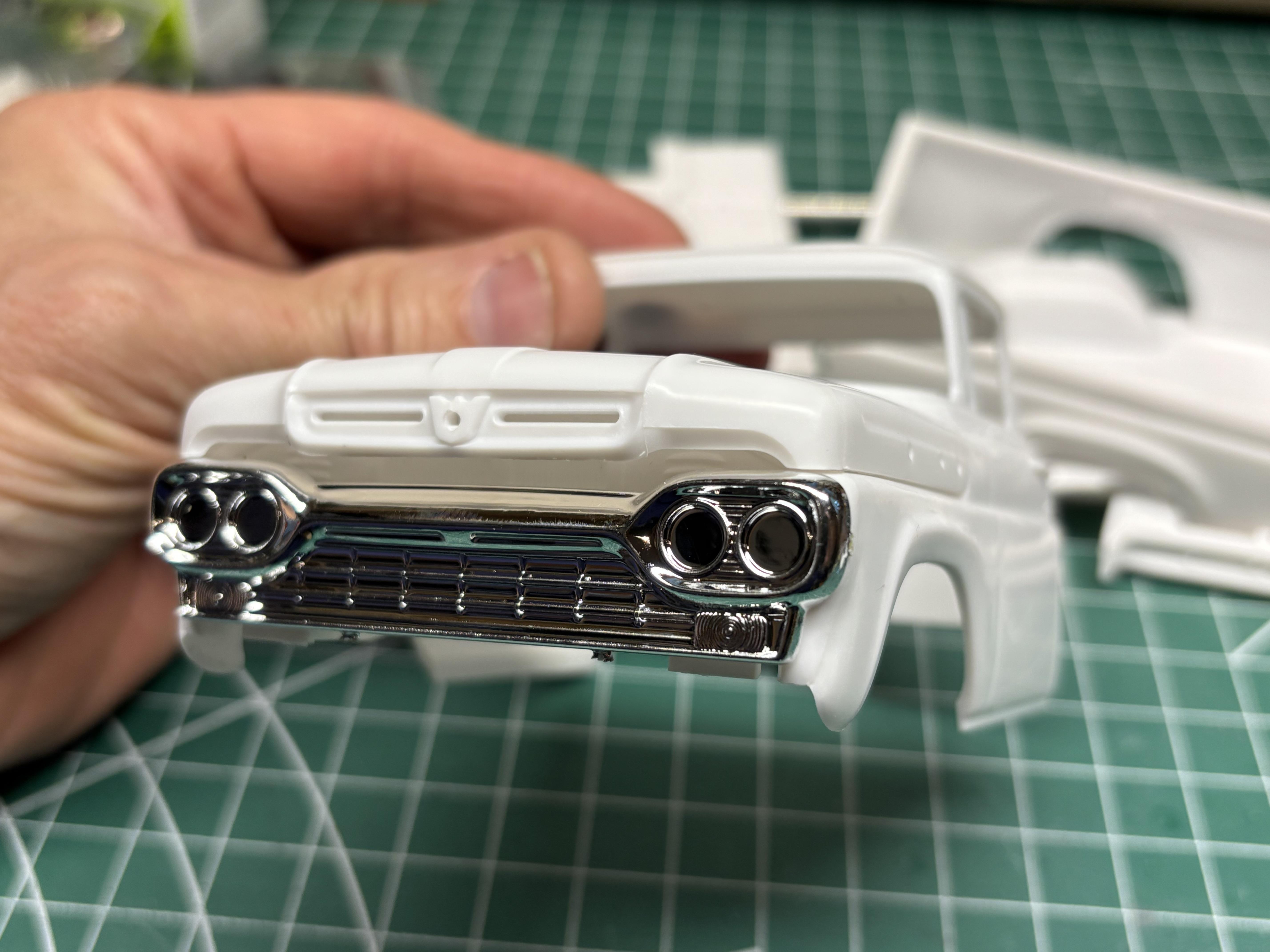

I mentioned in one of the first posts that there were few things that made me smile after my initial planning session, then looking at Roger’s threads. When I first sat down at the bench and plunked the hood and grill on it, I thought, “that doesn’t look right”. The hood looked too tall at the front, and didn’t really “fit” the grill. When I sat down later and did a deeper dive on Roger’s WIP, turns out he thought the EXACT same thing. I chuckled, and thought I must be on the right track. So some cutting and sanding later… The hood back on after mods… Still a little bit of fettling to do, but I think it looks wayyyy better.

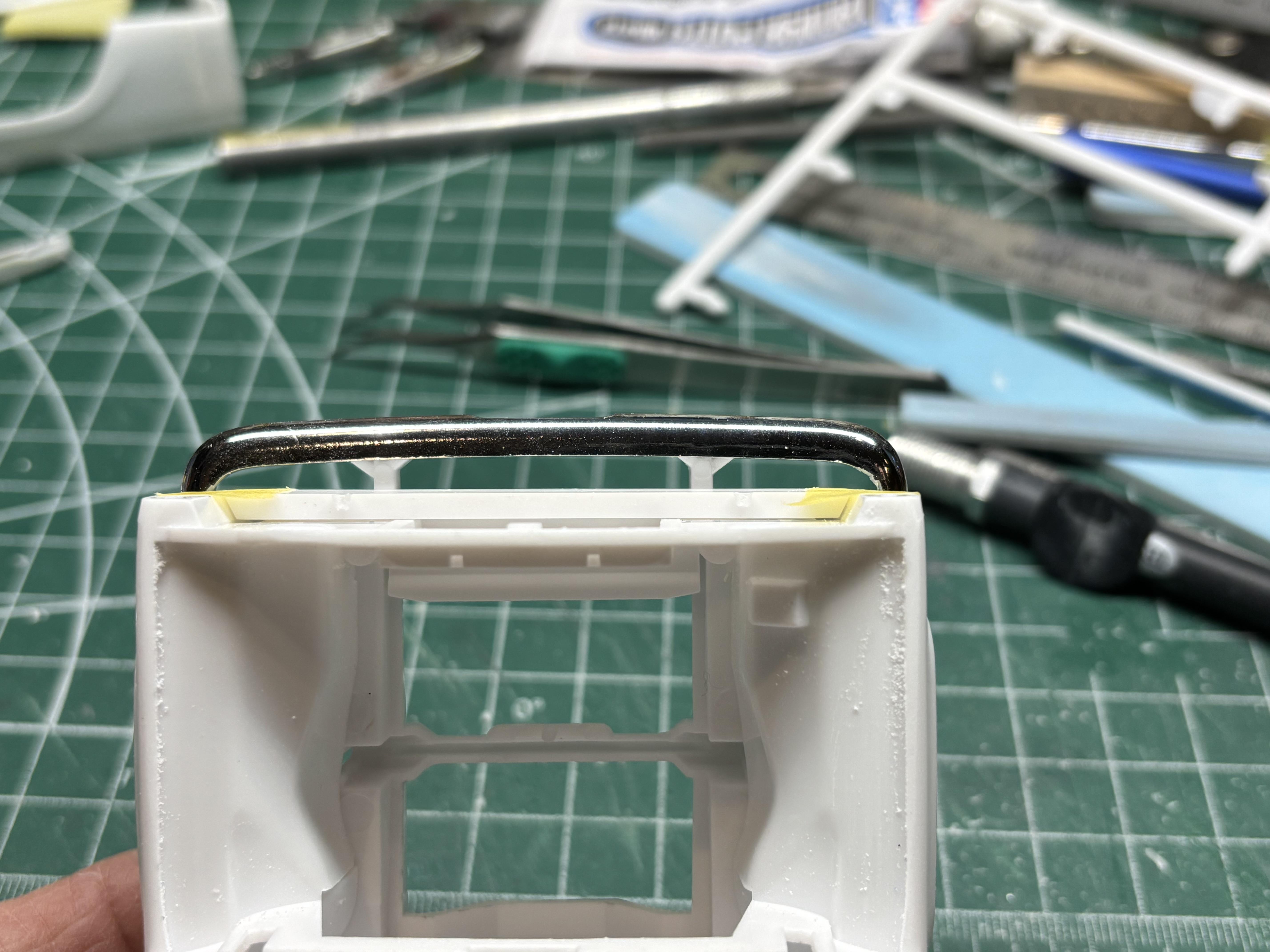

I have been picking away at this, and actually have a fair bit done, just not much to show just yet. However, we have a weather system coming for the next few days, so should have another update soon. For now, just a Quick Look at the grill. One of the things I’m trying to do on all my builds now, is “open” the grill. I sanded from behind, slowly, and carefully. The vertical bars are extremely thin, and unfortunately, well I’ll let the picture talk. I thought this might happen, so on to plan B. Remove the verticals, and clean things up a bit. Then add some new vertical bars. I will prime and tidy up as necessary. Hope to have something more meaningful soon.
