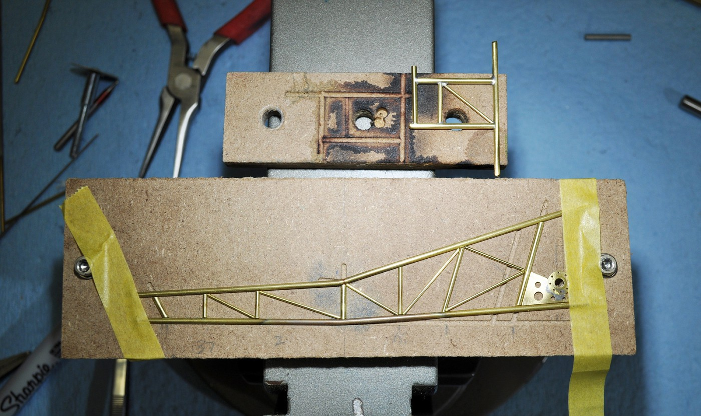

Dennis, thanks man! Mike, I'll do my best to answer your questions - I first drew up prints for the chassis with the specific dimensions and tube/rod sizes I would use. I used particle board (fine but cheap that I bought at Home Depot) that I set up on my mill. When you say "free hand" I'm not quite sure what you mean but to clarify I don't have or use a CNC machine. Old school. I did adjust for the various tube diameters so that the smallest bars would be centered properly. I couldn't have done this nearly as accurately if I hadn't done it this way IMO. I then used 1/16 ball mill to make the main frame rails and then a 3/64" ball mill for the next size and for the smallest bars (they're 1/32") I just laid them flat as needed in between the main rails/bars and soldered it all up. I spent quite a bit of time prepping it all to get it ready but the actual soldering was done in mere minutes and both sides turned out identical and solid. As an aside, a benefit was the very minimal clean-up doing it this way. Just a few minutes and they were done. The small piece of particle board (burnt) above the chassis piece was my experiment to validate that my method would work. Once it proofed out, I then machined the template piece for the chassis itself which is pictured right below it. Not everyone has the tools available to do it this way but if you do, it's a very effective way of making extremely accurate frame rails such as this. If I missed something please let me know and I'll try to answer them as best I can! Thanks too for the compliment.

Again, thanks for the chuckle Brad. I'll take pics with the wheels /wing on it and post over the weekend. I just have to detail the body yet. But for sure YEAH!! It's done. Bob, I know guys that get phenomenal joints using a soldering iron (Clay Kemp & Randy D. come to mind) But my experiment of machining grooves into particle board and laying various sized tubing in place (that way I didn't have to touch it and nothing moved AND most importantly both sides were EXACTLY the same). I put Tix flux at each joint all at once, placed a small sliver of Tix solder over top of the joint and then flame soldered the rails together. I use a Benzomatic mini torch. Granted, having a mill helps to do that but I had no re-work, nothing moved, great joints and almost non-existent clean up. For the other parts of the chassis I used my resistance soldering iron which I've gotten better at using with time and experience. Here's a pic of the particle board/chassis that I milled for the soldering operation. Thanks too for the compliment(s). Appreciated Chris!! I'm going to do a simpler build next before I jump back to the Pro Mod. A bit of a mental break if you will. Really keen to do a Pro Stock Maverick. I was able to pick up a sweet, totally complete kit from a gentlemen in the U.K. Great foundation for it. I've been checking out the forum and there is a ton of great info on the topic from others here. Nobody beats this site for knowledge when it comes to modelling IMO. Cheers !!

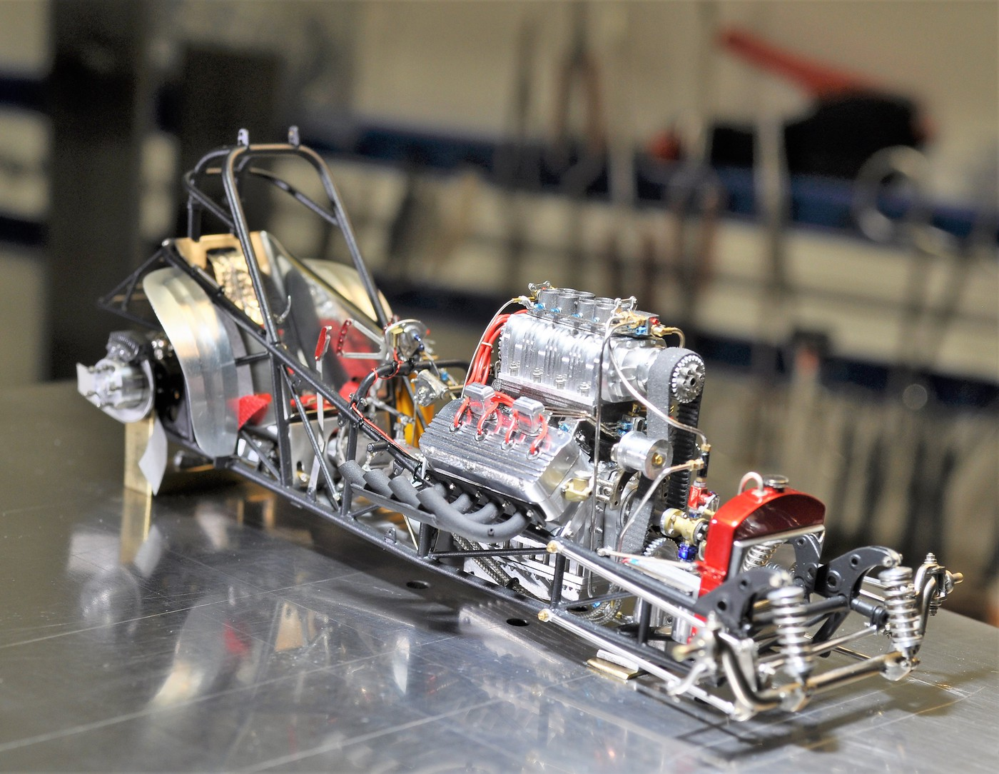

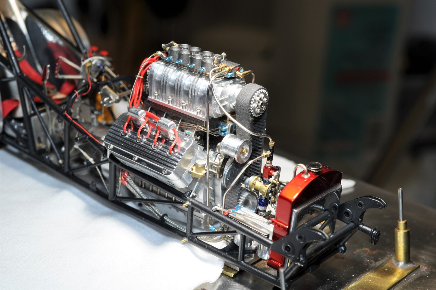

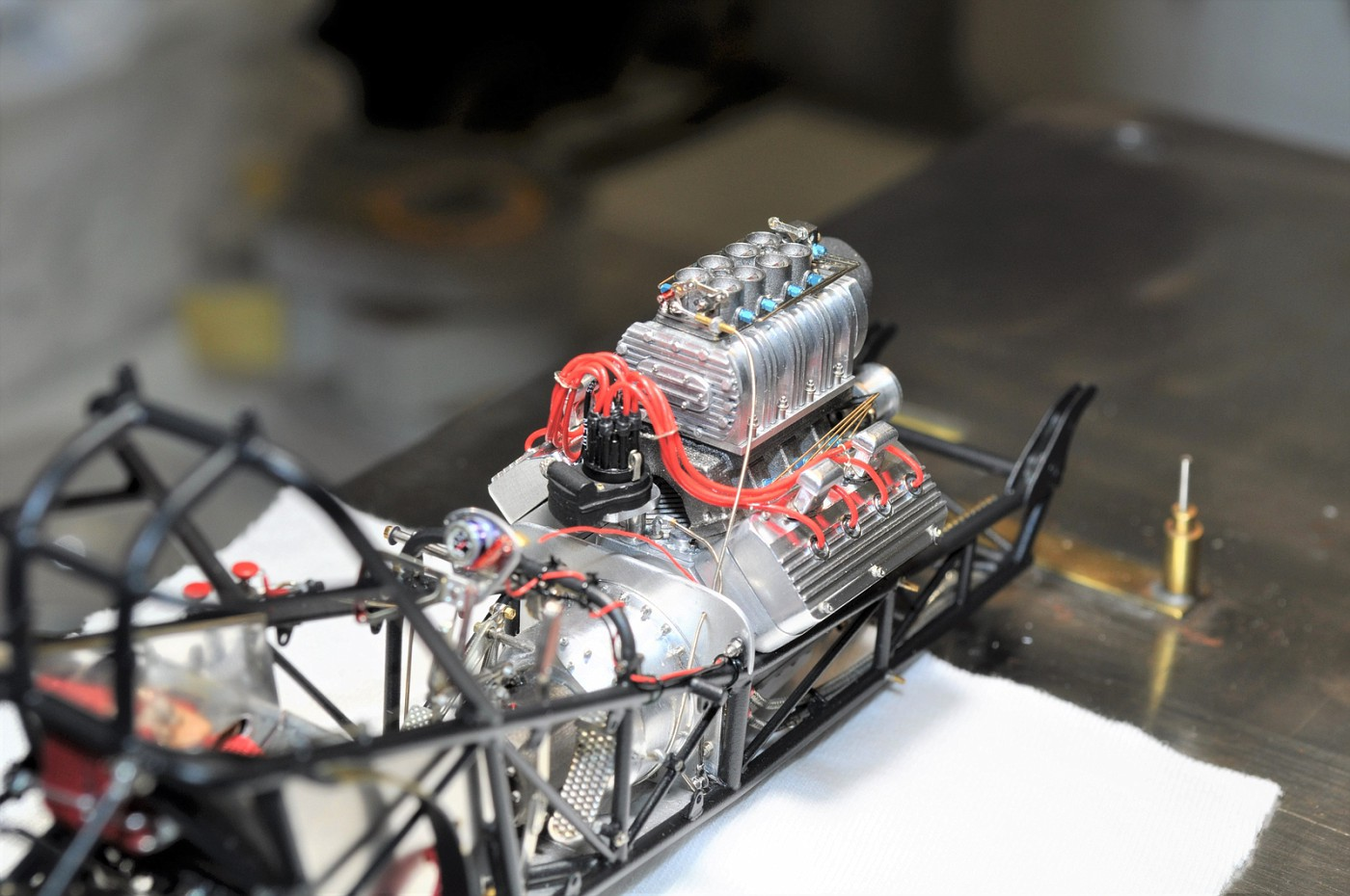

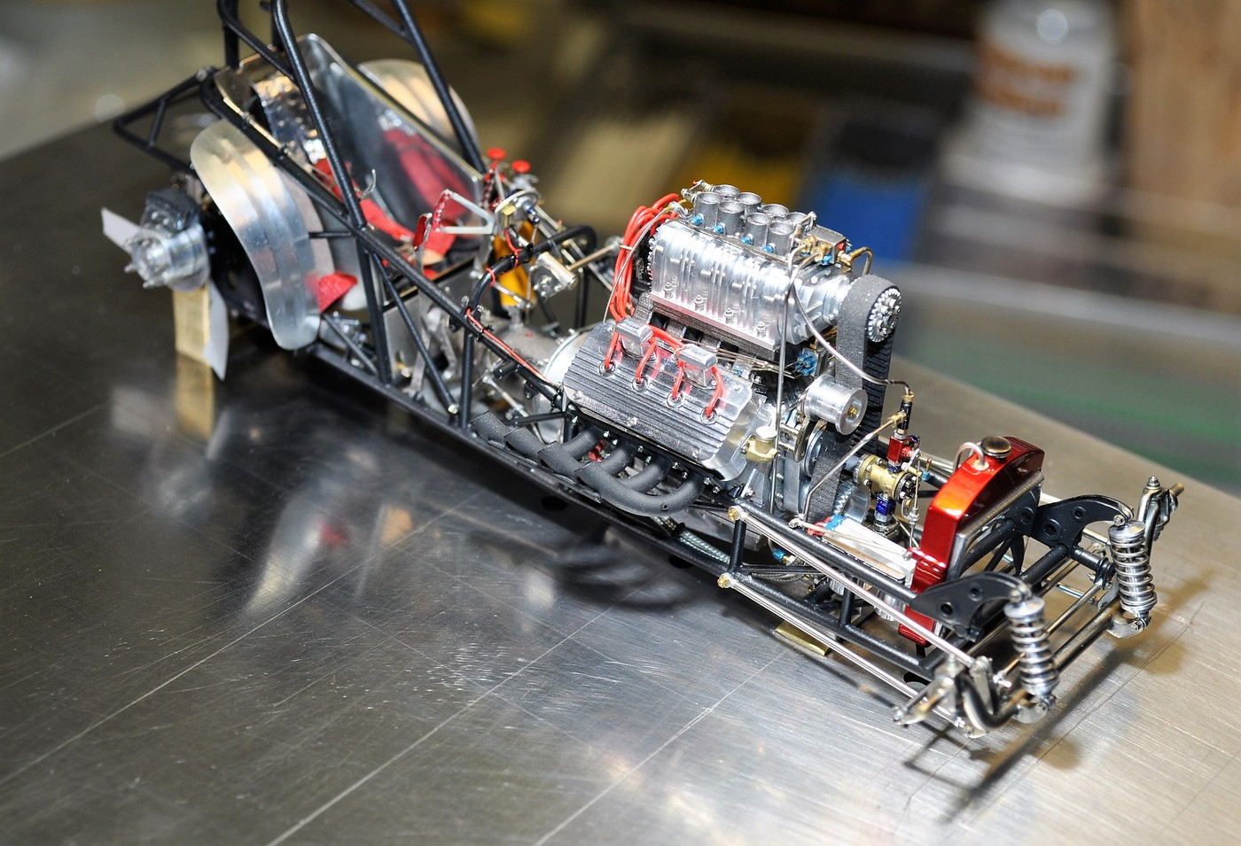

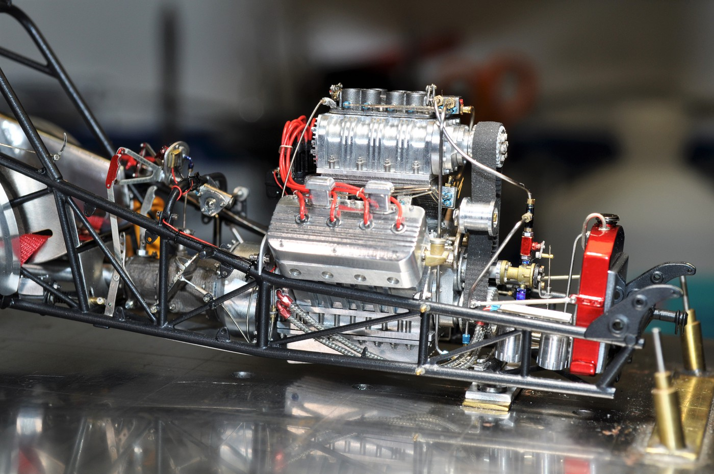

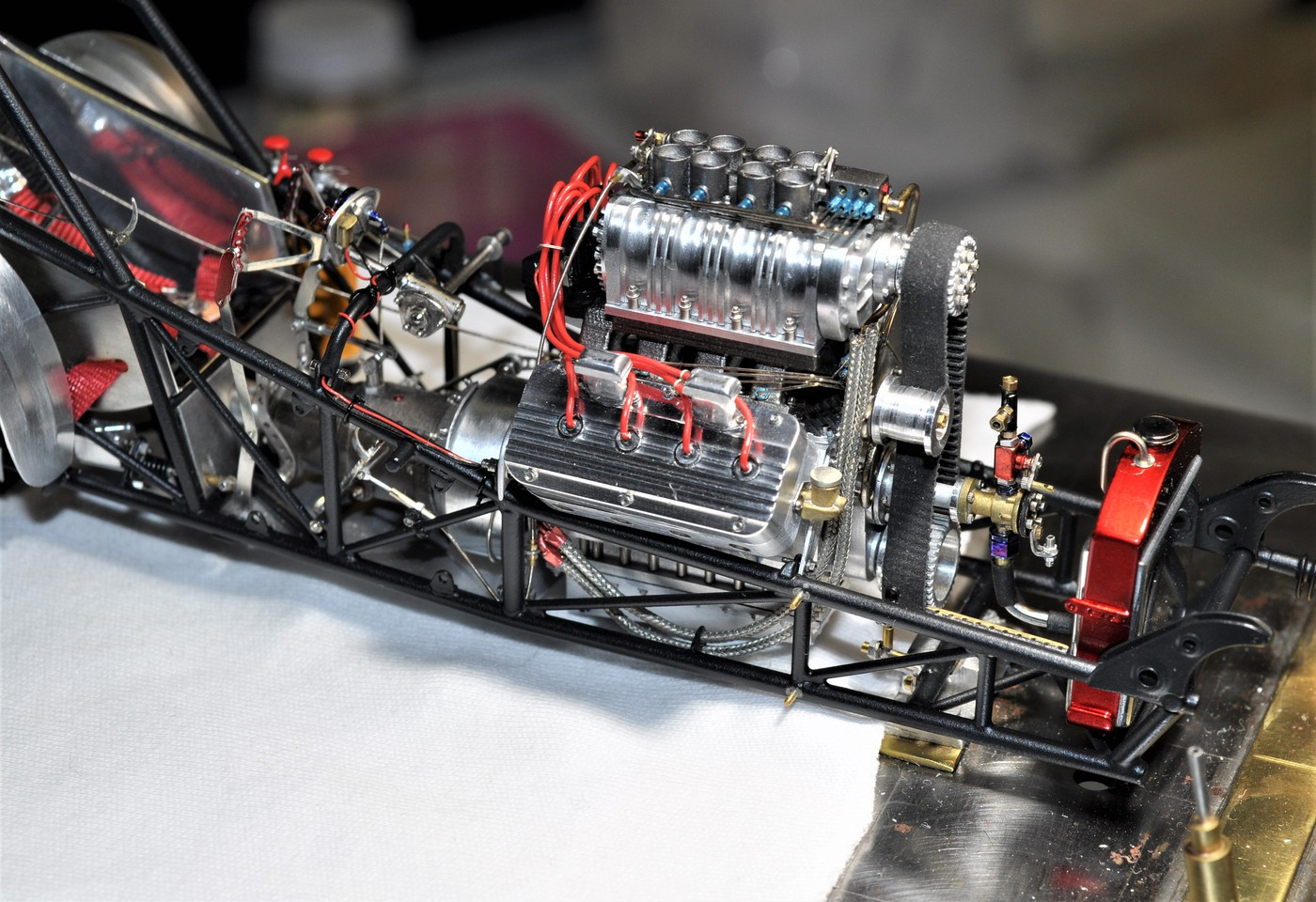

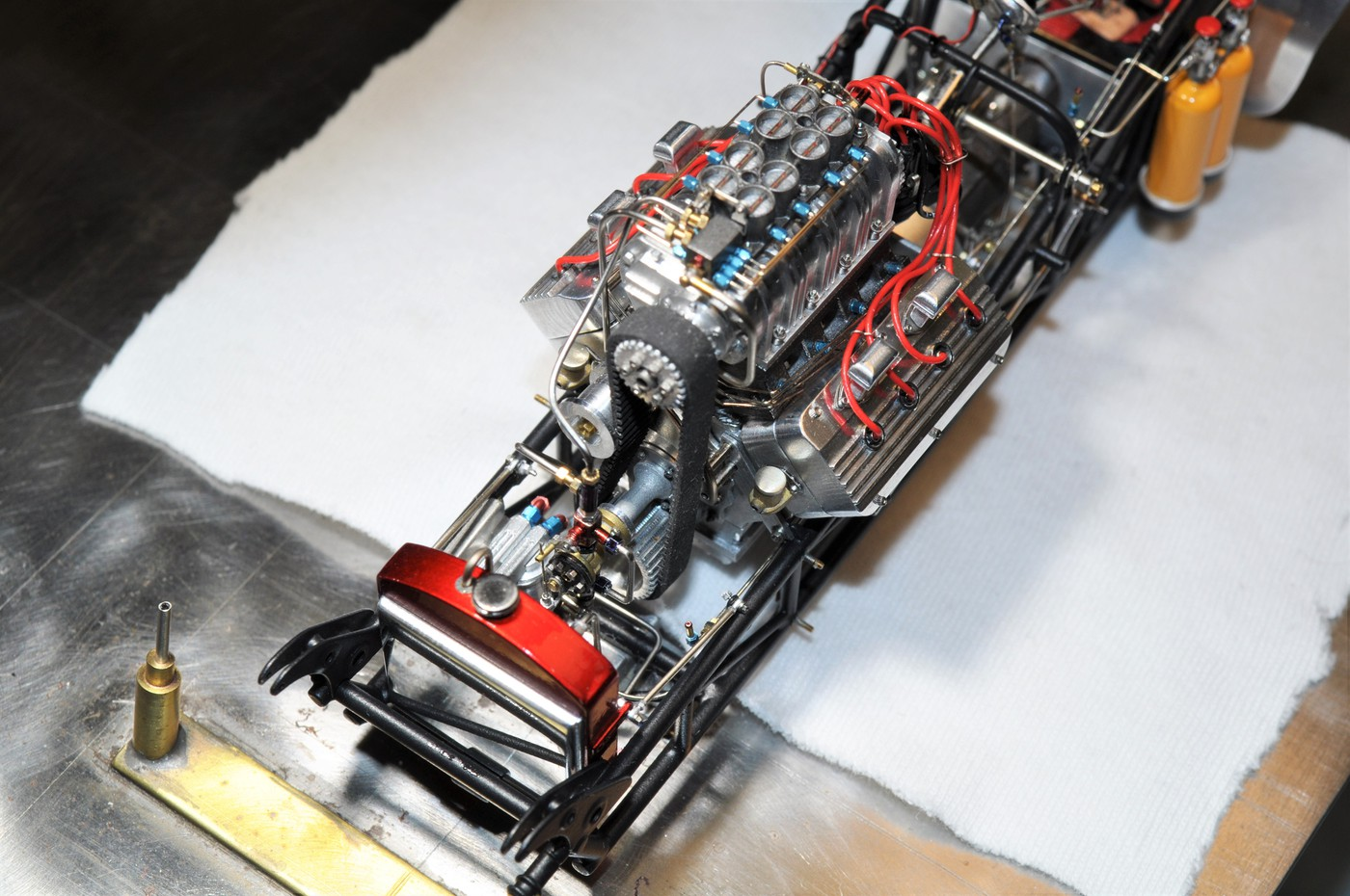

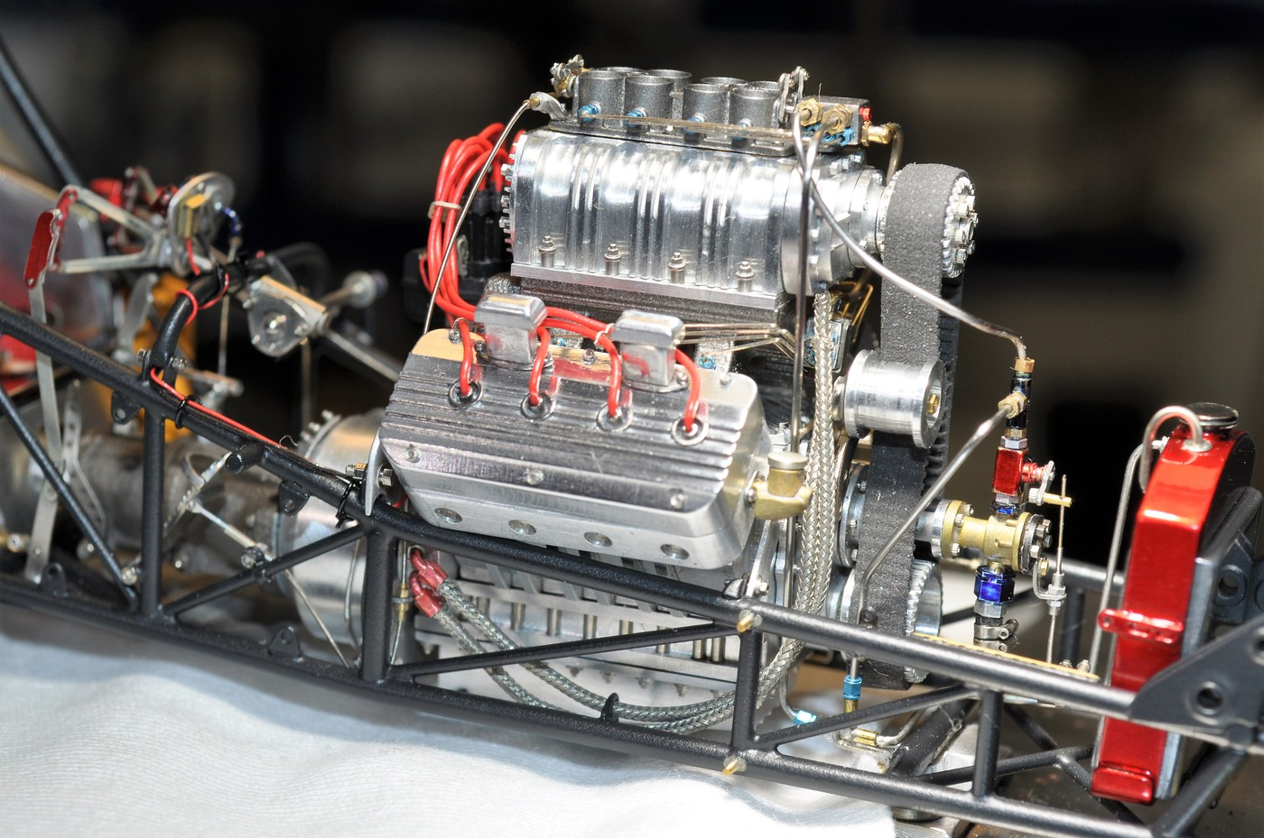

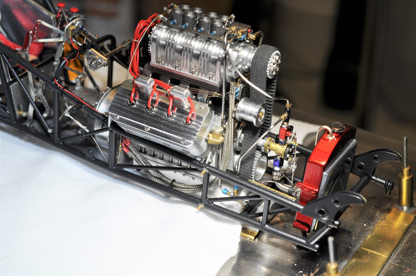

I'm embarrassed to admit that it took me about 6+ hours to just install the oil filters, their lines & fittings and finally the fuel tank braces. There is a pic included showing the chassis from above and it gives the best idea of how tight it truly is between the frame rails. Please remember, the entire chassis is about 6" in length. Only the front suspension & headers to install and the entire chassis will be complete. Only the tins & bracing to install on the body and this build will be complete. Oh so close. Cheers one and all, tim This is the pic I referenced above...... This pic shows the oil filters and lines...........
