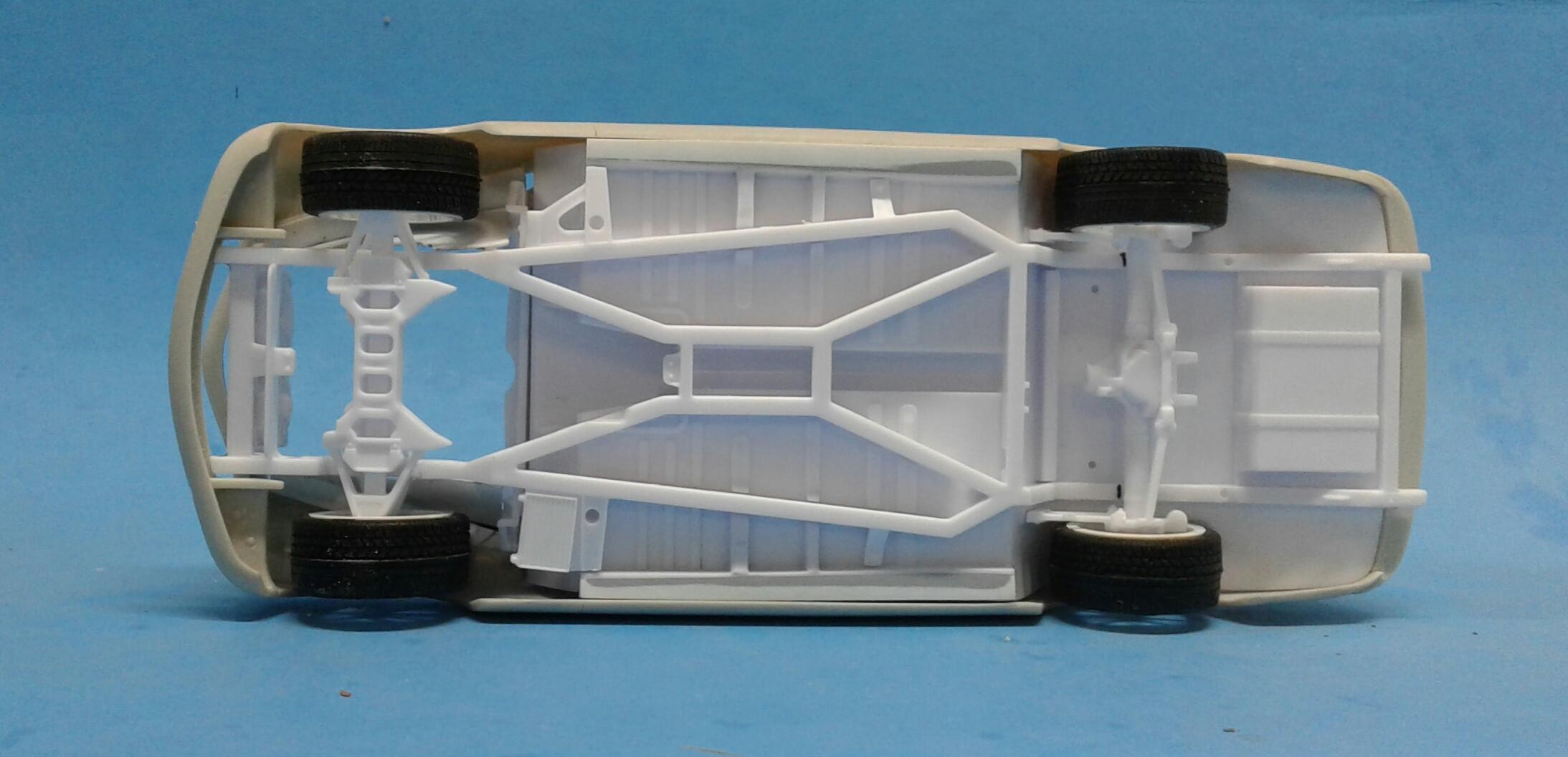

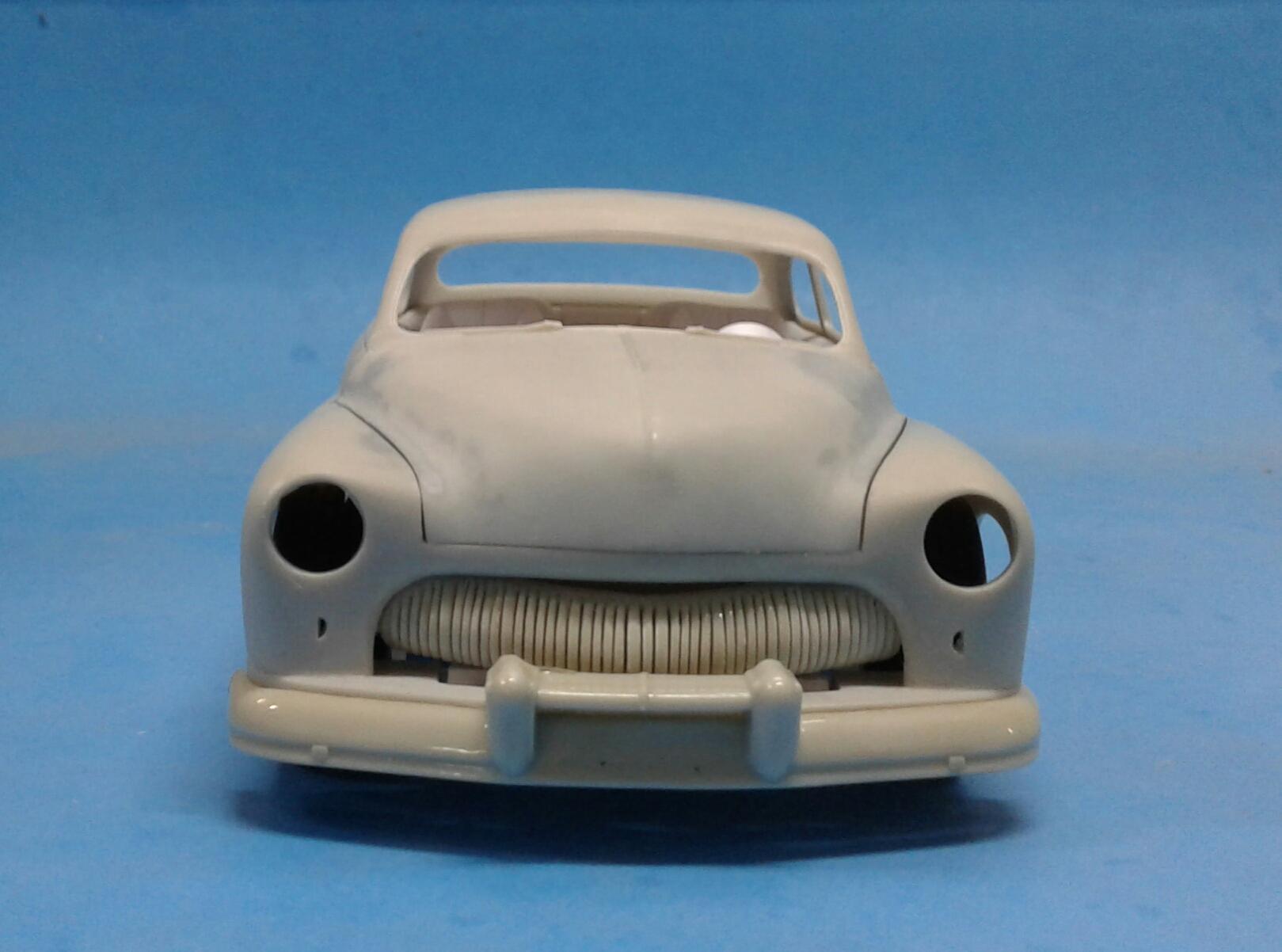

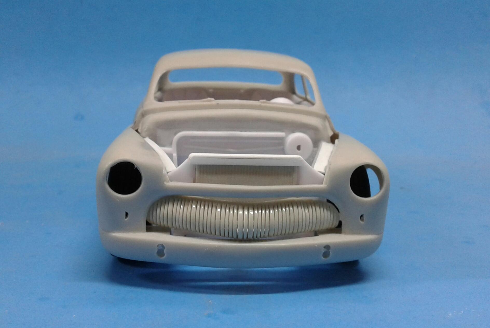

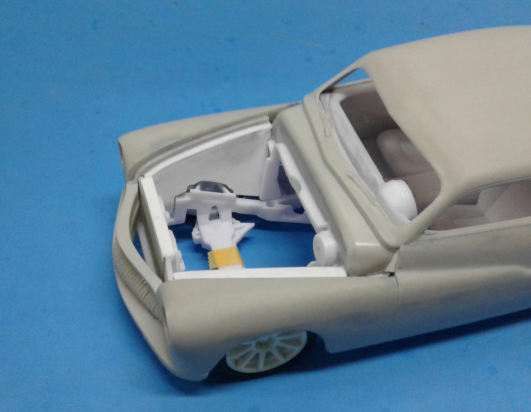

Plowboy Posted January 5, 2021 Author Share Posted January 5, 2021 Thanx for the feedback guys! Right now, I'm leaning more towards leaving the bumper guards. I lowered the front bumper down by simply drilling new locating holes in the splash pan. Now, the guards aren't as intrusive as before and the bumper hides the splash pan at the bottom. I want to see it in paint before I decide to omit the guards. The grille is all wonky in this photo. Here's a better photo with the grille placed better. As you can see, the grille is now opened. This took a good while to accomplish! Around five minutes per slot and there's 46 or 48 of them! The radiator and support are from the Caddy. I had to add the radiator detail to the front using the one from the Mercury. The floor pan and frame are completely fitted. I'm real happy with how they now fit. It just falls together! Dash is fitted and inner fenderwells added. I still need to add some strengthening ribs to them. I added the firewall detail from the Caddy. I'm going to whittle down that huge flange. Engine is finally fitted. Still have to check for headers clearance. I figured there would be an issue with the breather. But, no problem! I may still lower it down a bit as it looks too high IMO. The package tray is now added to the interior. The interior is now completely fitted and ready for primer. I still have to make the hinges for the trunk and get a final fitment on it. I got enough of the rearend put together so that I can see exactly how the stance is going to be. I like it! It has just a touch of rake. Almost unnoticeable. The frame barely peeks below the rockers. I wish it didn’t show at all. But, I can live with it. I should have the hard stuff done. I'm ready for the fun stuff! Quote Link to comment Share on other sites More sharing options...

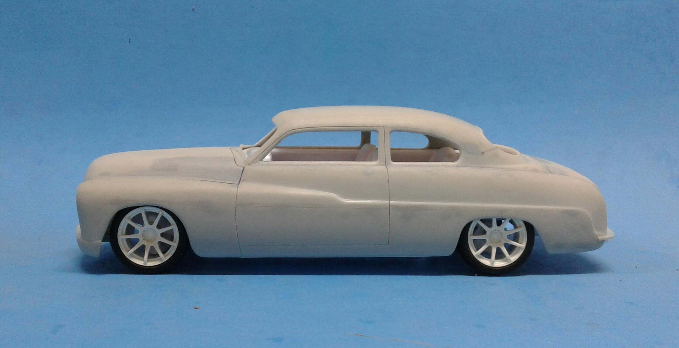

Plowboy Posted January 6, 2021 Author Share Posted January 6, 2021 Thanx guys! Before I got too carried away, I figured that I better check all of the clearances on the engine. So, I installed everything with Elmer's glue and set it back in the frame. That thing really fills up the engine bay! Everything was good except for the alternator. I twisted it over and got the clearance. But, I don't like how it looks and it will be a PIA to make brackets for it. I'm either going to have to rework this setup or find a different belt and pulley setup. I may just lower the engine a little. I have plenty of clearance at the front. One thing that is bugging me about this model more and more is the relation of the wheels to the wheel openings. When I did the section on the body, the wheel openings got raised the same amount. I think that was a mistake. The wheels aren't tucked up like I would like them to be. Even though it sets fairly low, it doesn’t look low. I think I'll lower the wheel openings a couple of mms and see if that helps. If I don't like it, I can simply cut them back out. But, I think it will visually lower it without actually lowering it. We'll see. Quote Link to comment Share on other sites More sharing options...
espo Posted January 6, 2021 Share Posted January 6, 2021 I really like the way you have massaged to body on this. The Chopped Top especially since it gives the overall body shape a much more modern look to my eye anyway. You mention the front wheel openings being to high up into the fender. I think that if you start covering the front wheels it might start looking like a car on air and it's aired down. or at rest. You could spray some paper with the same grey primer and cutout the wheel well opening shape. Then move it around on the side of the body before any body surgery. Quote Link to comment Share on other sites More sharing options...

misterNNL Posted January 6, 2021 Share Posted January 6, 2021 IMHO the only detractor of this project is the "toothy" look of the grille. Maybe it's the photo angle, looks out of kilter to my old eyes. Quote Link to comment Share on other sites More sharing options...
Plowboy Posted January 6, 2021 Author Share Posted January 6, 2021 6 hours ago, espo said: I really like the way you have massaged to body on this. The Chopped Top especially since it gives the overall body shape a much more modern look to my eye anyway. You mention the front wheel openings being to high up into the fender. I think that if you start covering the front wheels it might start looking like a car on air and it's aired down. or at rest. You could spray some paper with the same grey primer and cutout the wheel well opening shape. Then move it around on the side of the body before any body surgery. Thanx David! I already filled them back in and it made a huge difference in the looks of it! When I get it kinda smoothed back out, I'll post a photo. Quote Link to comment Share on other sites More sharing options...

Plowboy Posted January 6, 2021 Author Share Posted January 6, 2021 2 hours ago, misterNNL said: IMHO the only detractor of this project is the "toothy" look of the grille. Maybe it's the photo angle, looks out of kilter to my old eyes. That's because it isn't glued in. The front wants to drop down because of the shape of it. Quote Link to comment Share on other sites More sharing options...
misterNNL Posted January 6, 2021 Share Posted January 6, 2021 1 hour ago, Plowboy said: That's because it isn't glued in. The front wants to drop down because of the shape of it. I figured it was something like that. Your surgical approach tp the custom work is refreshing to watch. Quote Link to comment Share on other sites More sharing options...

Plowboy Posted January 7, 2021 Author Share Posted January 7, 2021 I got the wheel wells filled and roughed in. The difference is dramatic! Now, it looks low! Quote Link to comment Share on other sites More sharing options...

Kit Karson Posted January 7, 2021 Share Posted January 7, 2021 11 hours ago, Plowboy said: I got the wheel wells filled and roughed in. The difference is dramatic! Now, it looks low! Buddy, I take a minute away and you make massive changes come to life! All I can say is: Quote Link to comment Share on other sites More sharing options...

gotnitro? Posted January 7, 2021 Share Posted January 7, 2021 Now thats a cool change! Wasn't sure it needed the wheel well mod , but as usual wrong again Nice work Quote Link to comment Share on other sites More sharing options...
Koellefornia Kid Posted January 7, 2021 Share Posted January 7, 2021 Great stance now! Nice! Quote Link to comment Share on other sites More sharing options...
slusher Posted January 7, 2021 Share Posted January 7, 2021 3 hours ago, Koellefornia Kid said: Great stance now! Nice! I totally agree! Quote Link to comment Share on other sites More sharing options...
Dave72 Posted January 8, 2021 Share Posted January 8, 2021 Looking great! The added material to the wheel wells did the trick. IMHO, the motor does look like it is sitting a bit too high. I just seen on an auction the frame and suspension from the Caddy kit. I think I’m going to get that for something in the future seeing as how you have used it so well! Quote Link to comment Share on other sites More sharing options...
