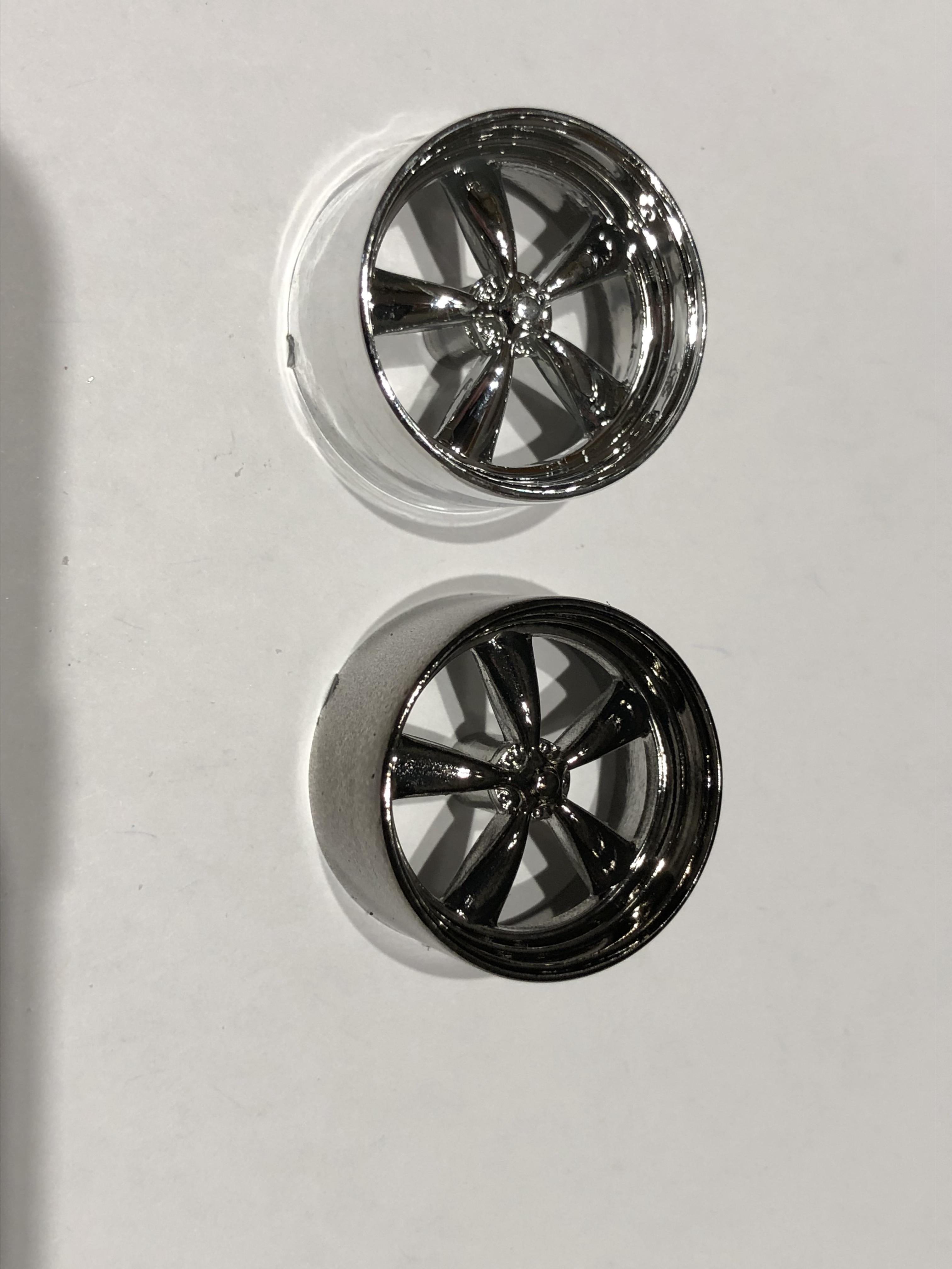

Pearl white!!!! That would look wicked with dark or black wheels! Of course it’s your build and will look cool no matter the colour. Maybe consider Tamiya smoke on the wheels? Just a thought, I just painted a set with several coats of smoke for my Gremlin build. Love where this one is going...F32A35A9-119E-49E4-8055-07407DFB3E6F.thumb.jpeg.cad25c2d7d6d1de030c6d33f561d32cb.jpeg
Link to comment
