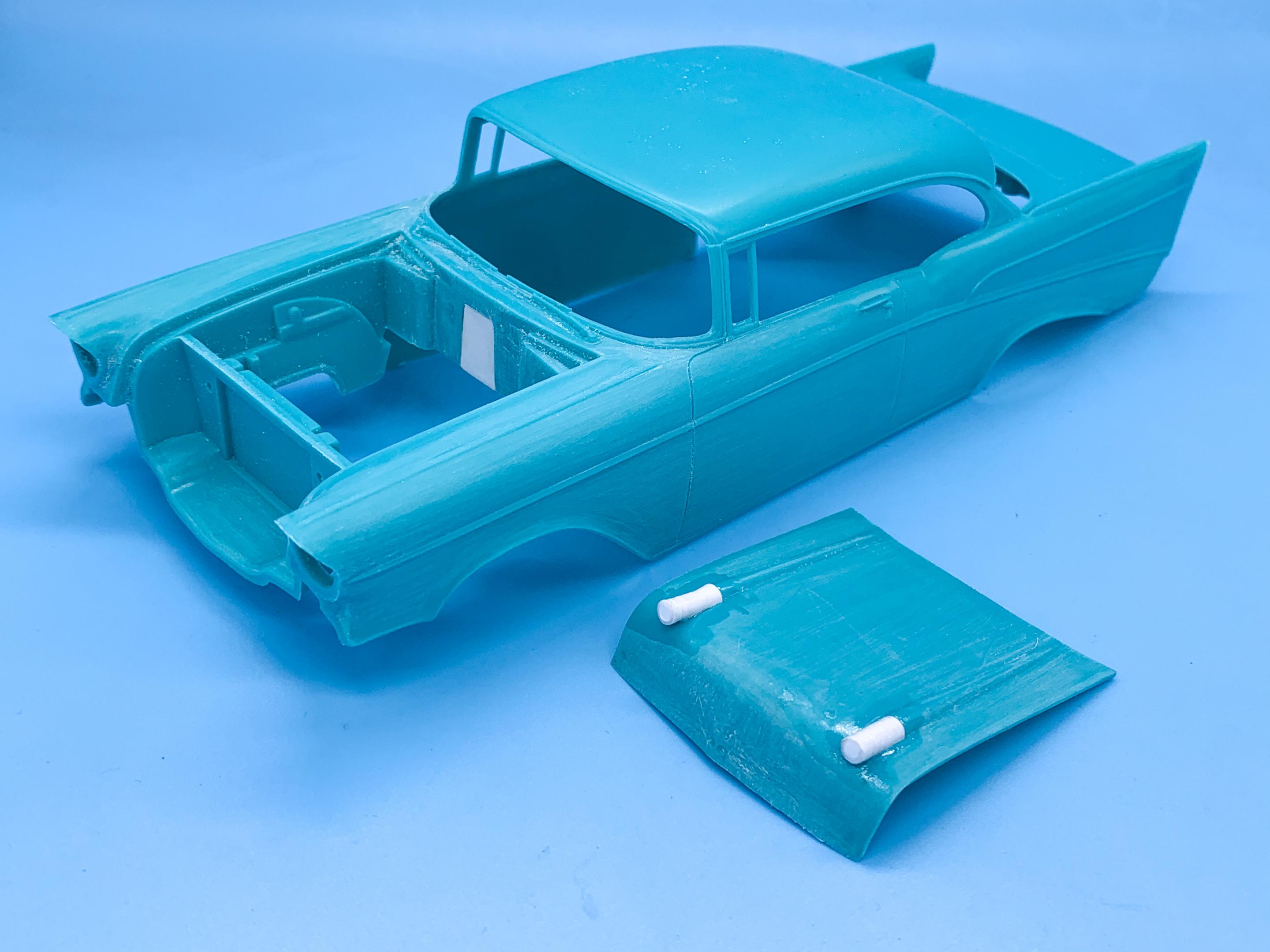

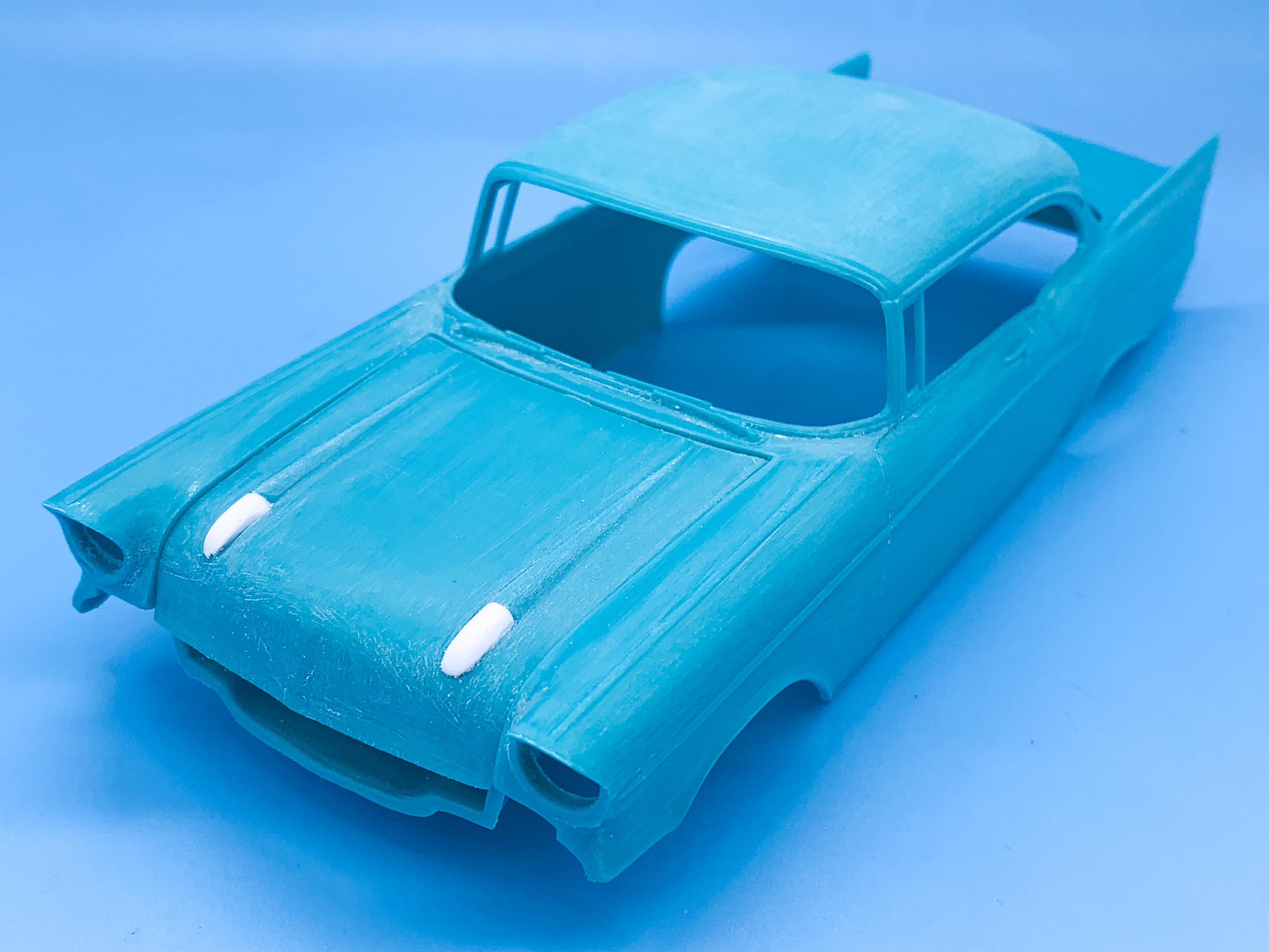

First up, plug the hole in the firewall:
The firewall isn’t accurate for a stock build, if you’re worried about that kind of thing but I think I’m going to go for a super-clean but still traditional look and feel for this one so that’ll work great for what I’m doing anyway.  I kind of imagine like how street rodders like smoothing out all the lumps and bumps and clean everything up...but without the billet and LS motor.  I think I’ll probably fill that recess in the firewall somewhat to make it connect to the sides nicely, but I need to get the engine figured out and make sure nothing will interfere before I get too crazy here...
This being an older tool, the body needs some attention so I’ve been picking a panel every night this past few days and just getting it levelled out and perfect ready for paint.
Started off with the driver’s side front fenders - I removed the three vents from there and shrunk the crease that runs along the top of them:
I like the smoothed-out-hood on 57s too, so I did the same as Dennis Lacy just did on his excellent 57 build too and plugged the holes with some round bar...
...then shaped them into something like what I’d imagined:

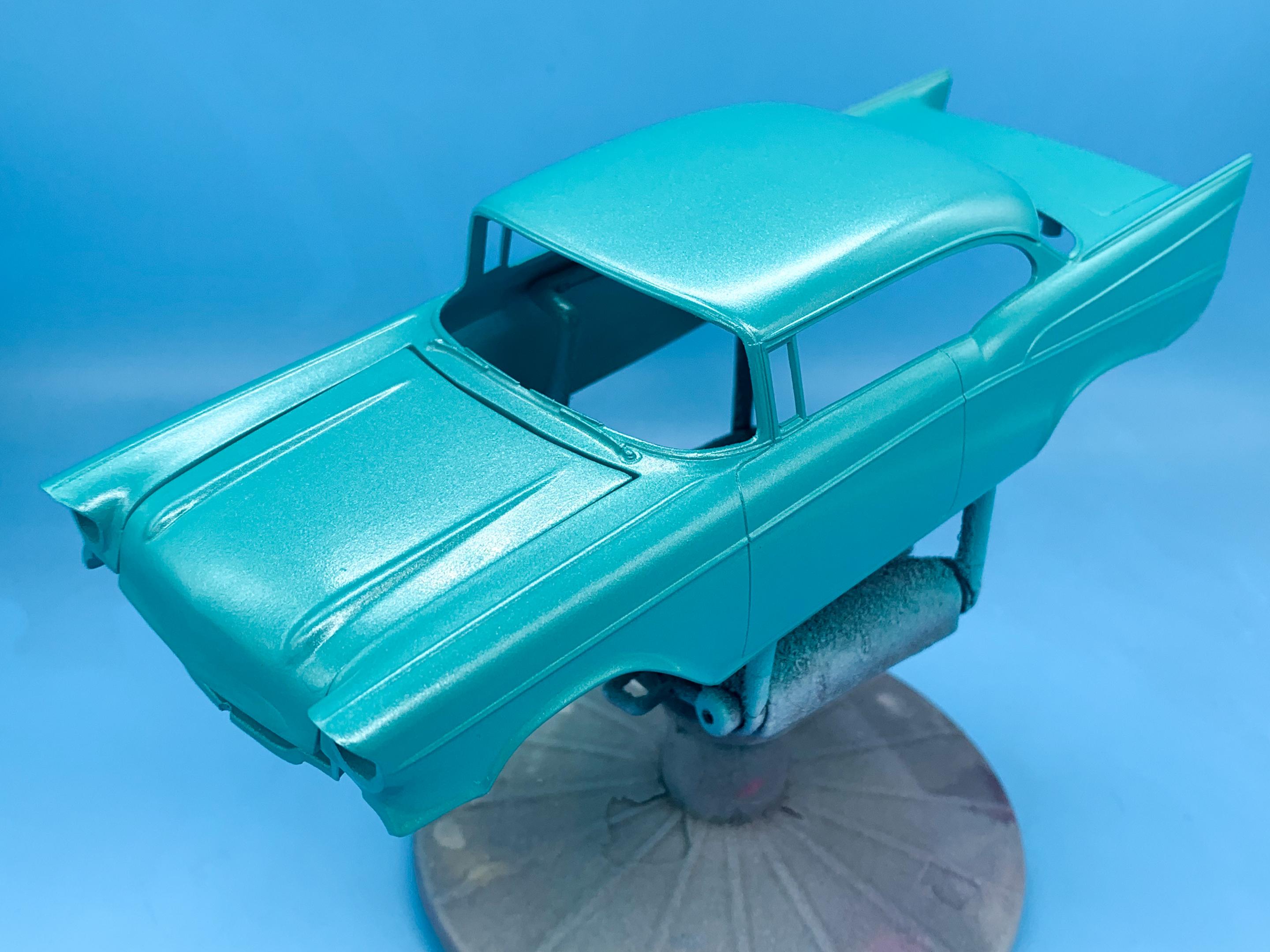

Made a little progress on this one, and seeing as @crazyjim and @Dragonhawk1066 had asked to see how some Pearl powders I’d picked up worked out I figured time for a little update on this one…

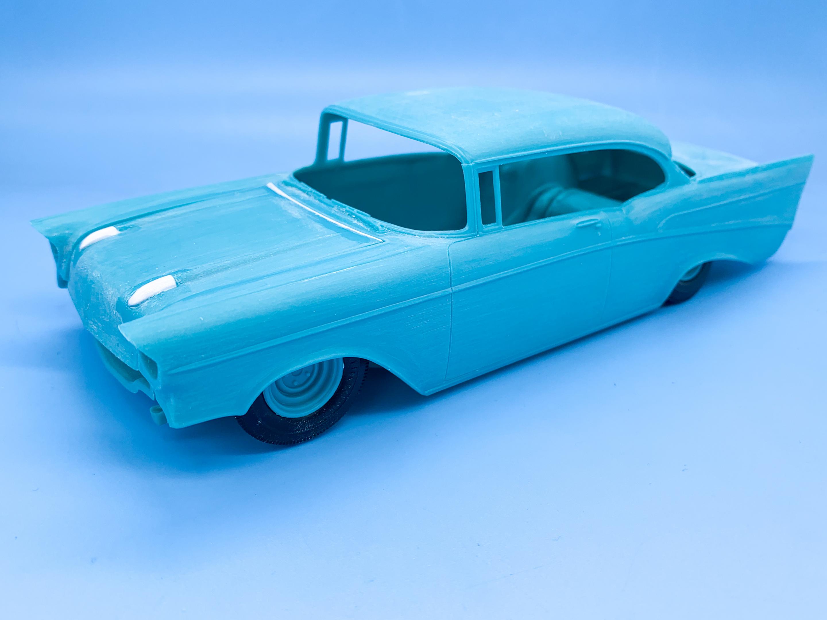

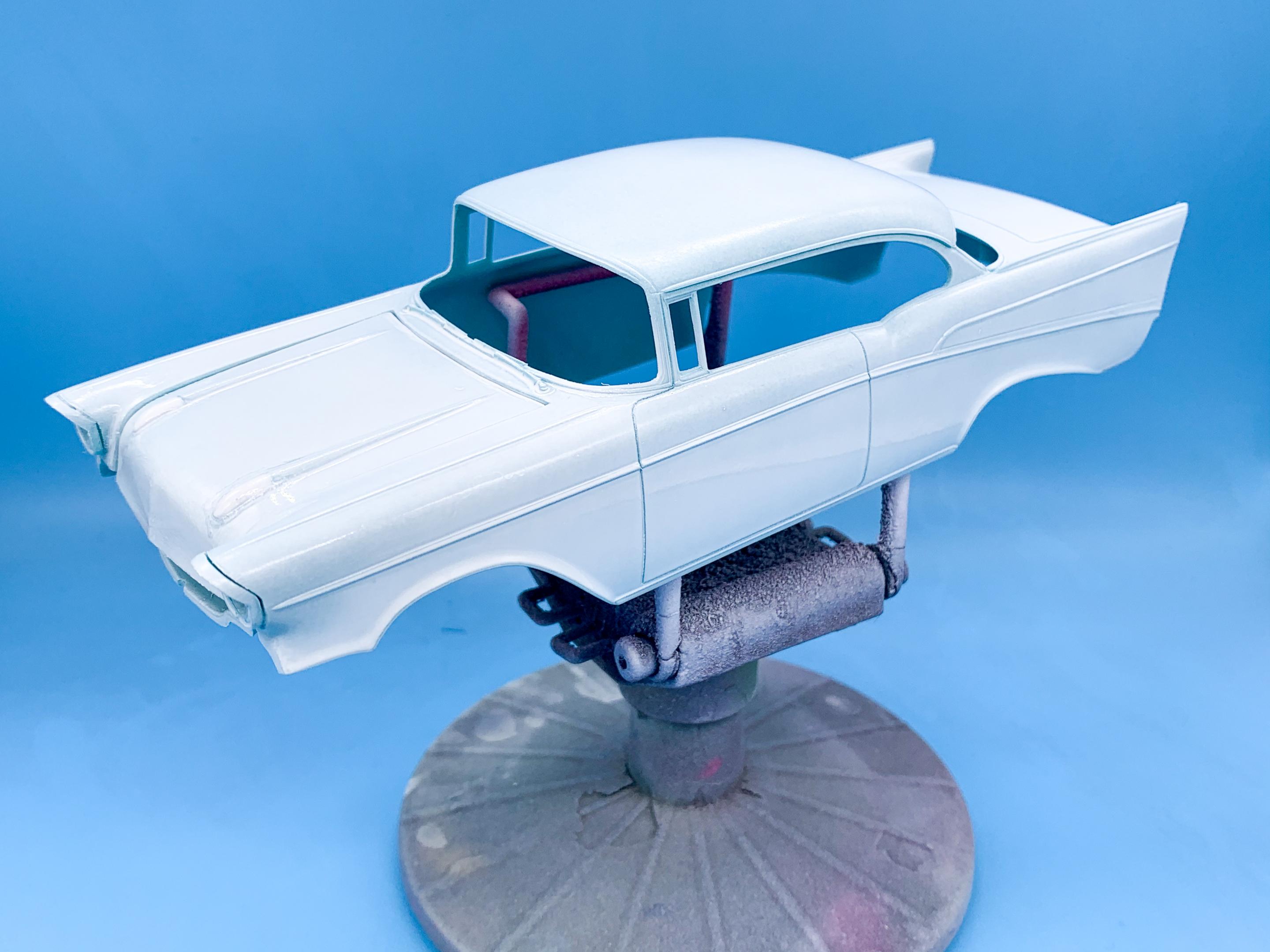

Got the body straight and into primer:

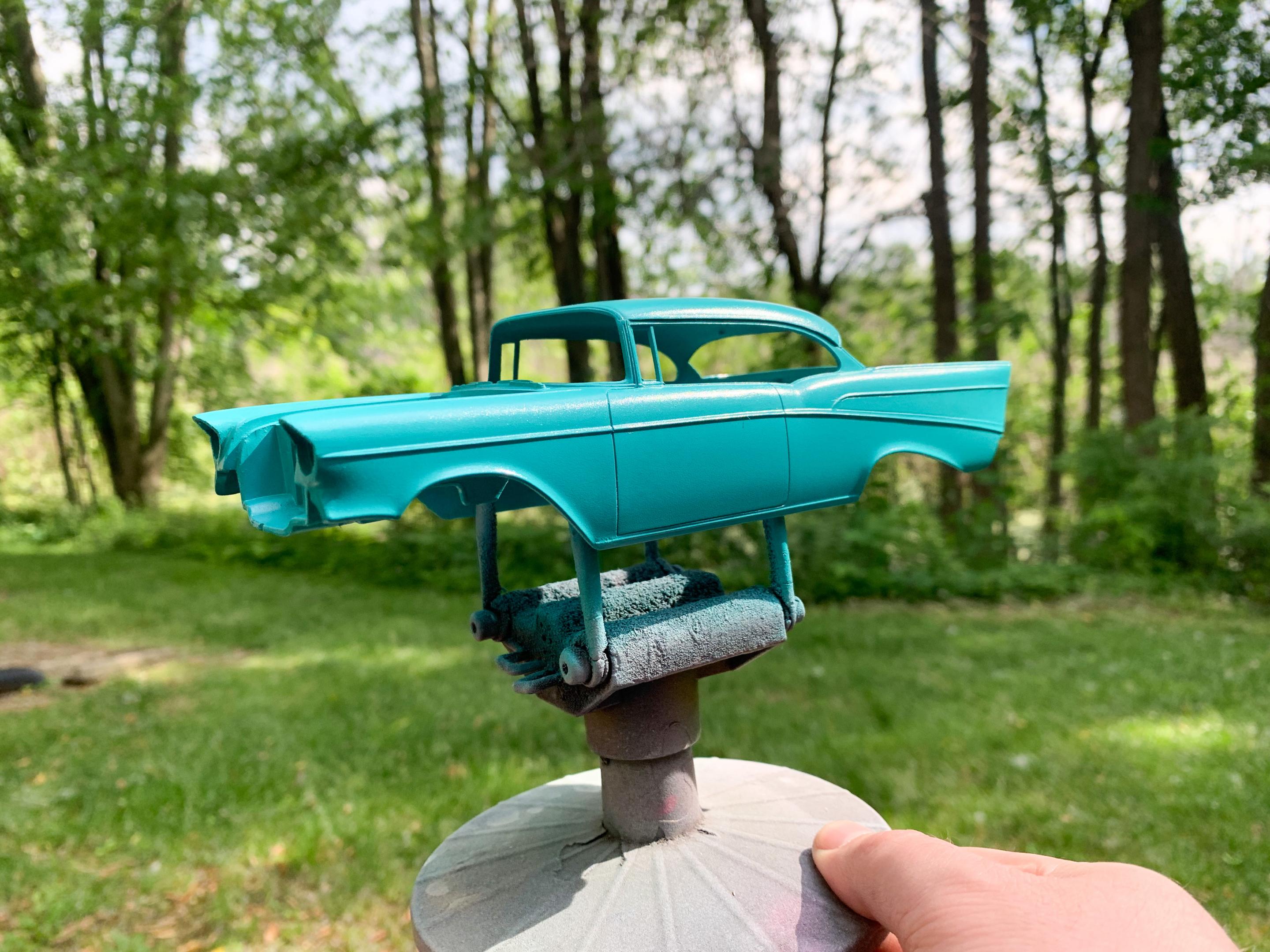

And after a couple more rounds of sanding and re-coating I got it into factory-correct GM aqua this weekend:

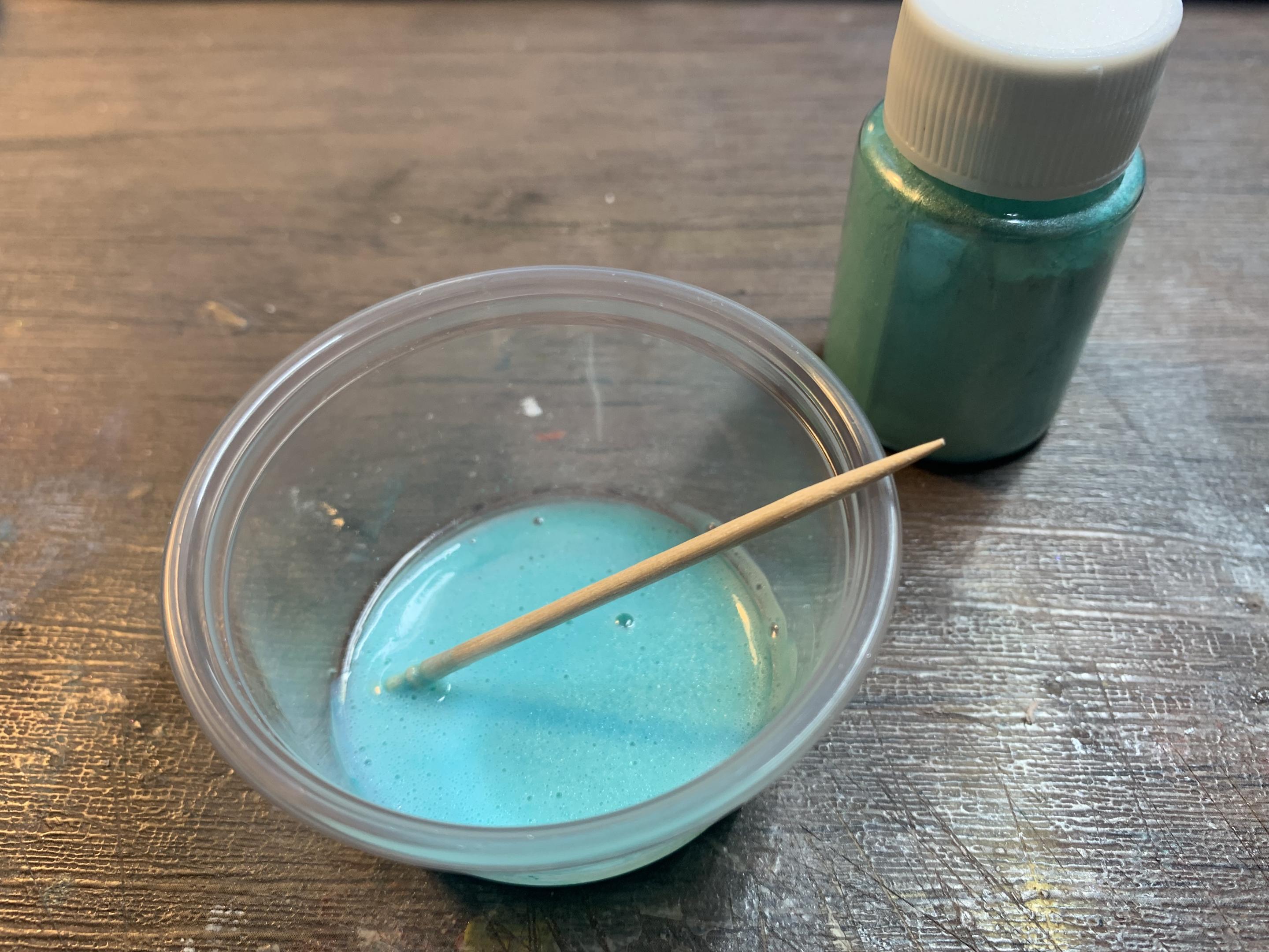

I wanted to go with a recognizable 57 Chevy color but with a twist, so I picked up a set of mica powders that had an aqua green powder in that matched the base color closely…
And mixed some in with some Future:

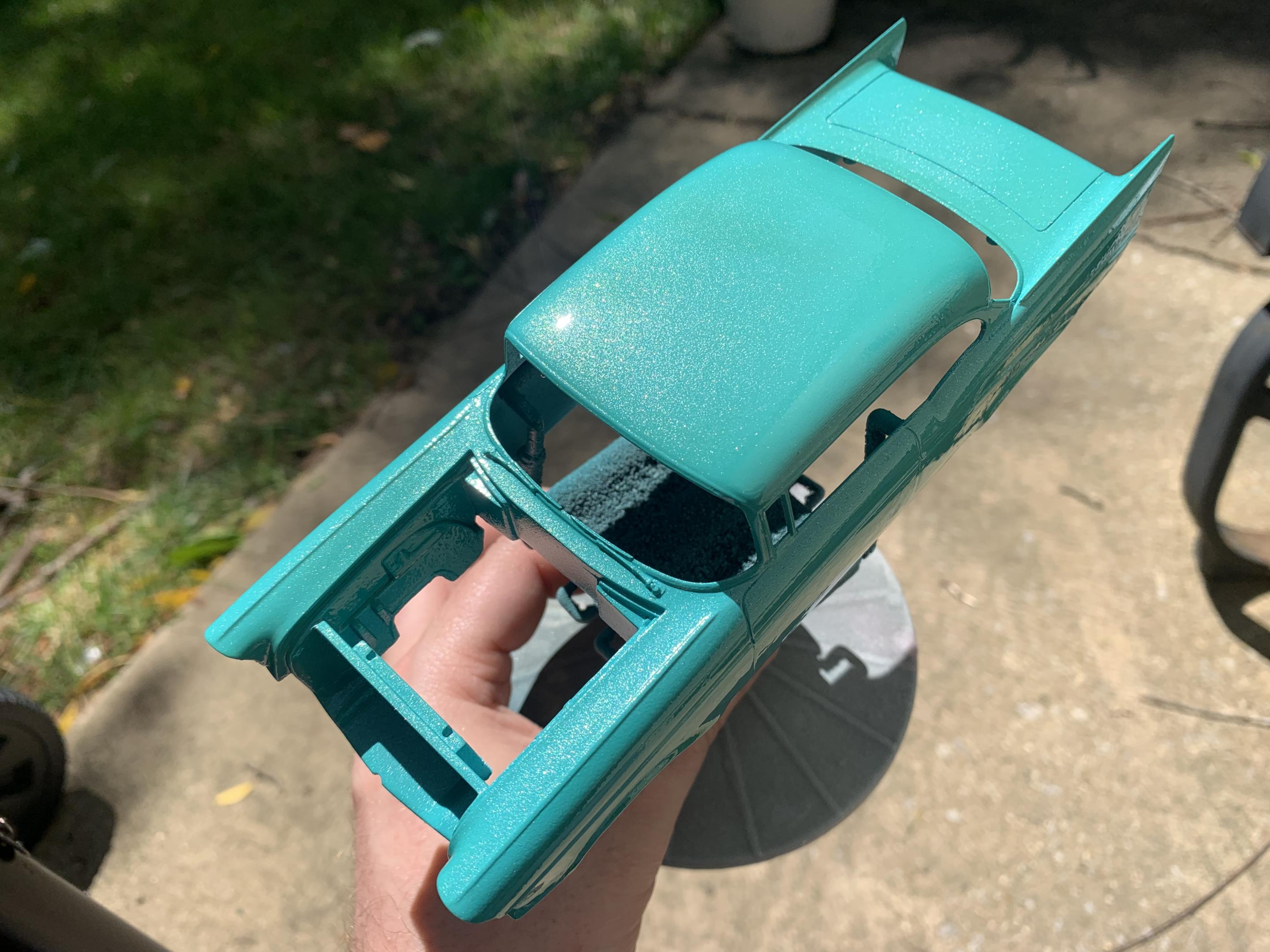

A few light mist coats gave me this:

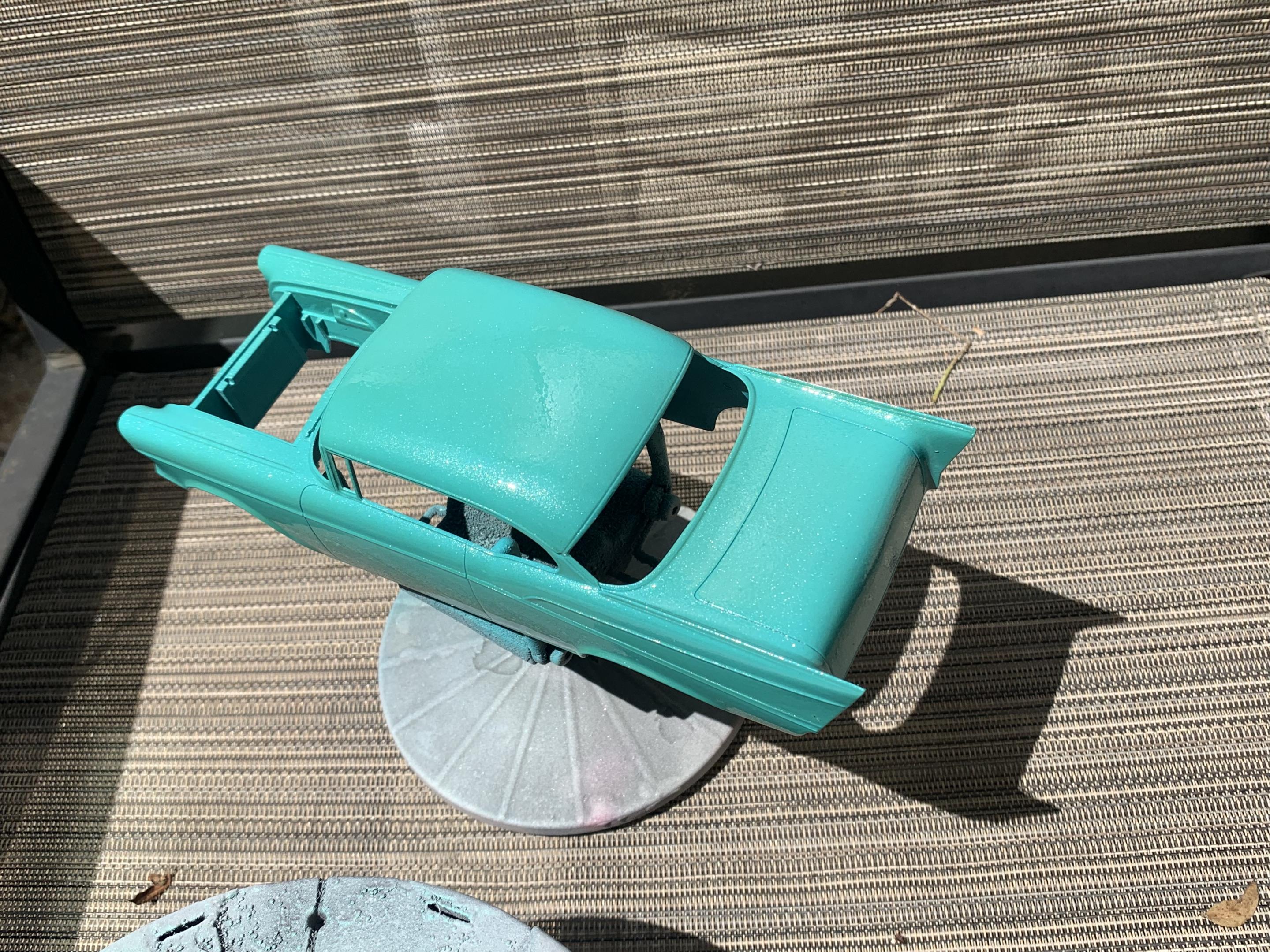

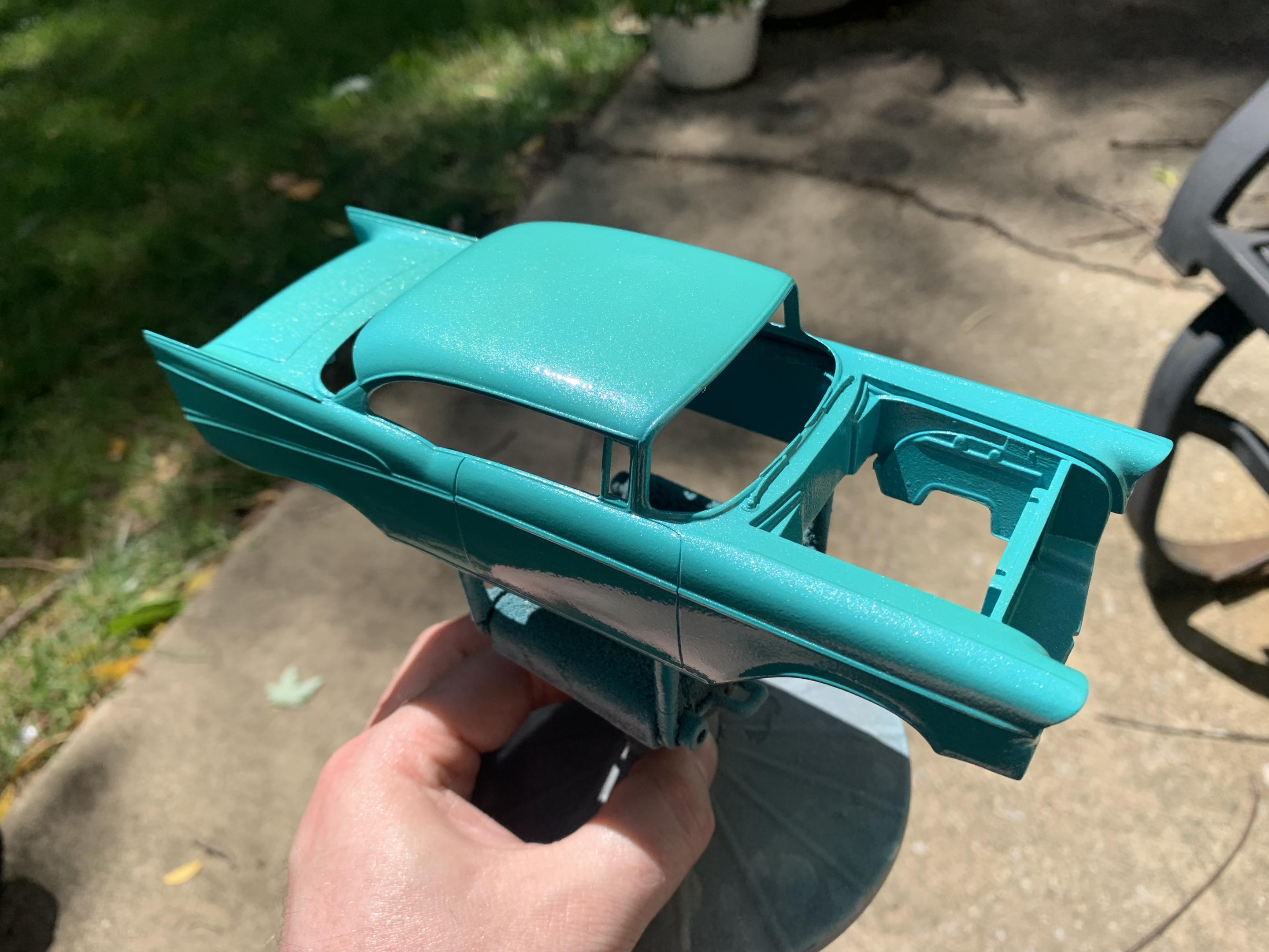

Looks ok, but I wanted to bring the tone down a little and make it a bit less bright, so I mixed a little gold from the same set and gave it a couple of coats of that too:
Much more like what I was thinking!  The green Pearl gives a nice flip to a lighter shade when the light hits it, and the gold gives a nice highlight in the shadows and over those curves.  Should really pop in the sunlight, and even more so under some nice glossy clear!
Plenty more to do on the body of this one, but I promised a little quick demo of how the pearls work to those coupla guys so here it is…more soon!

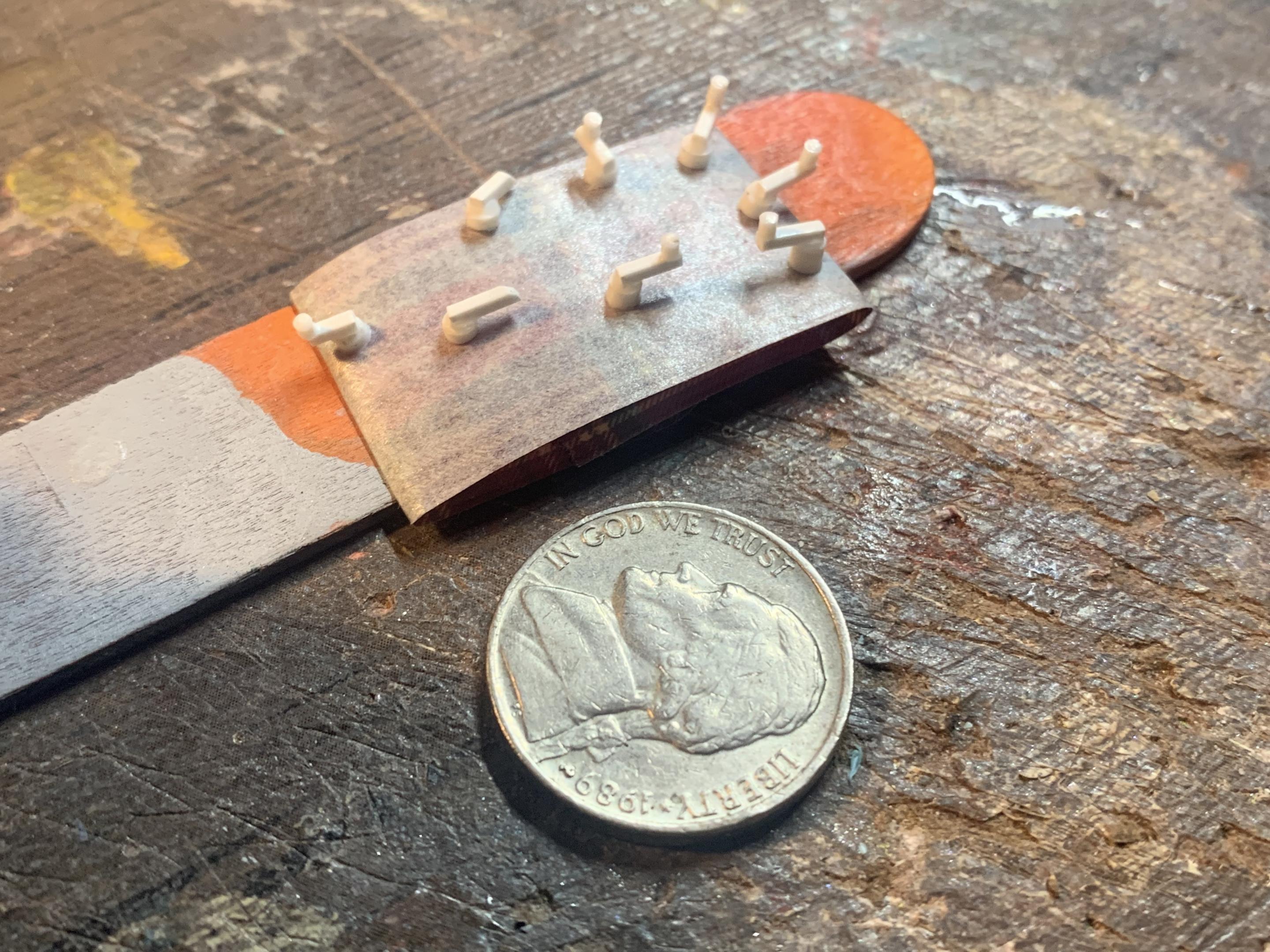

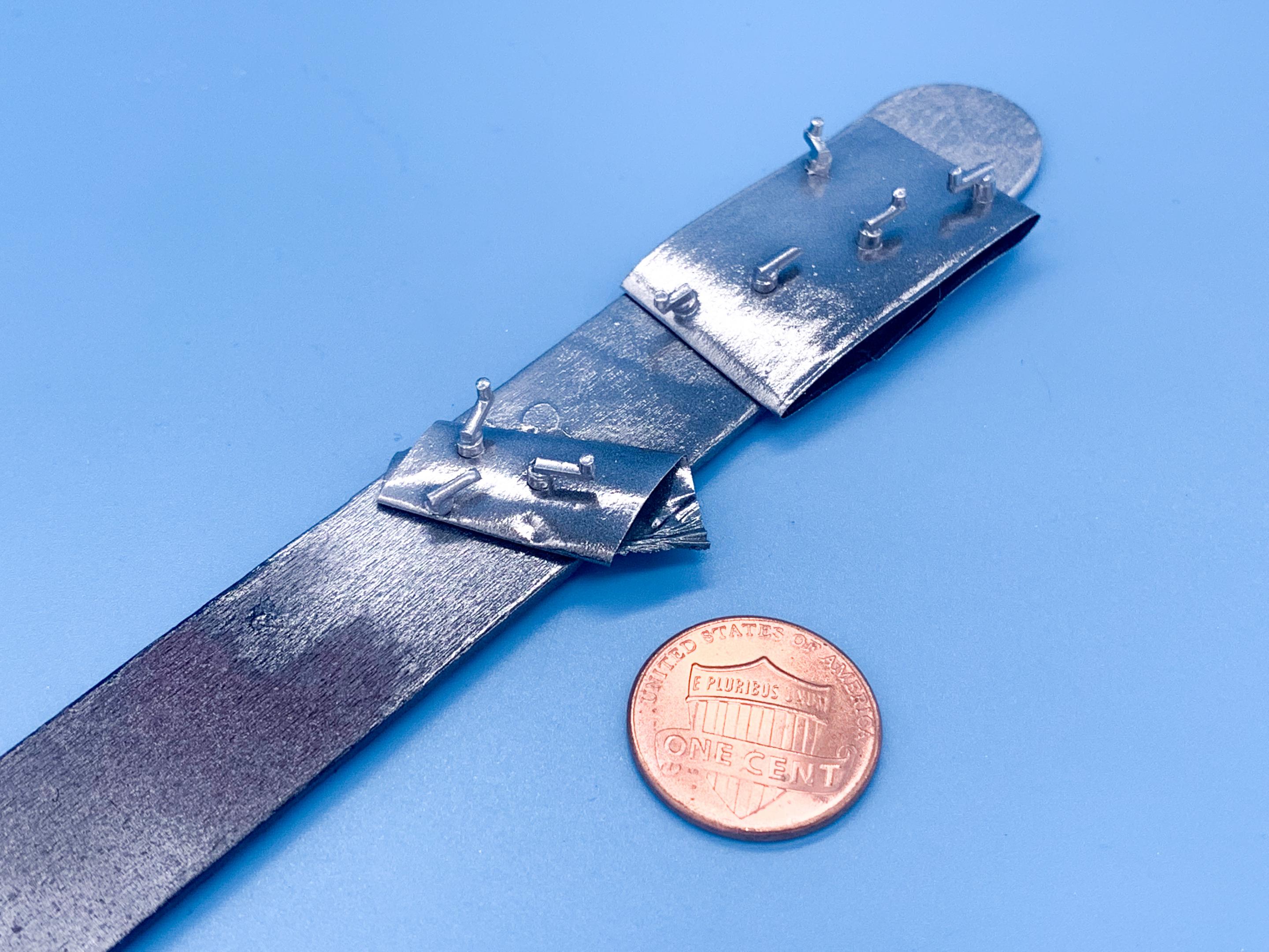

Last couple of weeks casual progress…sanding off the flat ol’ window cranks and door cranks and scratchbuilt new ones:
They could probably use some more shaping and messing around but they’re a world better than the almost non-existent ones in the kit as it comes:
Shot them with black lacquer and some Spazstix and they’re drying overnight awaiting installation:

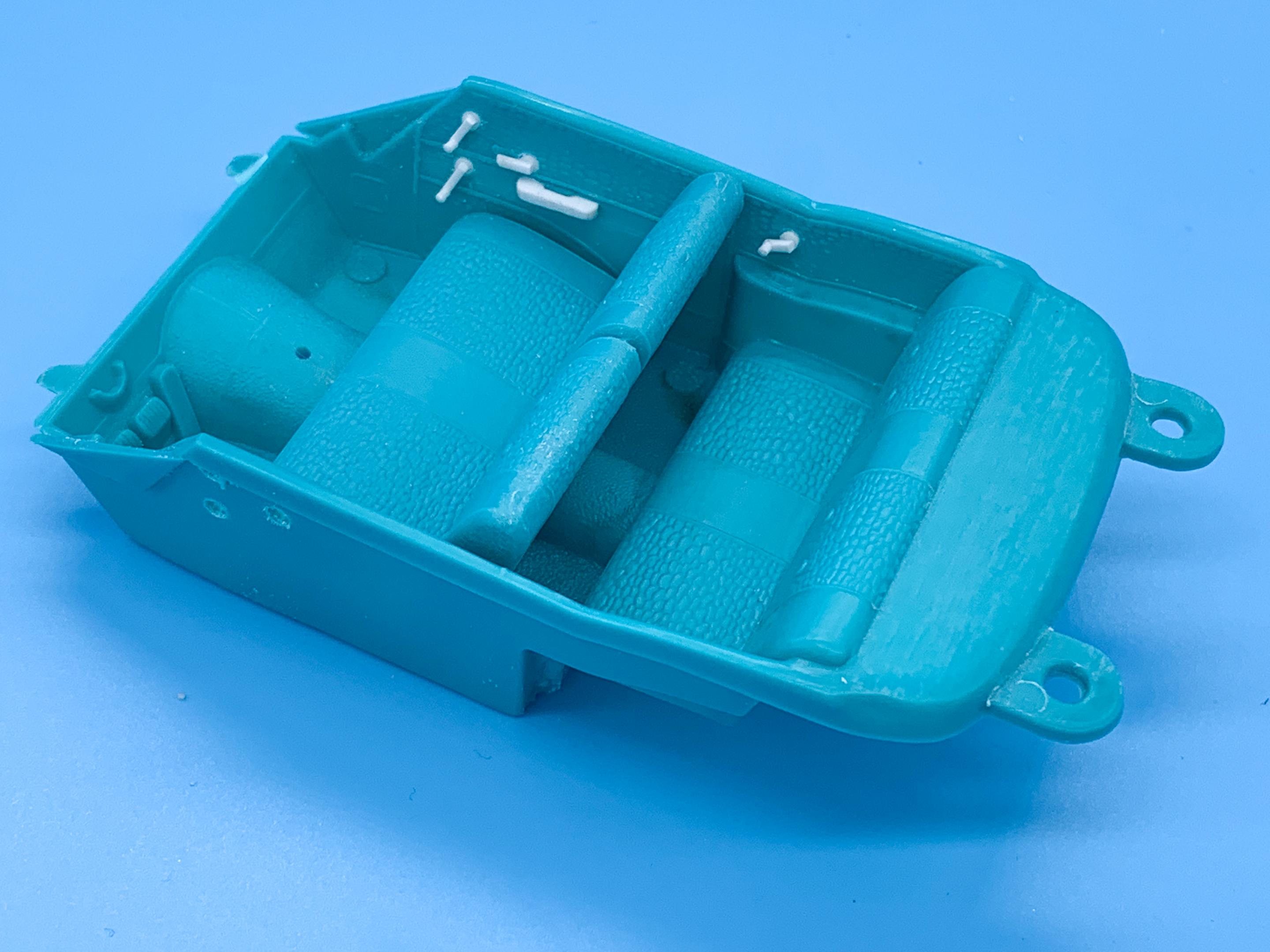

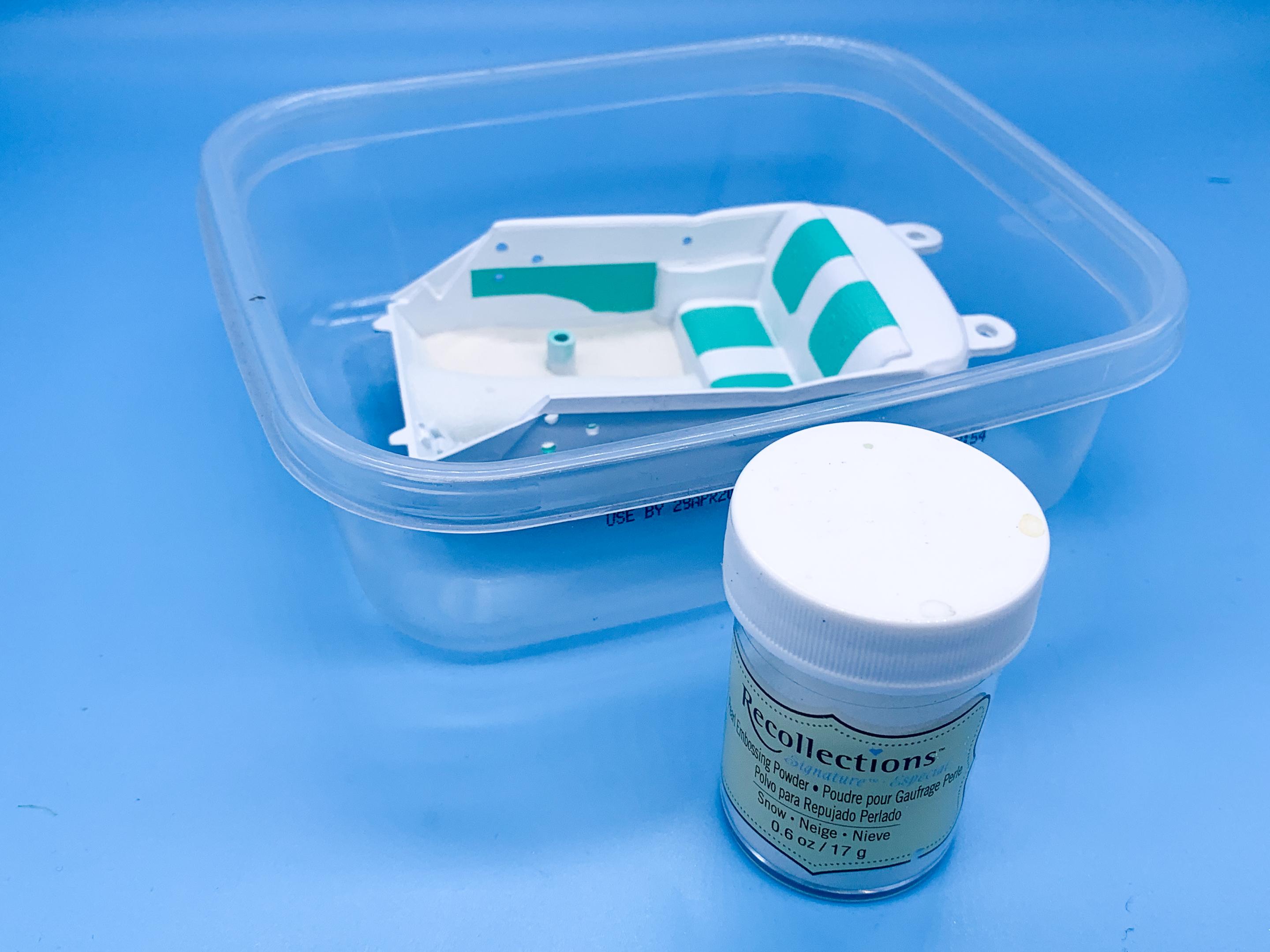

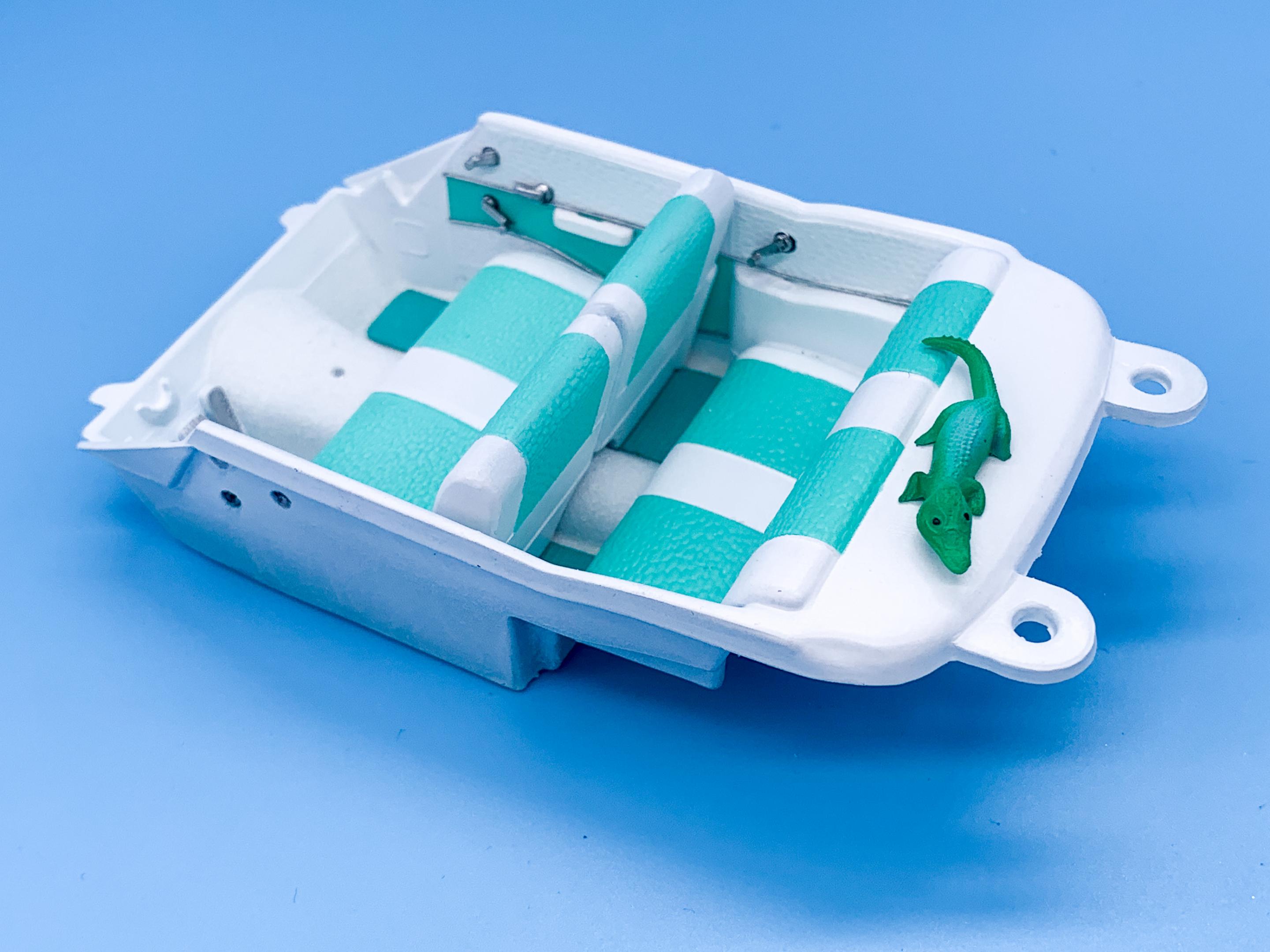

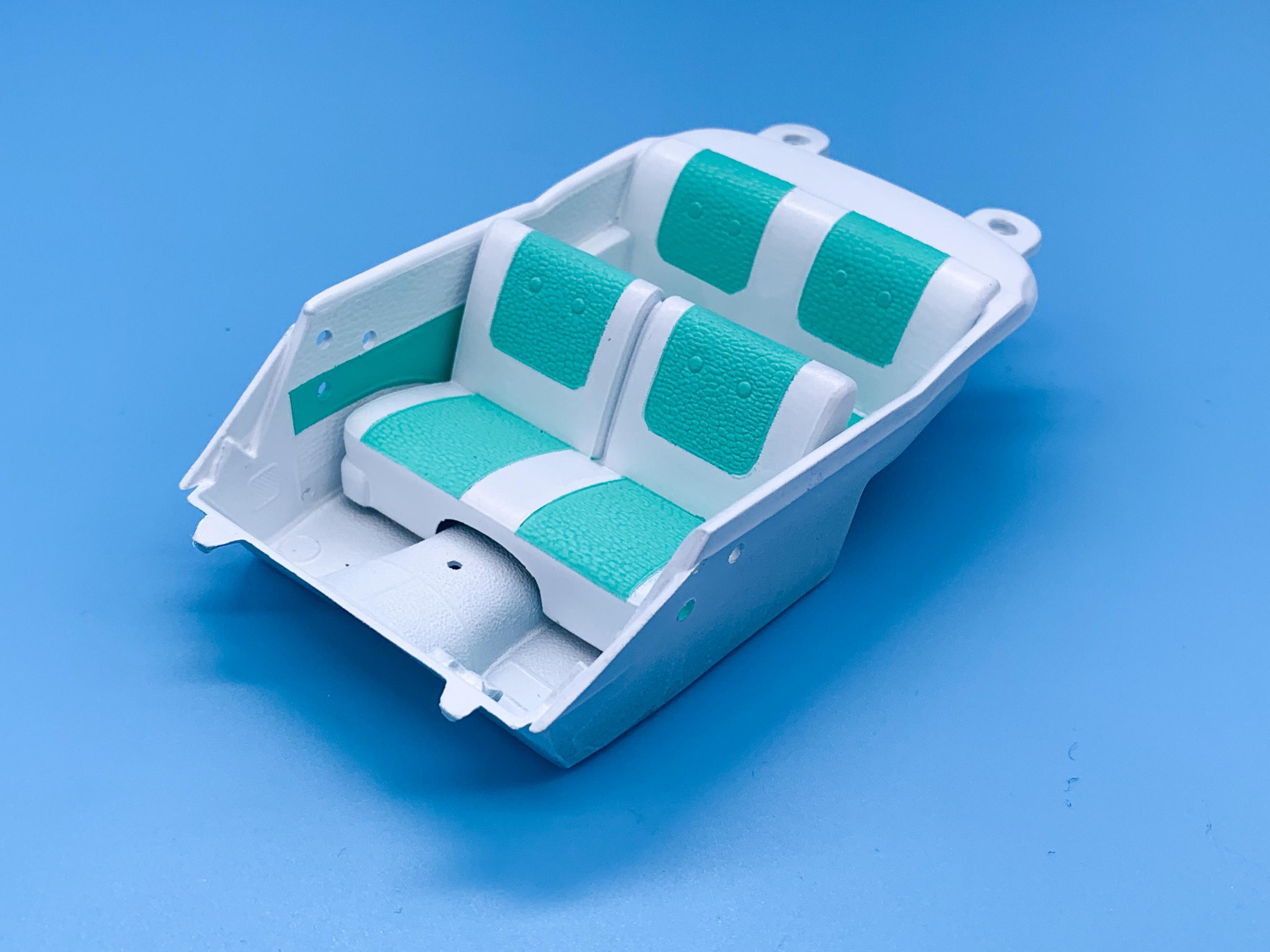

Meanwhile, shot the interior with Createx pure white and some minty green acrylic artists paint for a reverse-two-tone take on the standard white and green 57 interior:
Then added a slightly off-white carpet with embossing powder:
And then started adding some of the chrome trim with silver wire I picked up at Hobby Lobby:
Im still putzing with that to get it perfect, and cleanly installed - I need some kind of wire-straightening tool to make it easier!  I’ve been getting the ends stuck down on each piece and then feeding in a little drop of glue and working along the middles gradually…need to keep practicing at that…

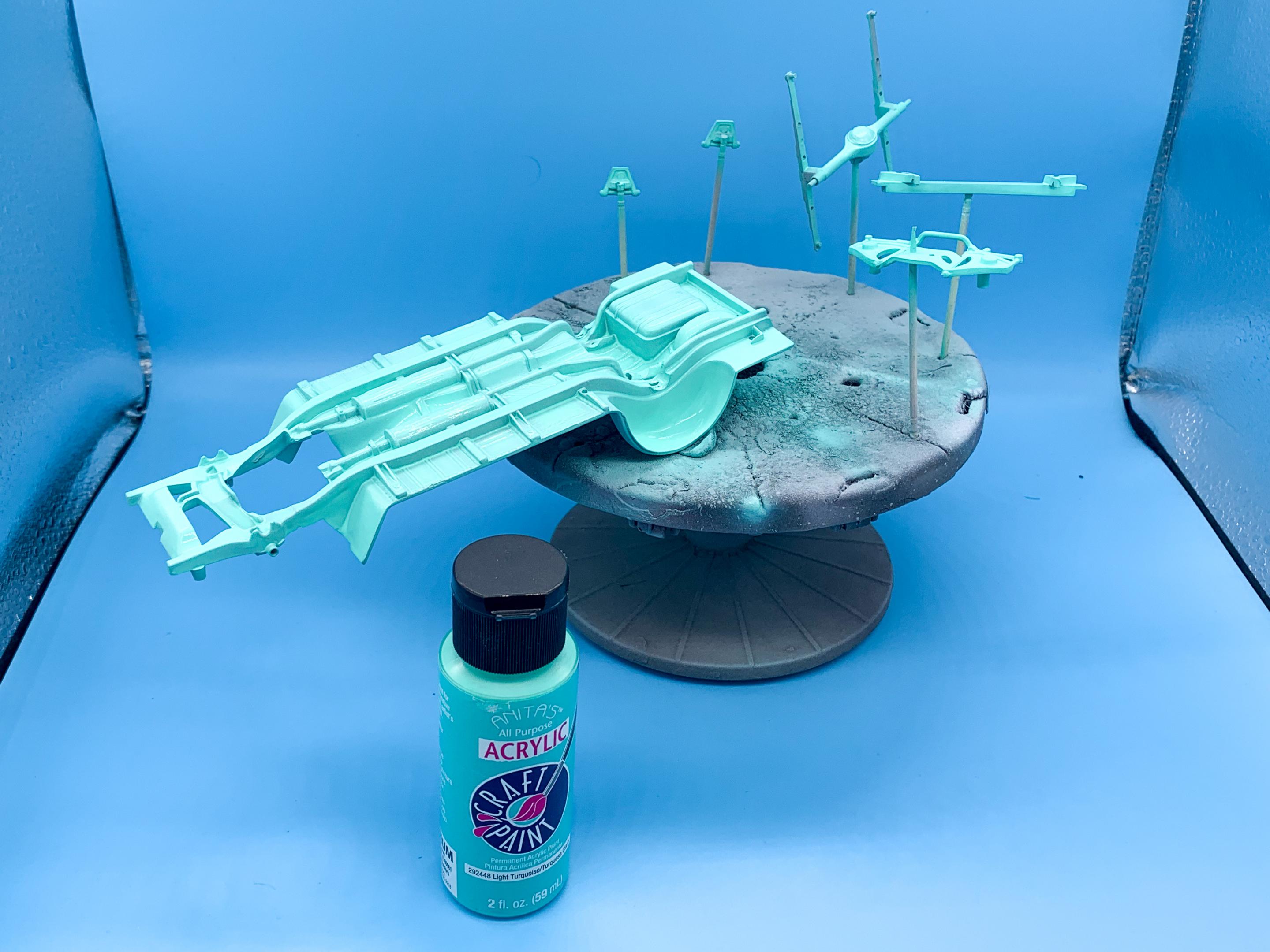

And finally, the I’m not really focusing on the underside of this one too much - but the bits that will be visible are going to be another shade of minty green:
