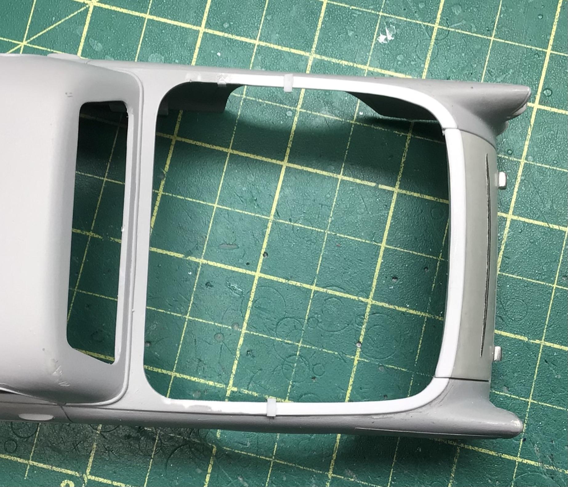

I’ve added some drip rails to the roof and a piece of molding around the base of the cab. Also smoothed the tailgate.- 141 replies
