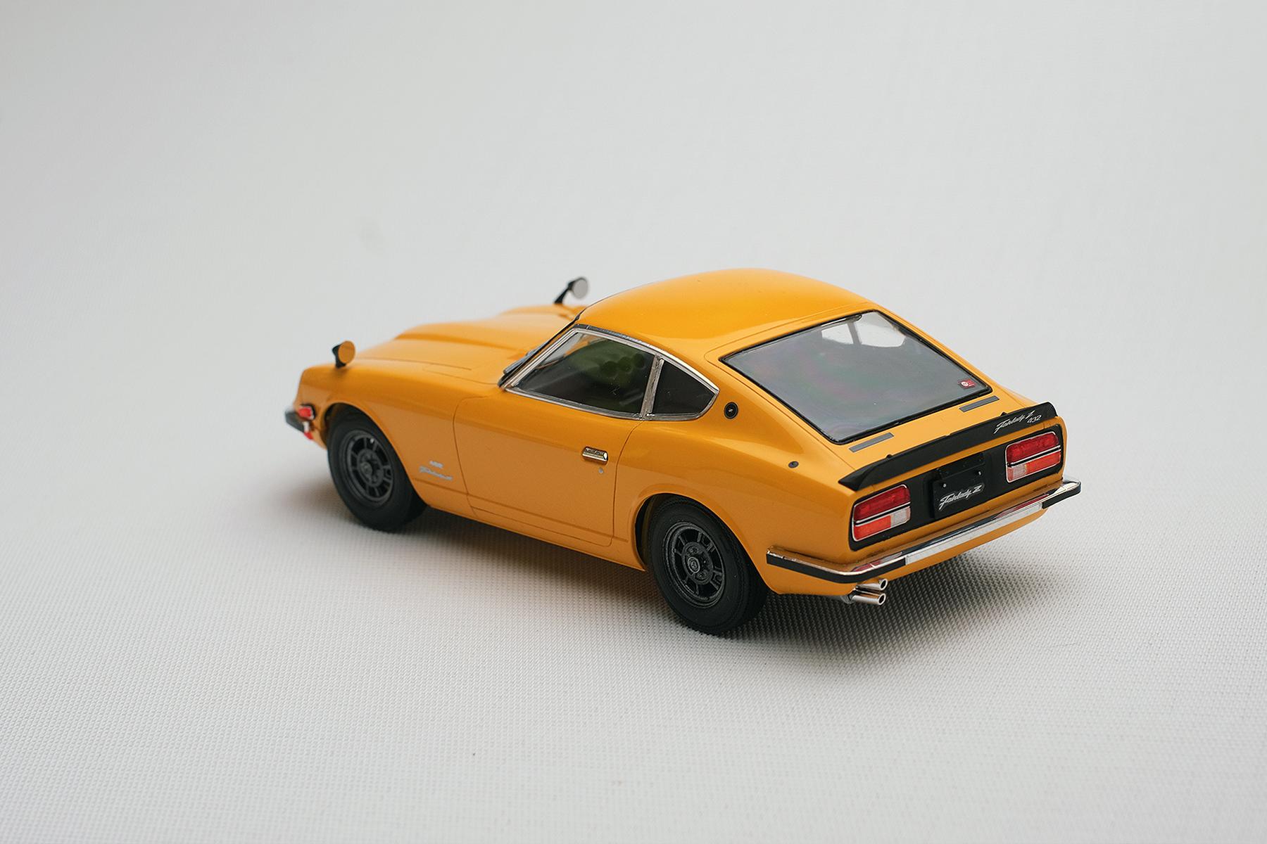

Thank you! I definitely took my time building this one! Appreciate it! Thank you! The thickness adds a some reality for sure! Thank you! I spray painted silver, then sprayed ts-38 gun metal. The center cap is painted with silver sharpie. Thank you! Maybe I should buy the 510 bluebird as well! Thank you! I usually do three coats too, but this particular model had very thin and shallow panel lines, so I decided to go a bit lighter even though I wouldn't be able to wet-sand as aggressive as usual. -

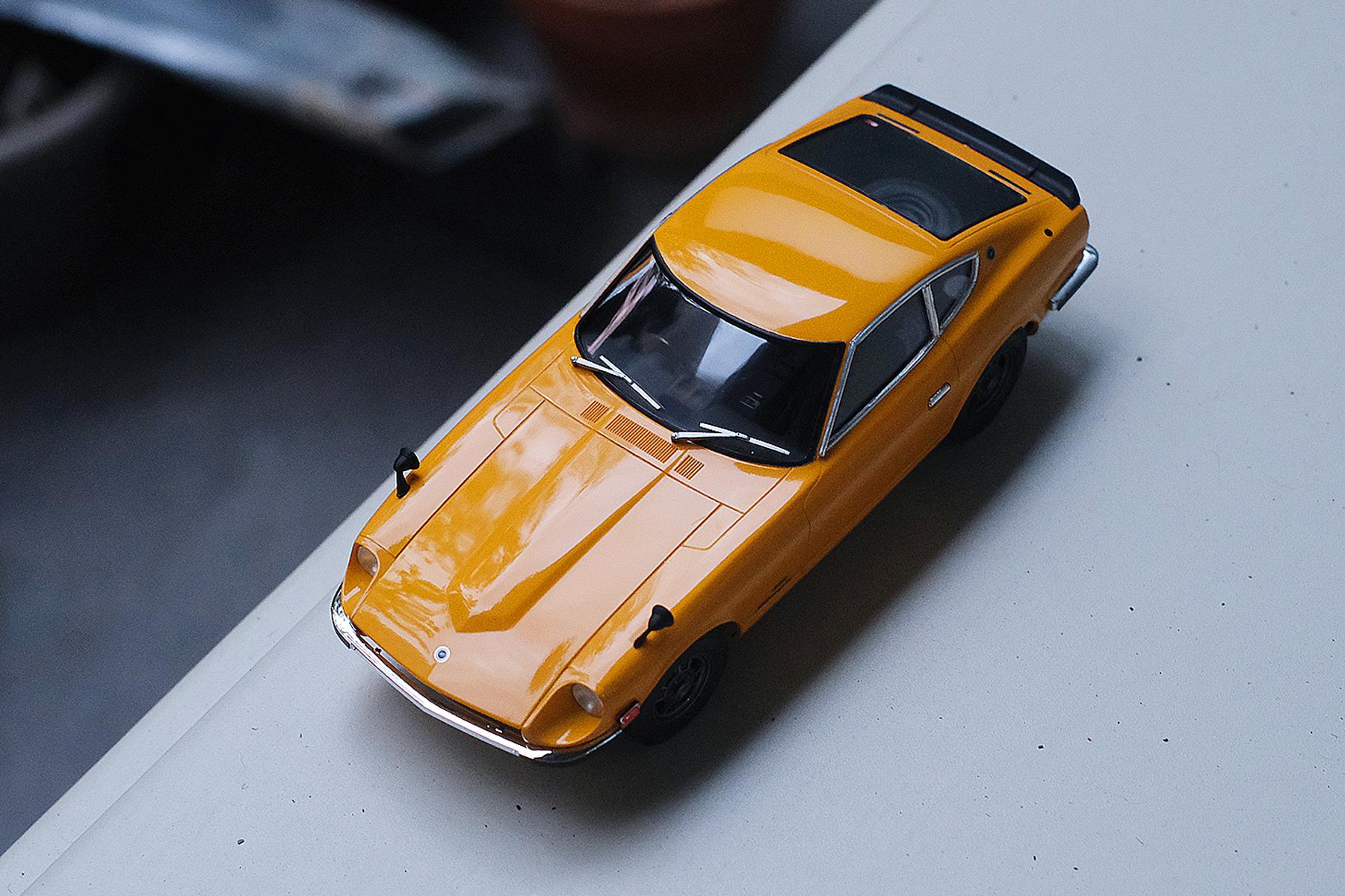

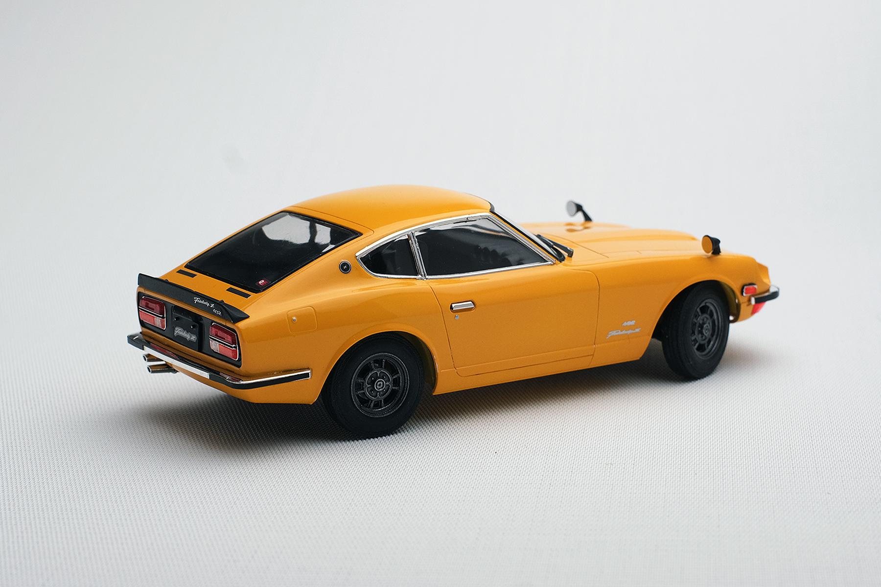

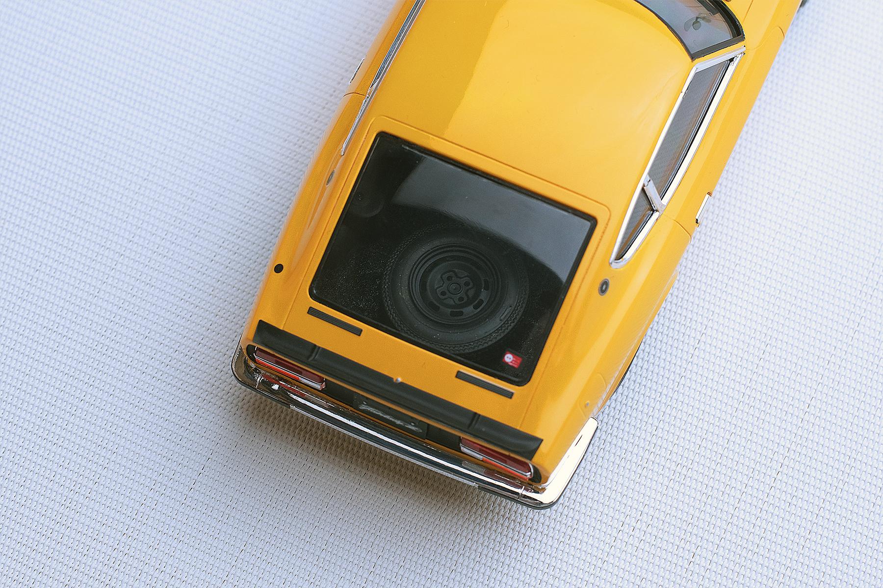

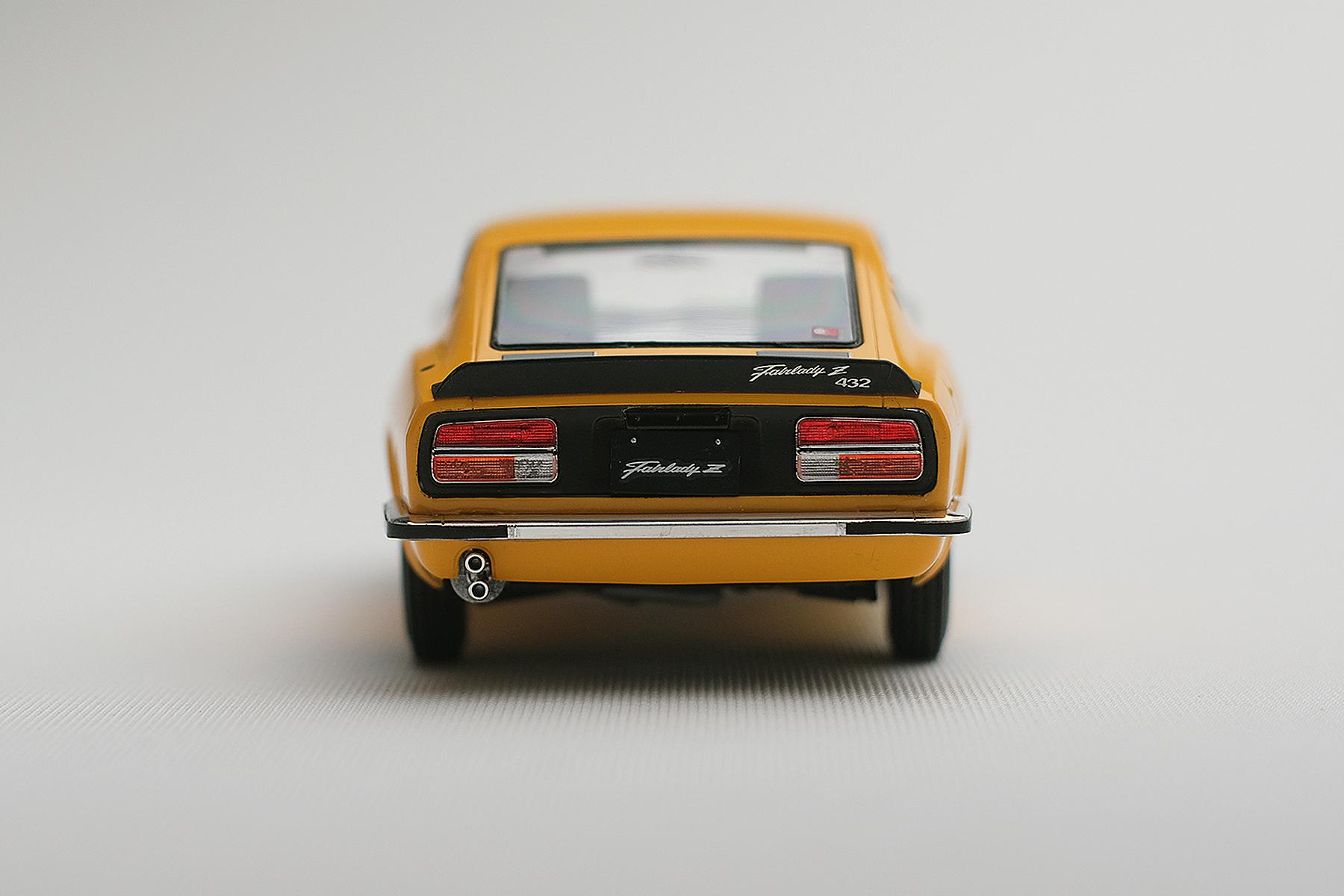

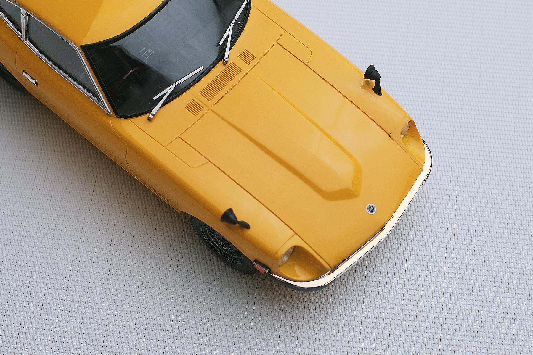

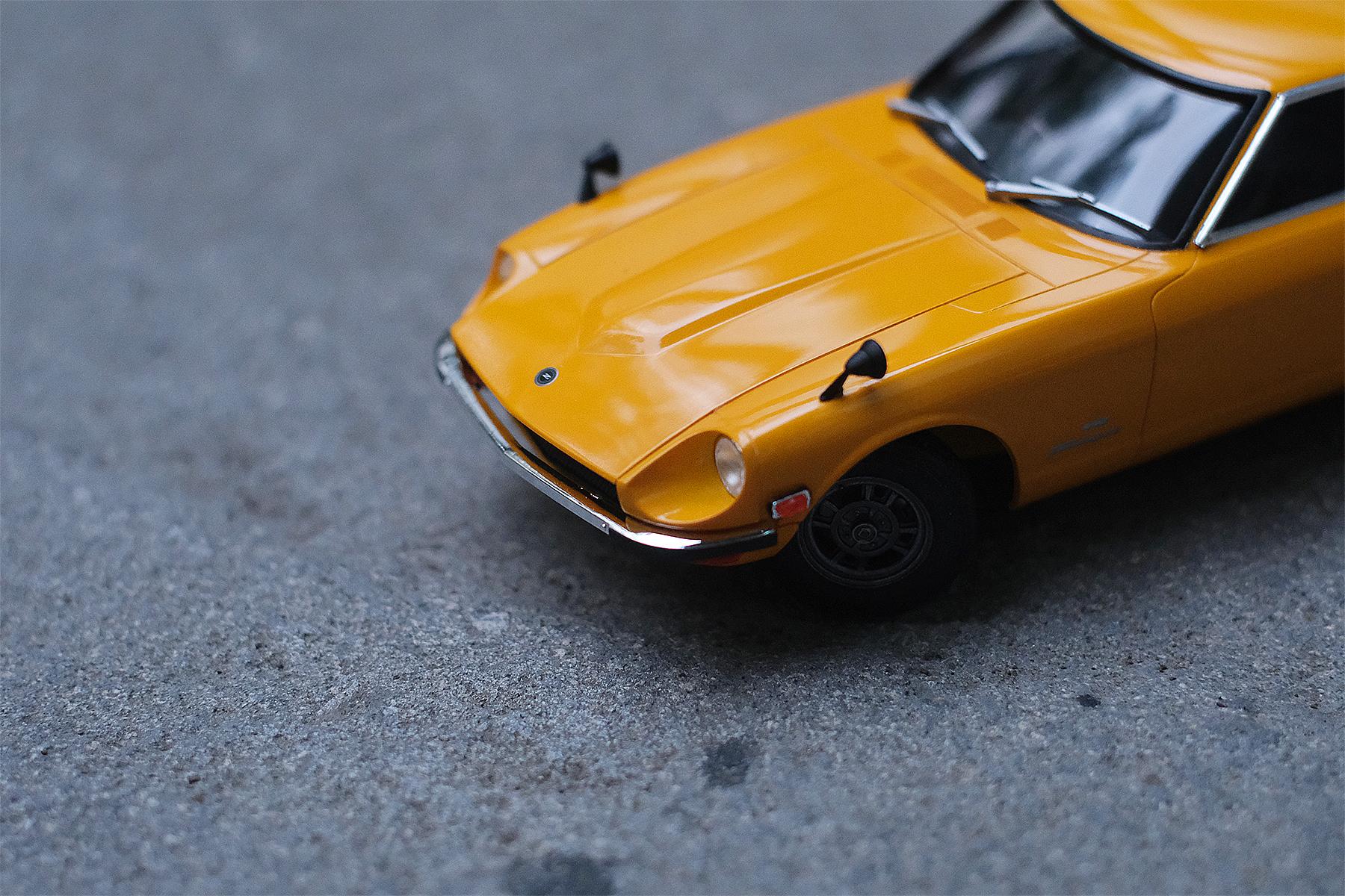

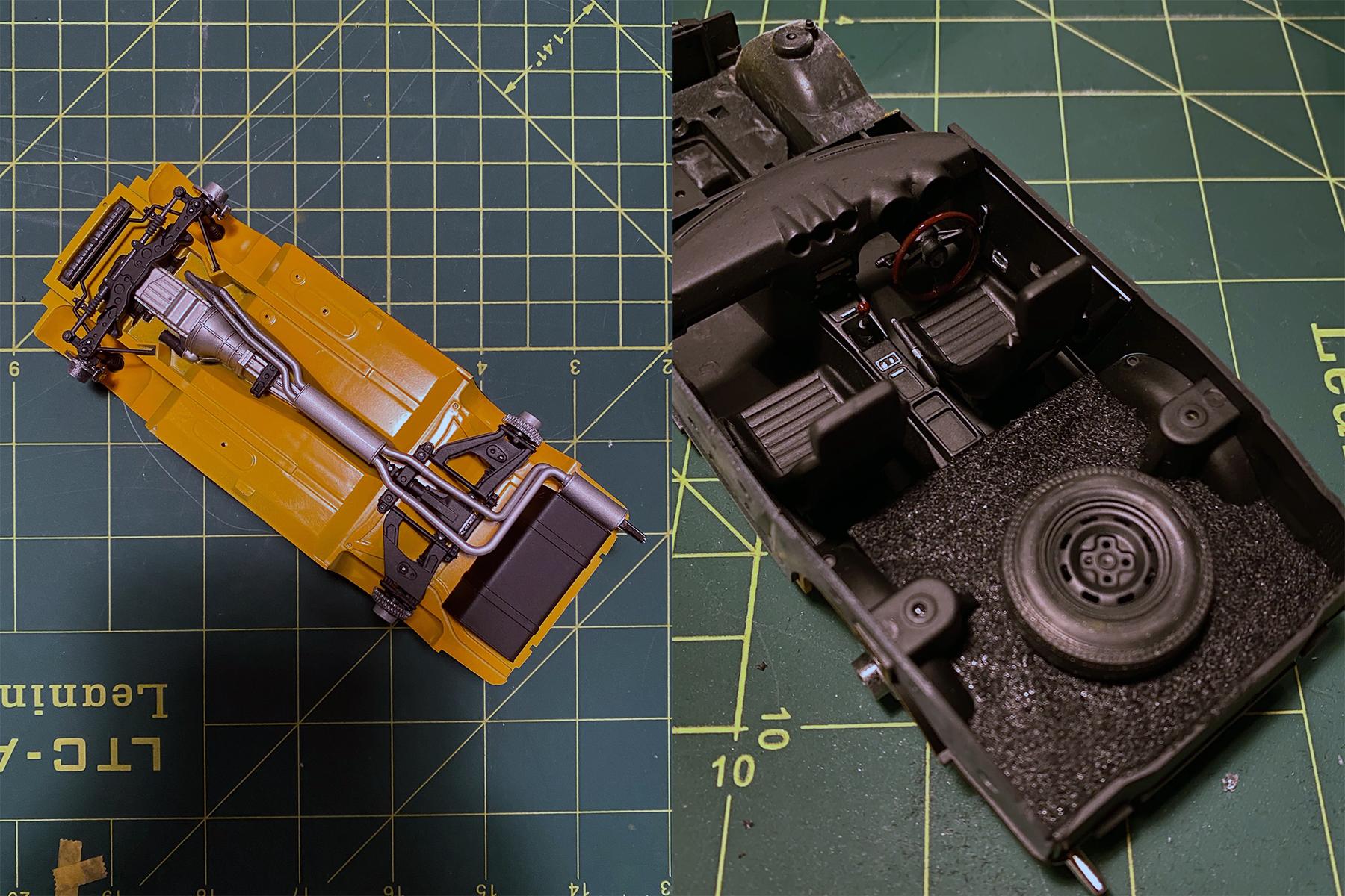

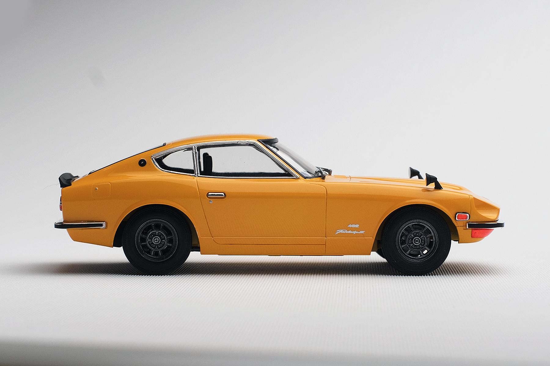

Hi all, This is my latest build - it's one of the Hasegawa Fairlady kits that come in various forms (ZG, Datsun 240Z, rally version, etc) depicting Z432R, which was the homologation model for their racing program with S20 borrowed from KPGC10 GT-R. I decided to create it as Z432 instead of Z432R because I didn't like the orange that came with Z432R, as well as black hood. For the build, I used; - Tamiya white primer - Tamiya Camel yellow (two thin coats) - Tamiya gloss clear (two wet coats) - Prepped the body with 1500, 2000, 3000 grit sandpapers - Polished with three stage Tamiya compounds - Masked the front window trim and rear end and sprayed Tamiya flat black - BMF'd side window trims - Tamiya gun metal for the wheels and flat black for the interior - Thinly sliced electrical tapes for bumper trims and turn signal gaskets - Flockings to simulate trunk carpet - Acrylic wash (yellow + brown + thinner) for panel lines With 91 parts count and being curbside kit, it's pretty simple kit to build. It also comes with pretty detailed clear and chrome parts as well as metal transfers for various badges and side mirrors, so I highly encourage one if you want to make a 240z!

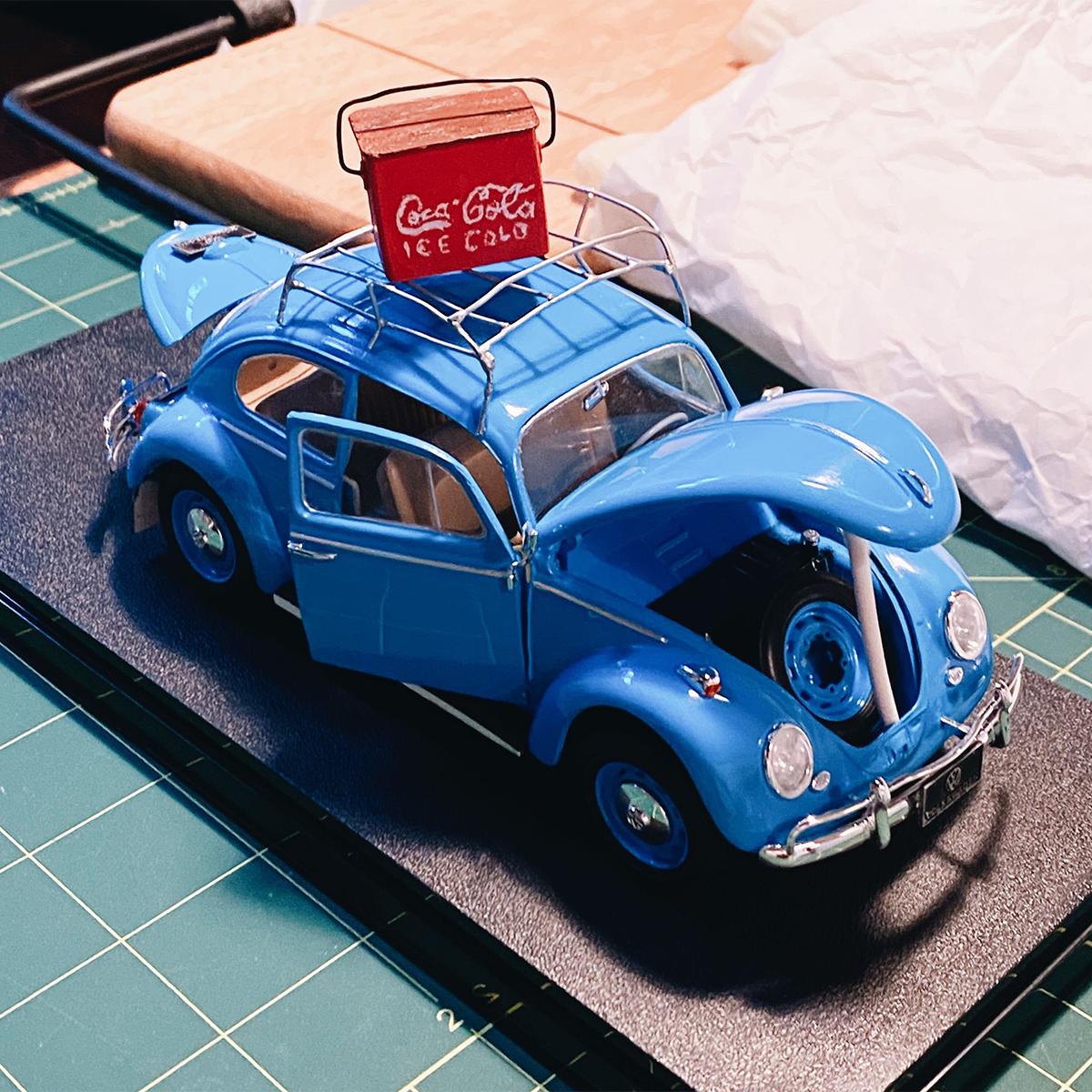

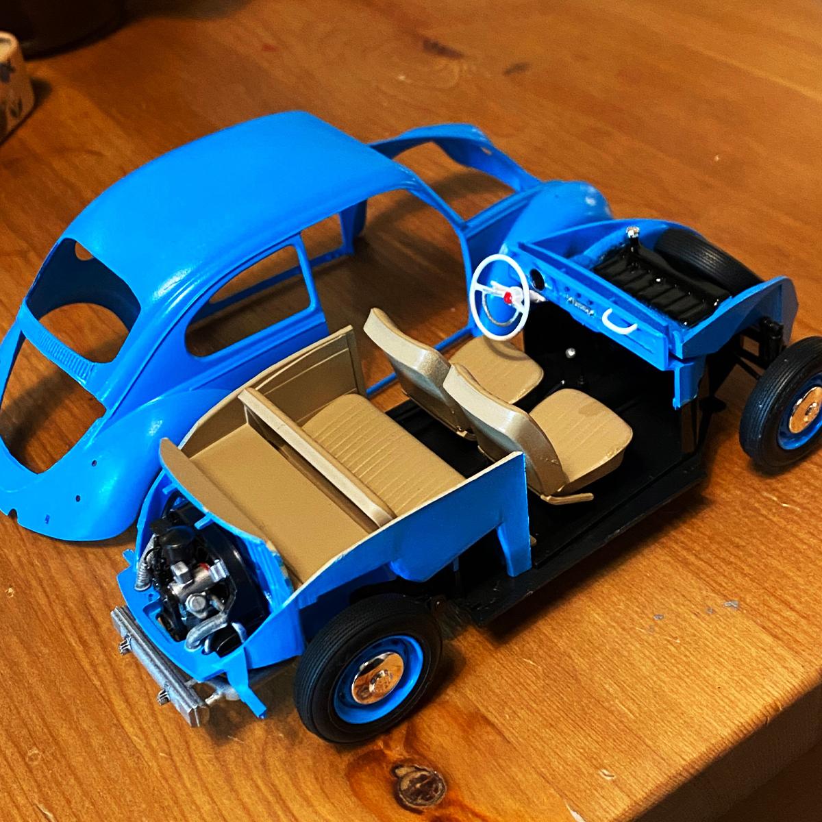

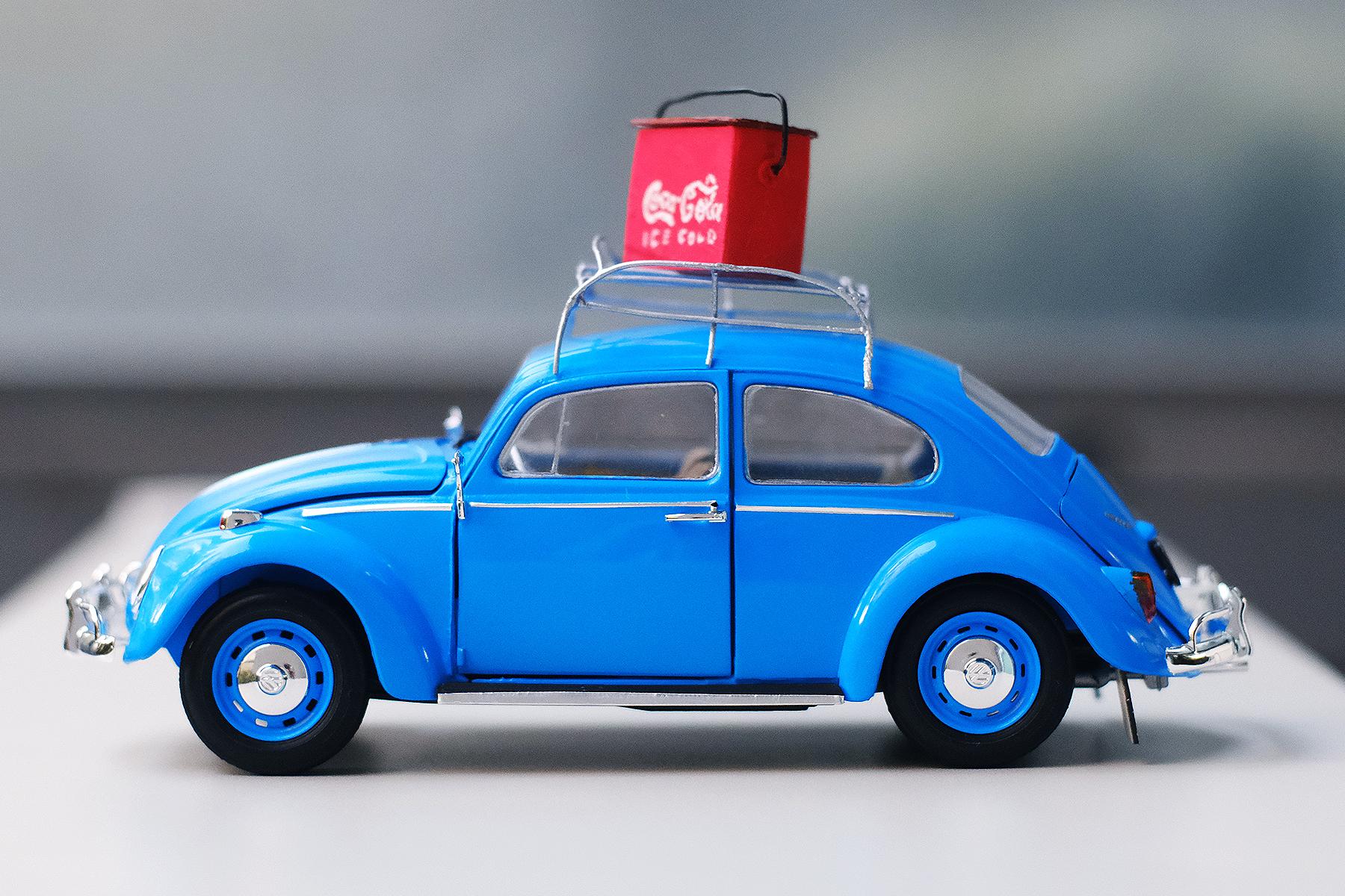

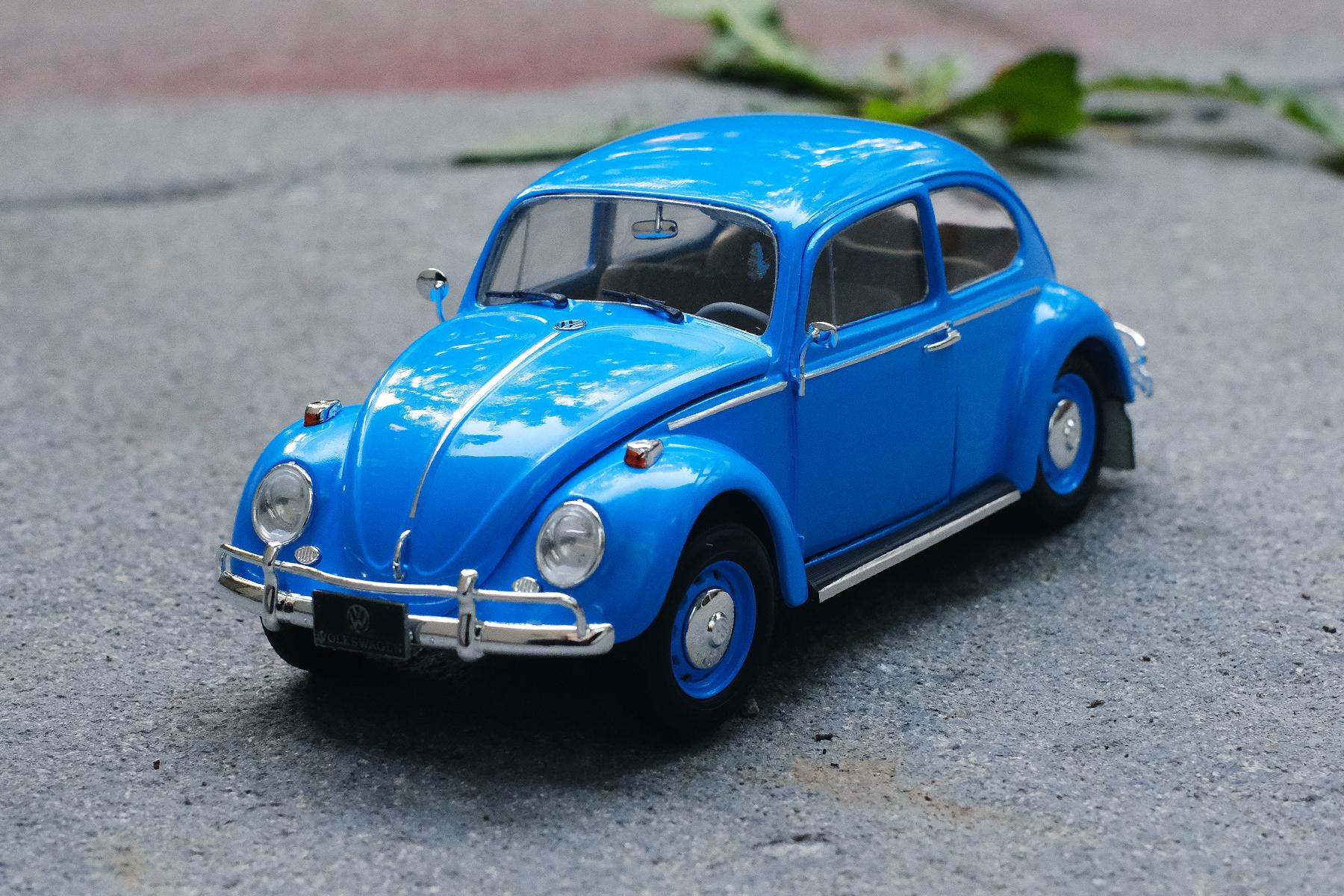

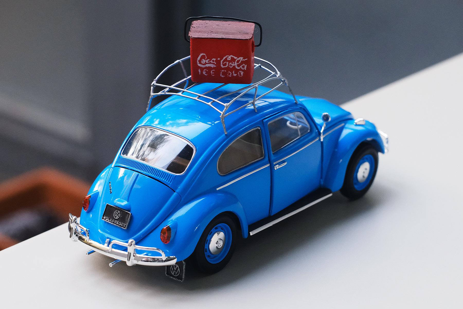

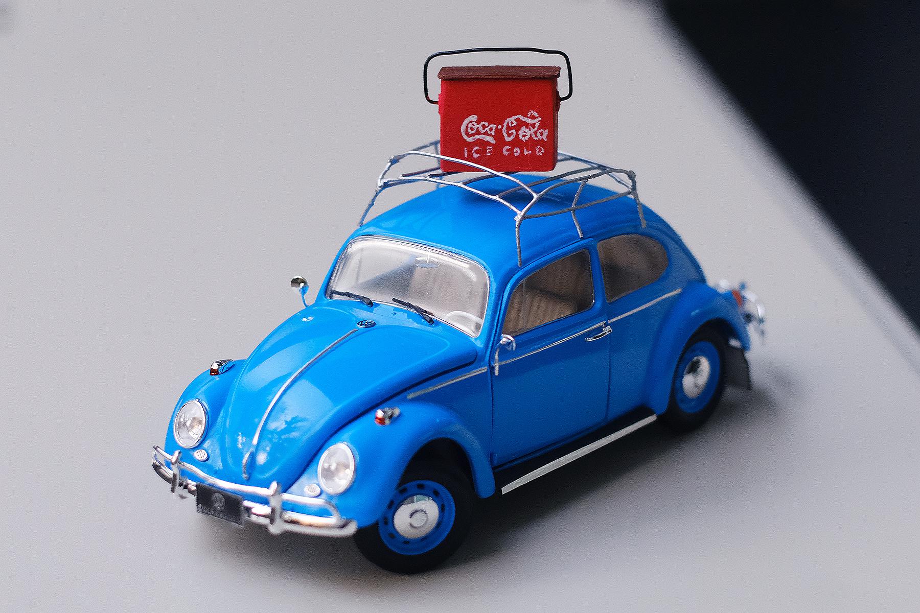

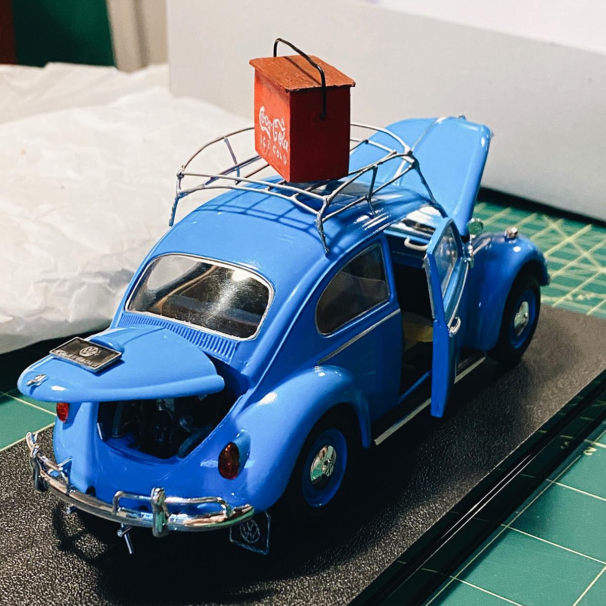

Back in 2010 I made a roof rack and vintage Coca Cola cooler out of styrene sheets and aluminum wires, then cut out doors, before stashing it away. Fast forward to 2020 I bowed to complete all the boxes that I had before buying any other new kit, and this is one of them. I painted with TS-10 french blue and TS-68 wooden deck tan, masked the windows and used BMF for other chrome trims. I really rushed making this one and ended up making decent amount of mistakes, but now I got rid of all the unopened boxes except for Fujimi EM Lancia Stratos, before going on another buying spree.

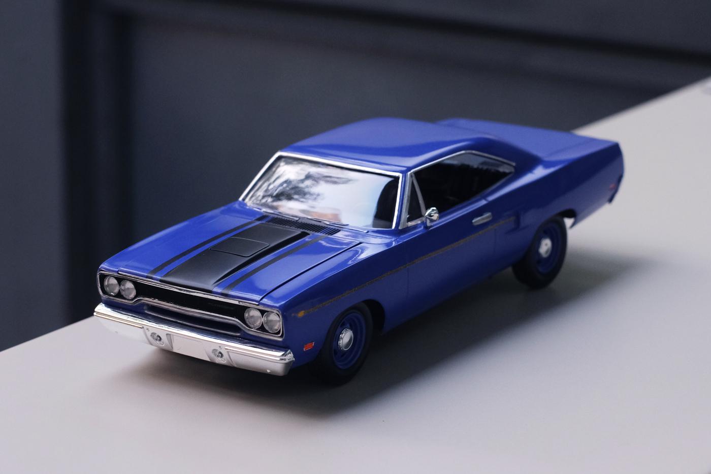

1970 Plymouth Roadrunner with 440 Six Pack (Revell Monogram 1/24)
e30lover replied to e30lover's topic in Model Cars

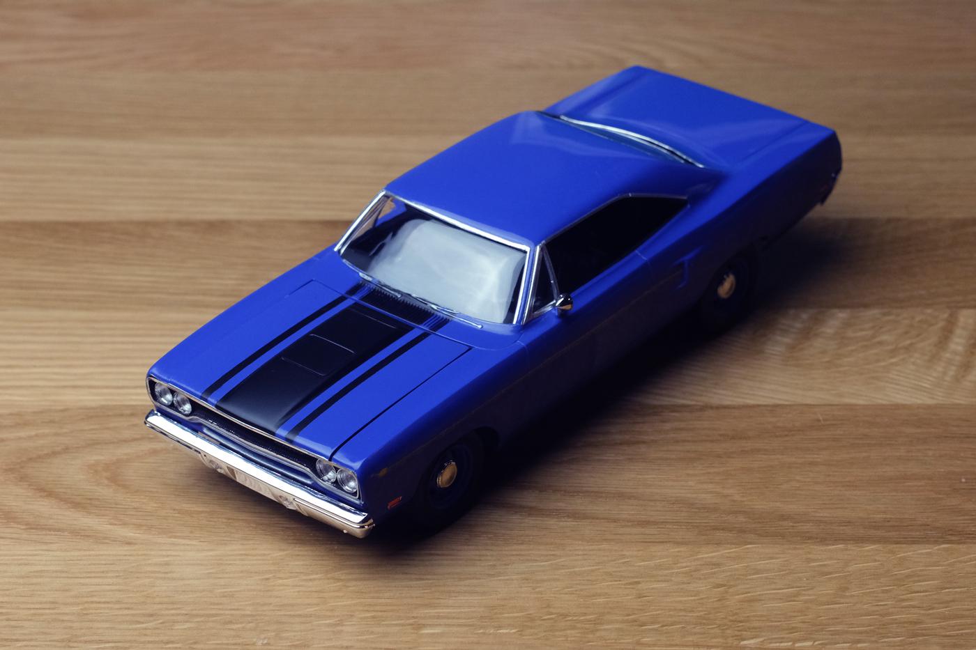

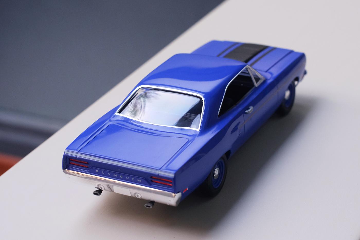

Thank you! Thanks, I had a 1/3 can left and this was the only kit that could pull that color off! Thank you! Thank you! Thank you! Jumping from 2000grit to polishing compound left some micro scratches, and I just bought 3000 grit sanding foam to fix that issue! Thanks. These 1/24 kits beg for extra details! Appreciate the compliment! Thank you! Thanks. The kit comes with two wheel choices (Mopar mag 500 wheels and stock dog dish) and I used the dog dish one. -

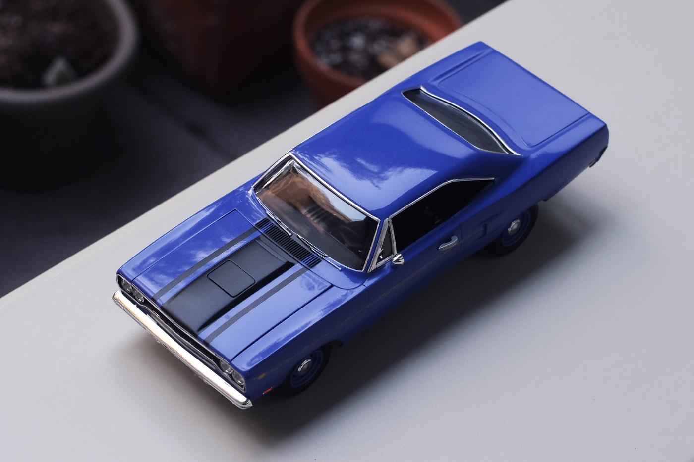

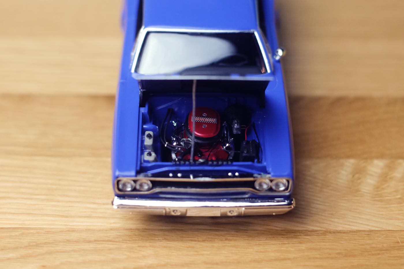

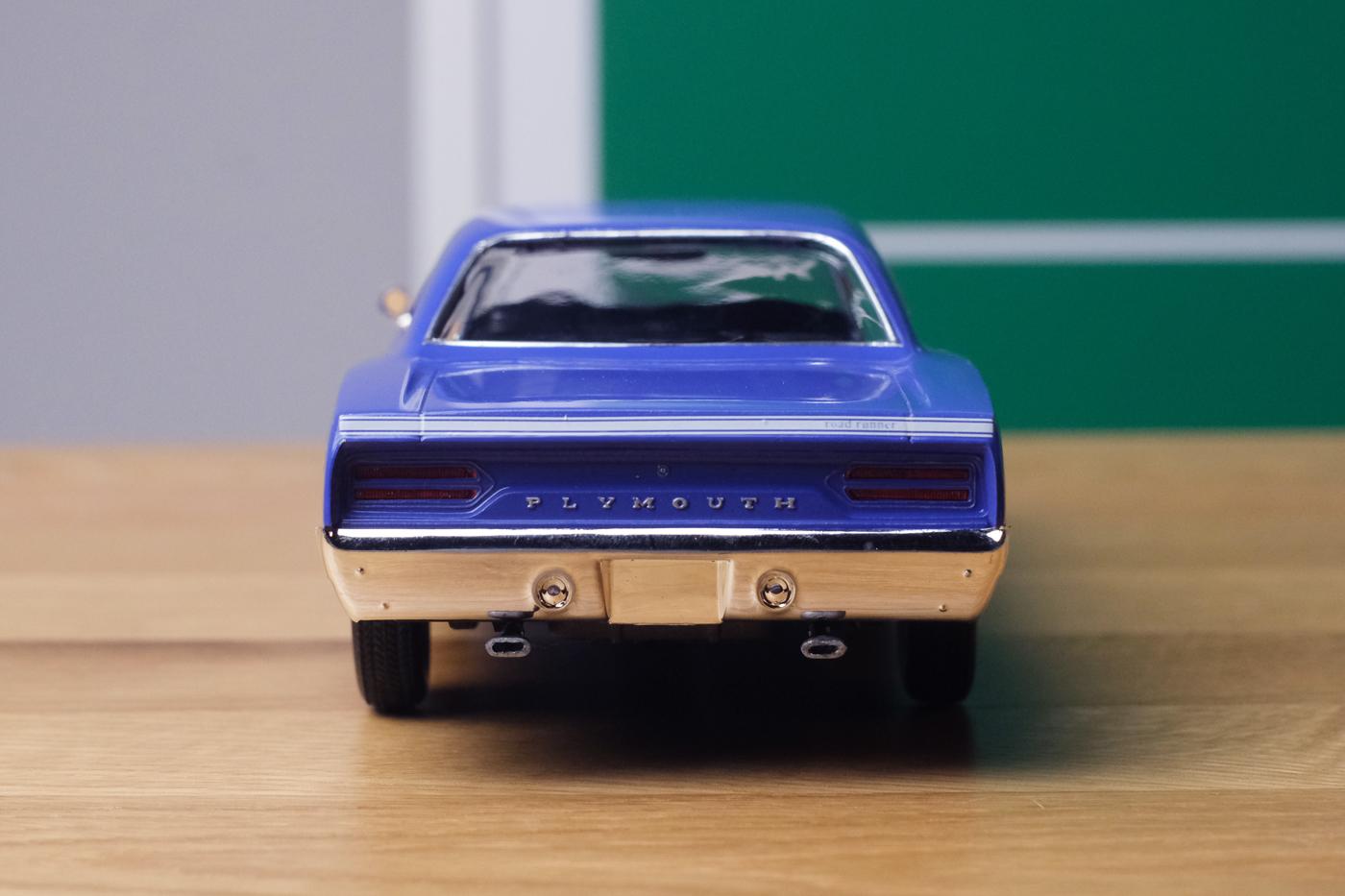

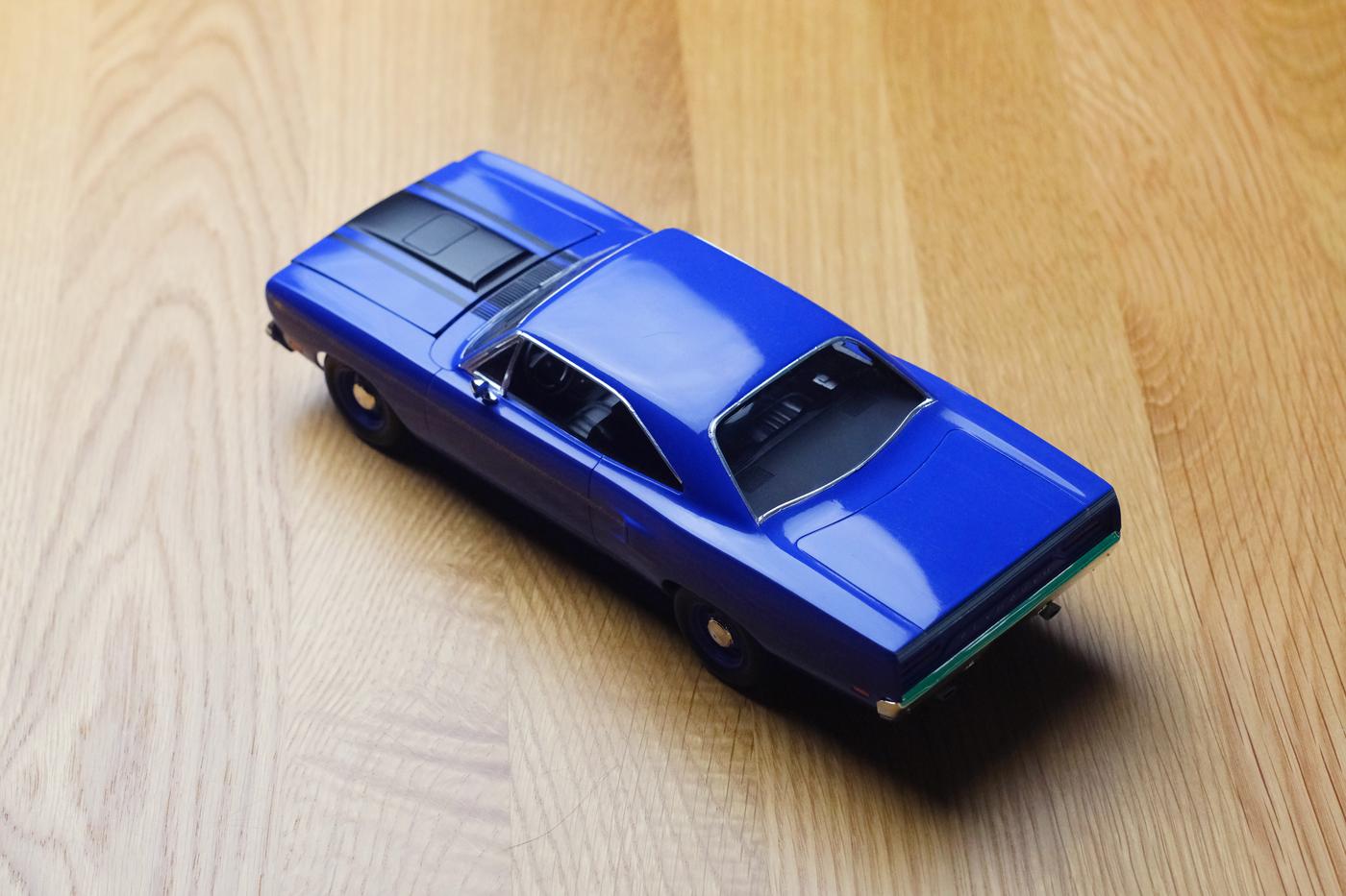

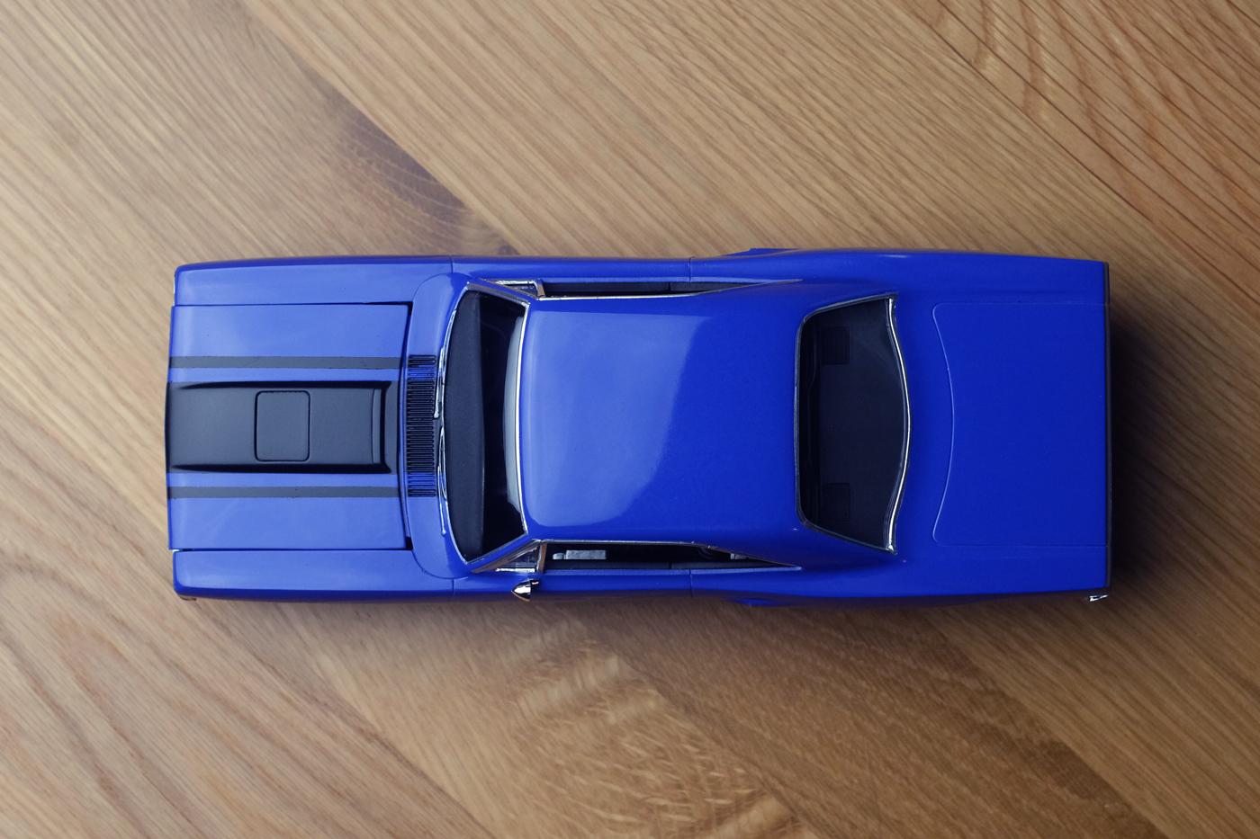

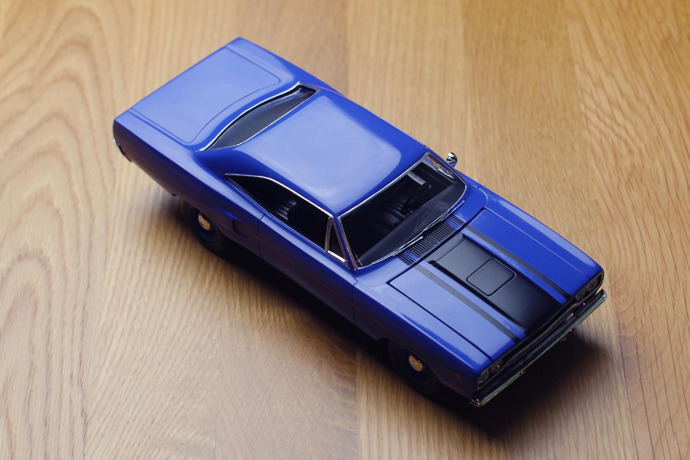

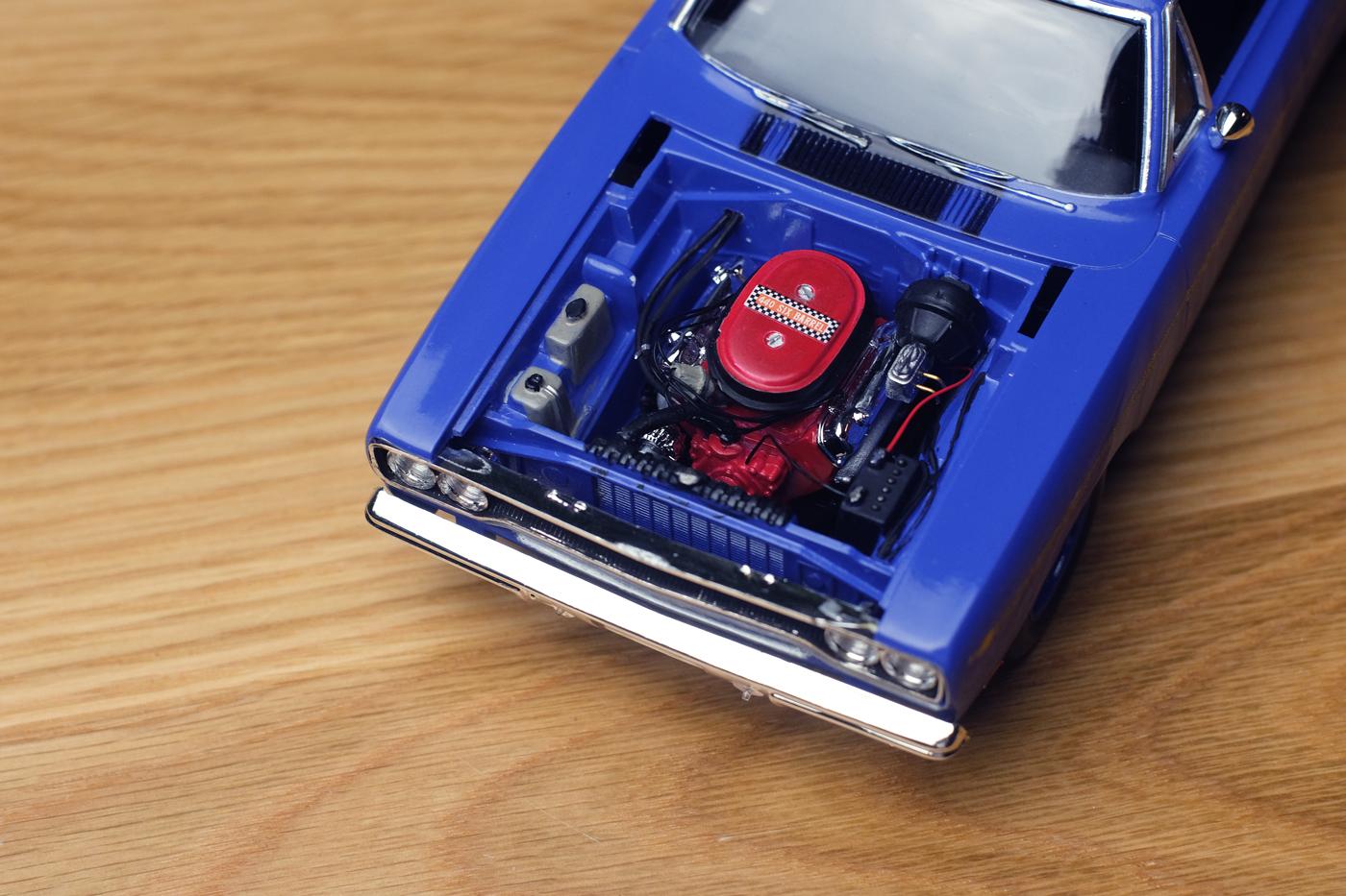

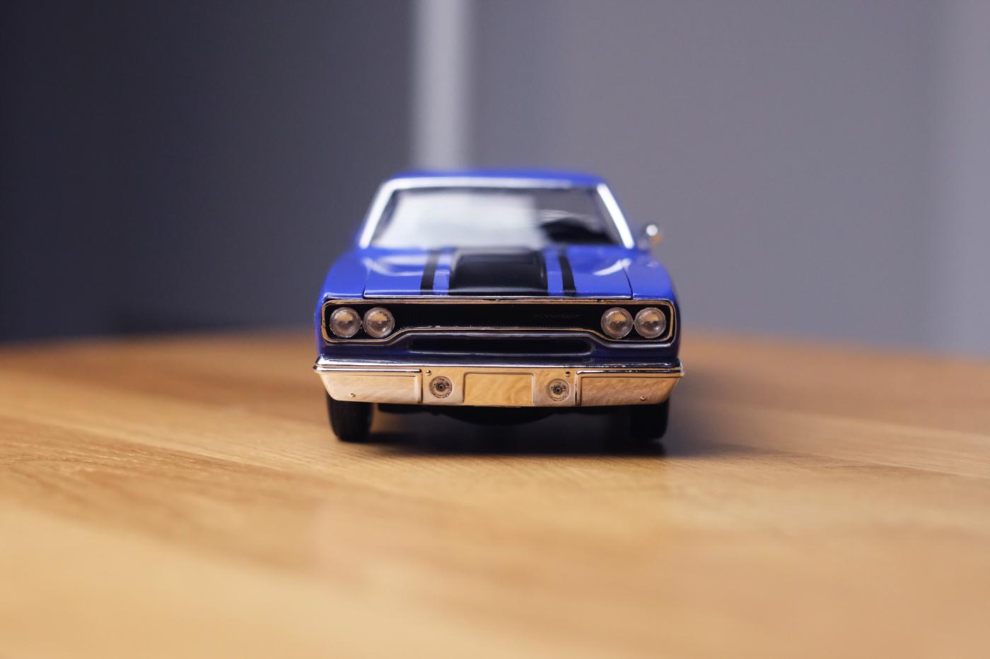

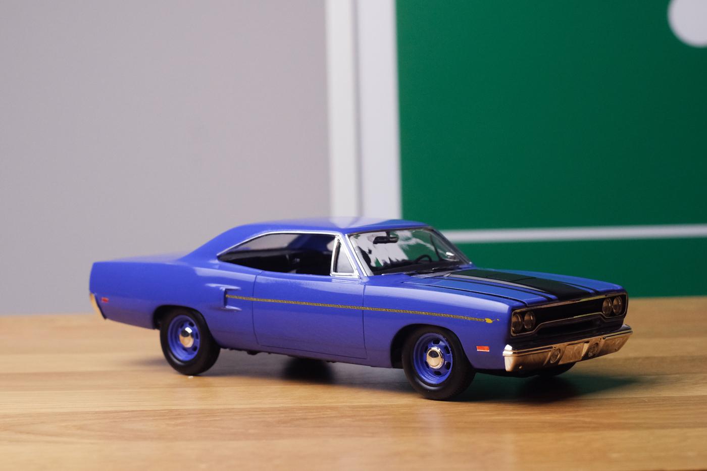

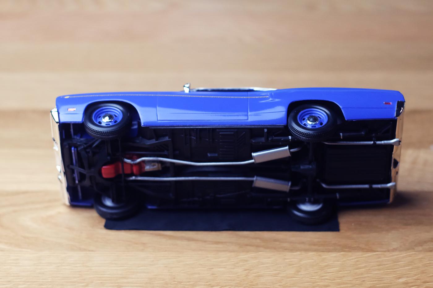

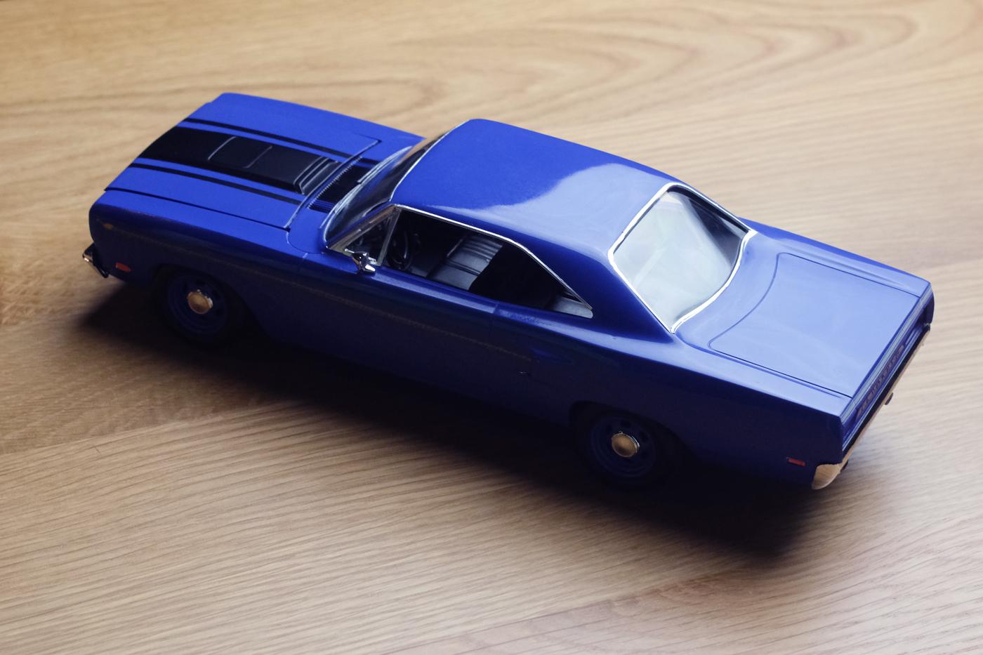

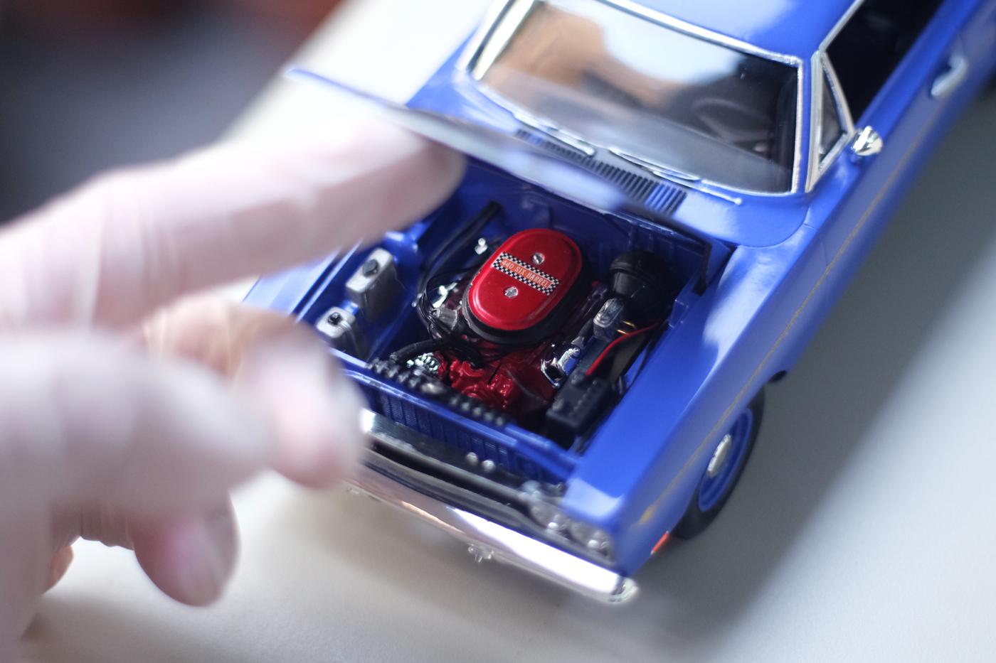

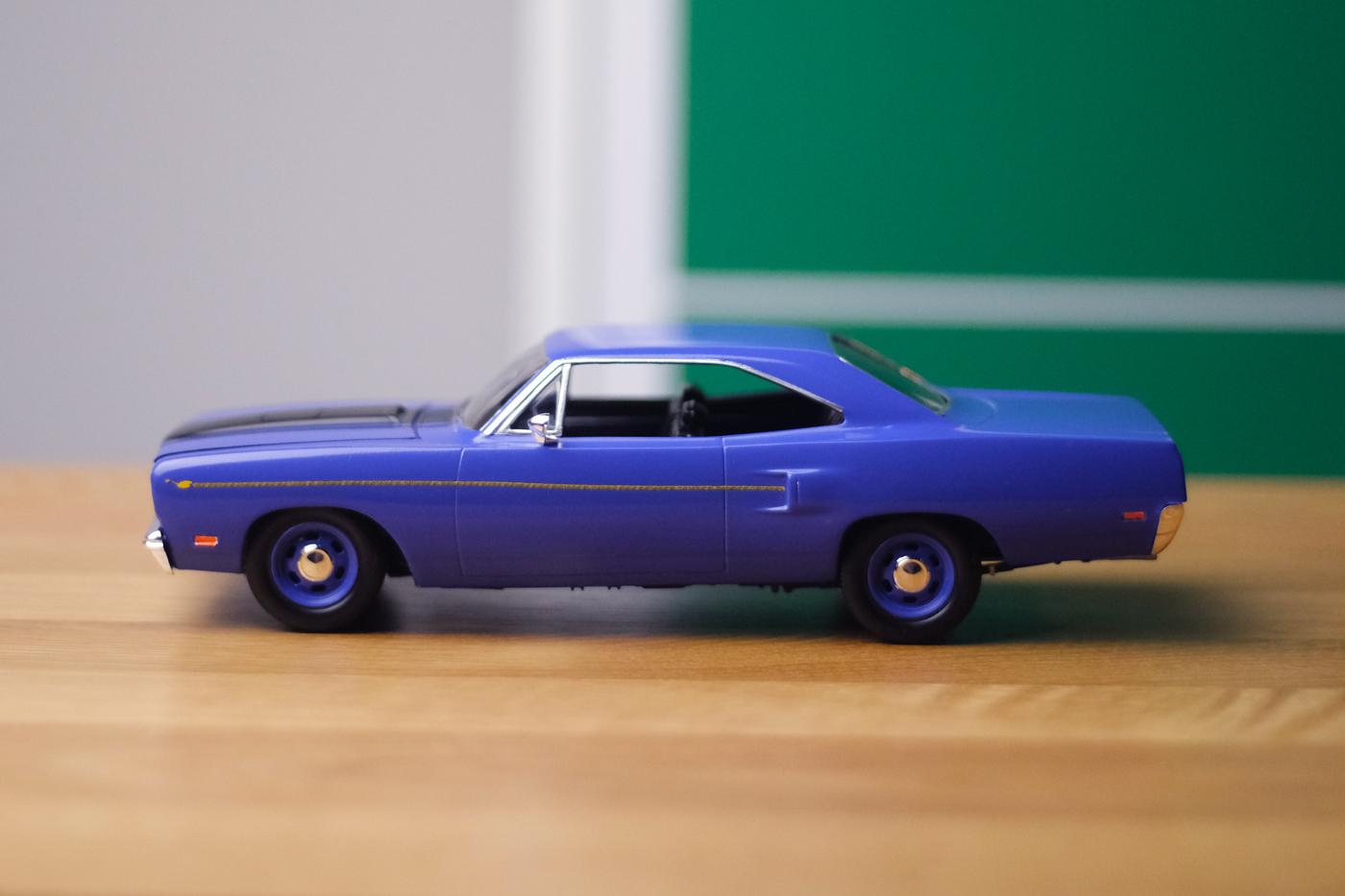

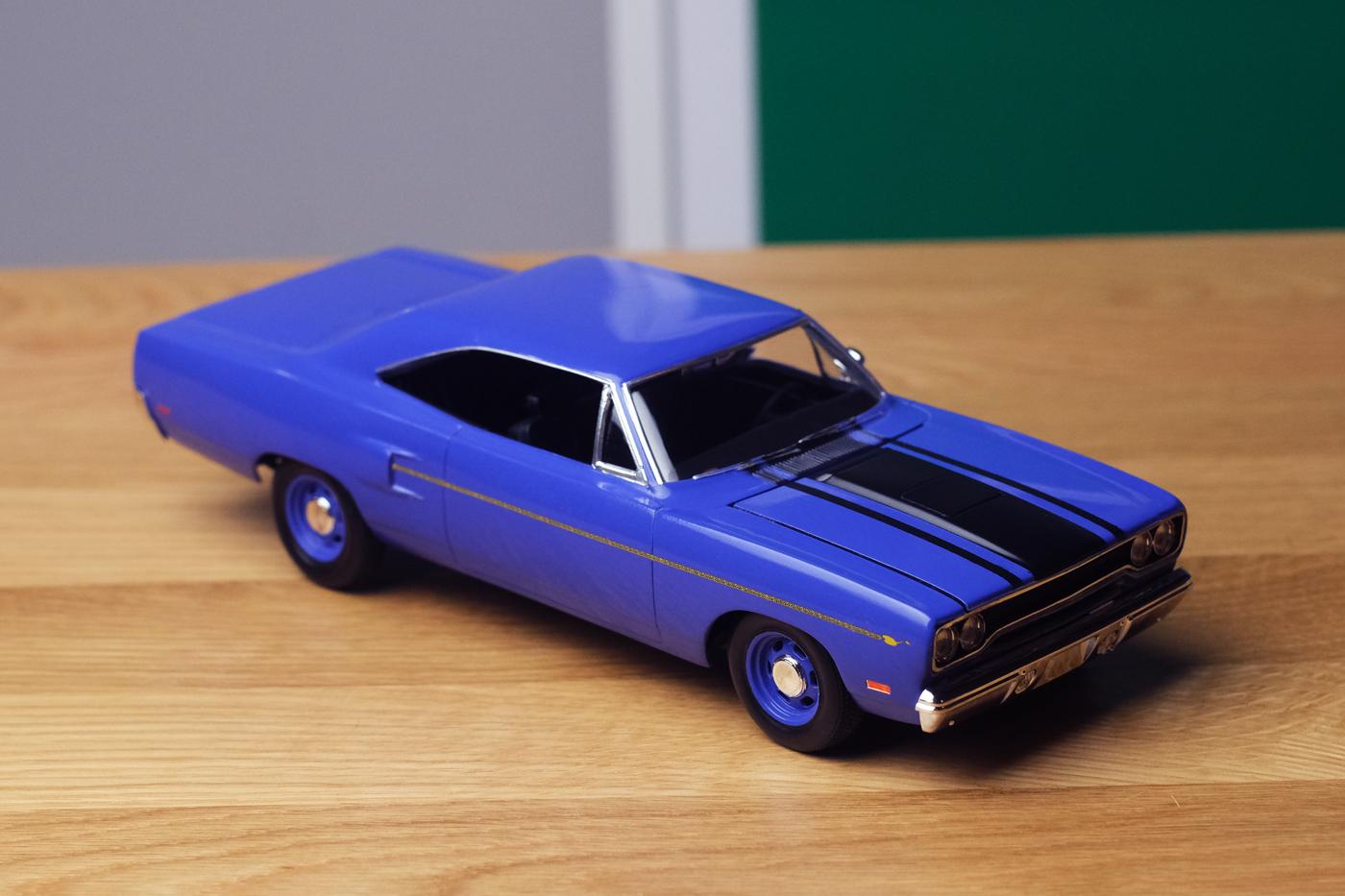

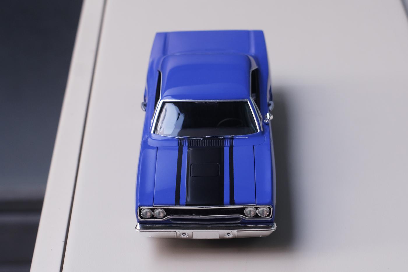

Hey all, I built the 1/24 70' Roadrunner (actually it's first Revell kit that I built) - it comes with 440 Six Pack, and I added missing hoses made of regular wires, 1/24 wires for ignition & battery wires, and used end of capsule bulb to mimic brake lines coming out of master cylinder. I cut off the molded door handles and sanded off chrome molding around wheelhouse was painted with Tamiya TS-57 Blue Violet and Tamiya gloss clear spray cans. The interior was painted in flat black then seats were masked then painted with squirts of gloss paint to mimic vinyl material. Hope you enjoy!
