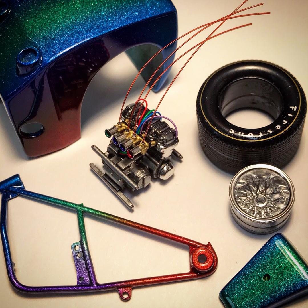

Here is one i just wrapped up... mostly/somewhat out of the box...well for me... haha
  • All the kit chrome was stripped and redone with molotow.
  • Front fork reconstructed out of brass
  • 1958 Impala headlight and tailights (frenched)
  • Painthuffer metalflake .004 Micro Silver flake basecoat with 4 colors of the splash paints candys faded together.  Candy fades done with Badger Sotar 20/20 airbrush with fine tip.

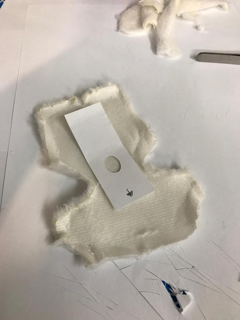

  • Dollar Store stuffed dog hair interior lining, detail wire piping and photo-etched bolt head "buttons"   The bolt heads were colored red with a sharpie before application.
  • Red transparent fishing line for fuel lines, and various RB motion, and photo-eched bolt heads and washers.
  • Front wire wheel is a toms modelworks photo-etched center with custom lathe turned rings
  • Rear wheels are from a testors/fujimi ferrari modified with rings for extra depth and topped off with lathe turned brass bullets
  • Exhaust mostly reconstructed from aluminum/brass tube

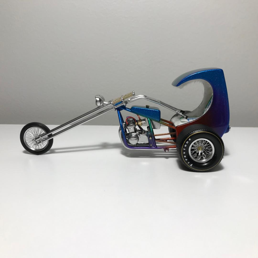

Finished photos
8EFBDB12-9F55-4F8E-AB37-78A6365CED29.JPG.c9d79e28039a7c259e4911760f6aaa0b.JPGA79342A4-49B1-4003-9A90-E49635558D41.JPG.190c116e3d8530471cbfcdf6646e0391.JPGIMG_1113.thumb.jpg.b3cbaff67fc4b5e108d0c1b657d27caa.jpg627AFDC0-AB50-4E50-A403-CA99548480F5.JPG.d164be2a3e7998fb321cdbf74ca00f6c.JPG

I saw this at the CARS show. Pictures don't do it justice. I really need to get this kit. Yours is absolutely KILLER!
HOLY SH...
That's one fantastic bike! It reminds me of the show bikes I used to see at the London (Ontario) Autorama back in the day (like '79 to '86)!
Unreal work, my friend! Inspirational and nostalgic all at once!

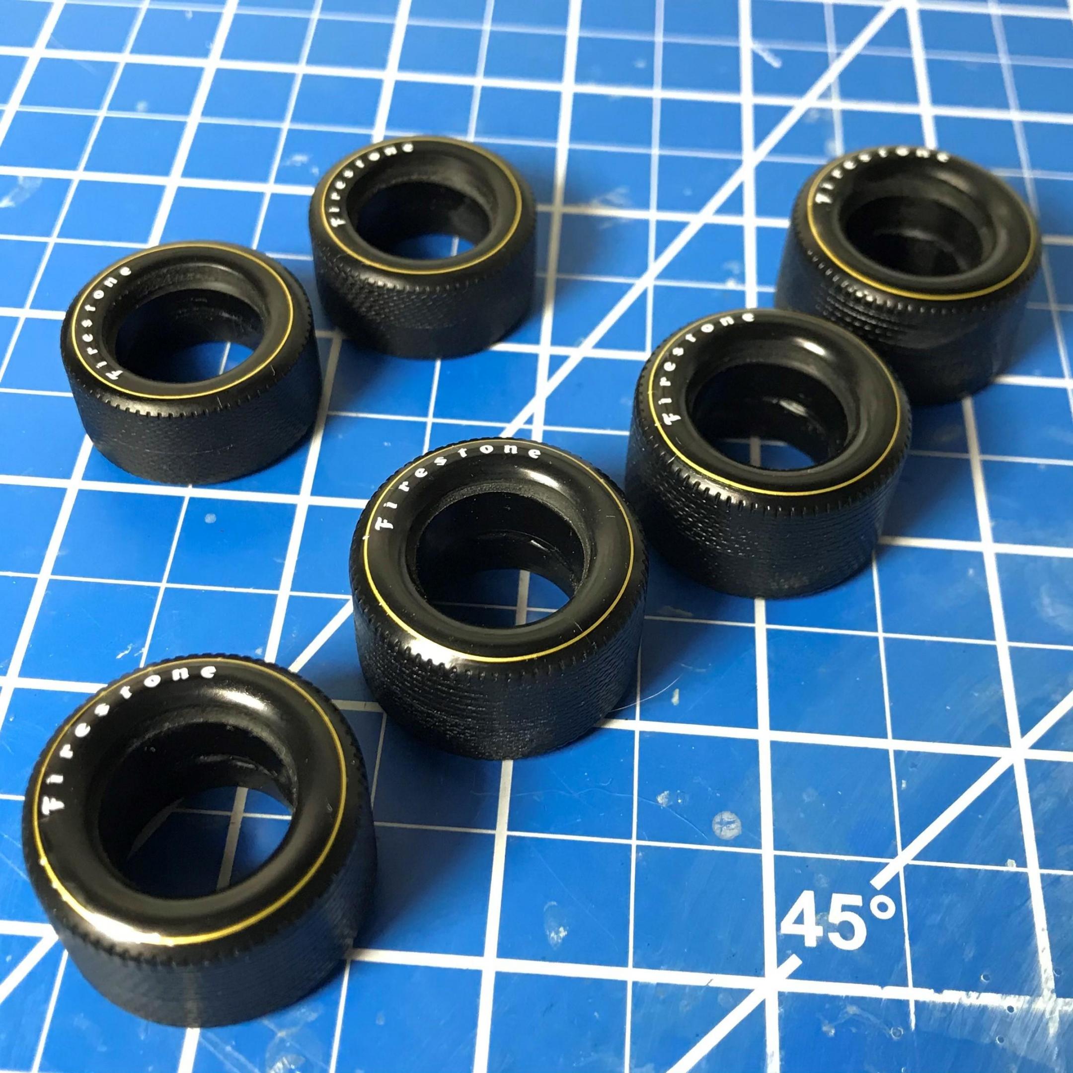

Are the gold line and lettering on the rear tire dry transfers?  They look clean and sharp.

The tires are dirt track items that come with the gold line decals, they are extremely delicate and hard to keep round when applying.. but look so good when done...
https://www.modelroundup.com/product-p/ppp-grfm.htm
(note: they come with one small pony tire, so for a true set of bigs and littles you would need to buy 2 sets, and you will have a couple extra bigs)
