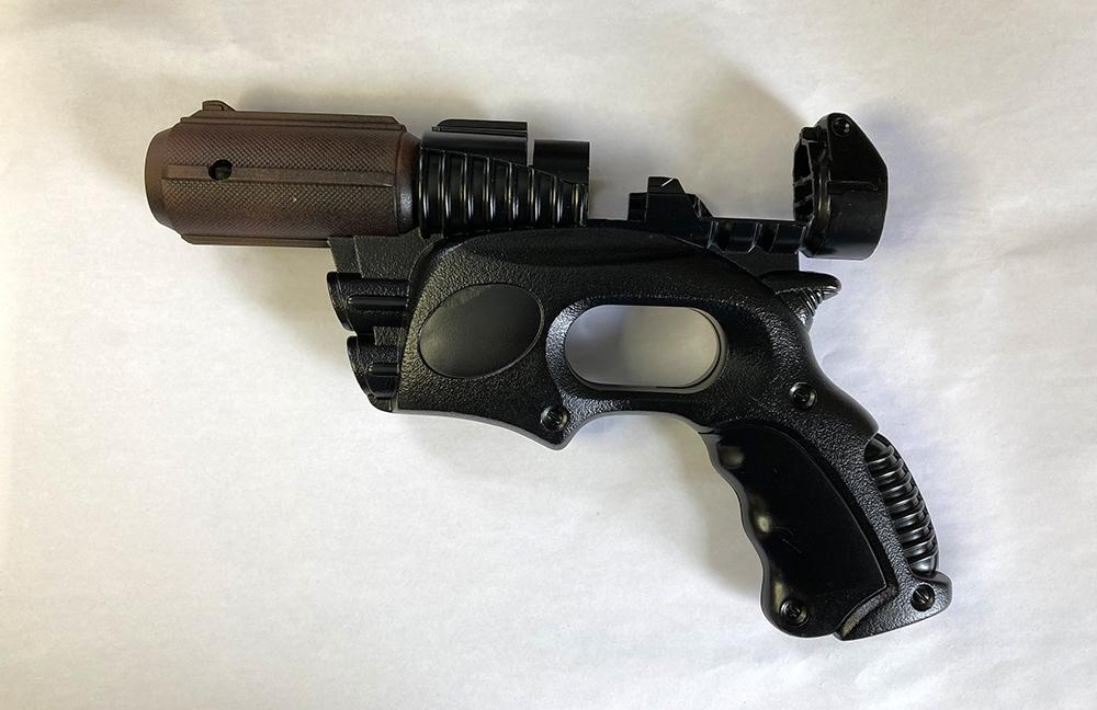

Lunajammer Posted May 1, 2023 Posted May 1, 2023 While doing a Nerf gun sci fi blaster conversion, I wanted a REALLY flat black, so I used Rustoleum 2X ULTRA MATT. It was ultra-not-very-matt at all. Semi gloss at best. In this case everything worked out fine, but buyer beware.
