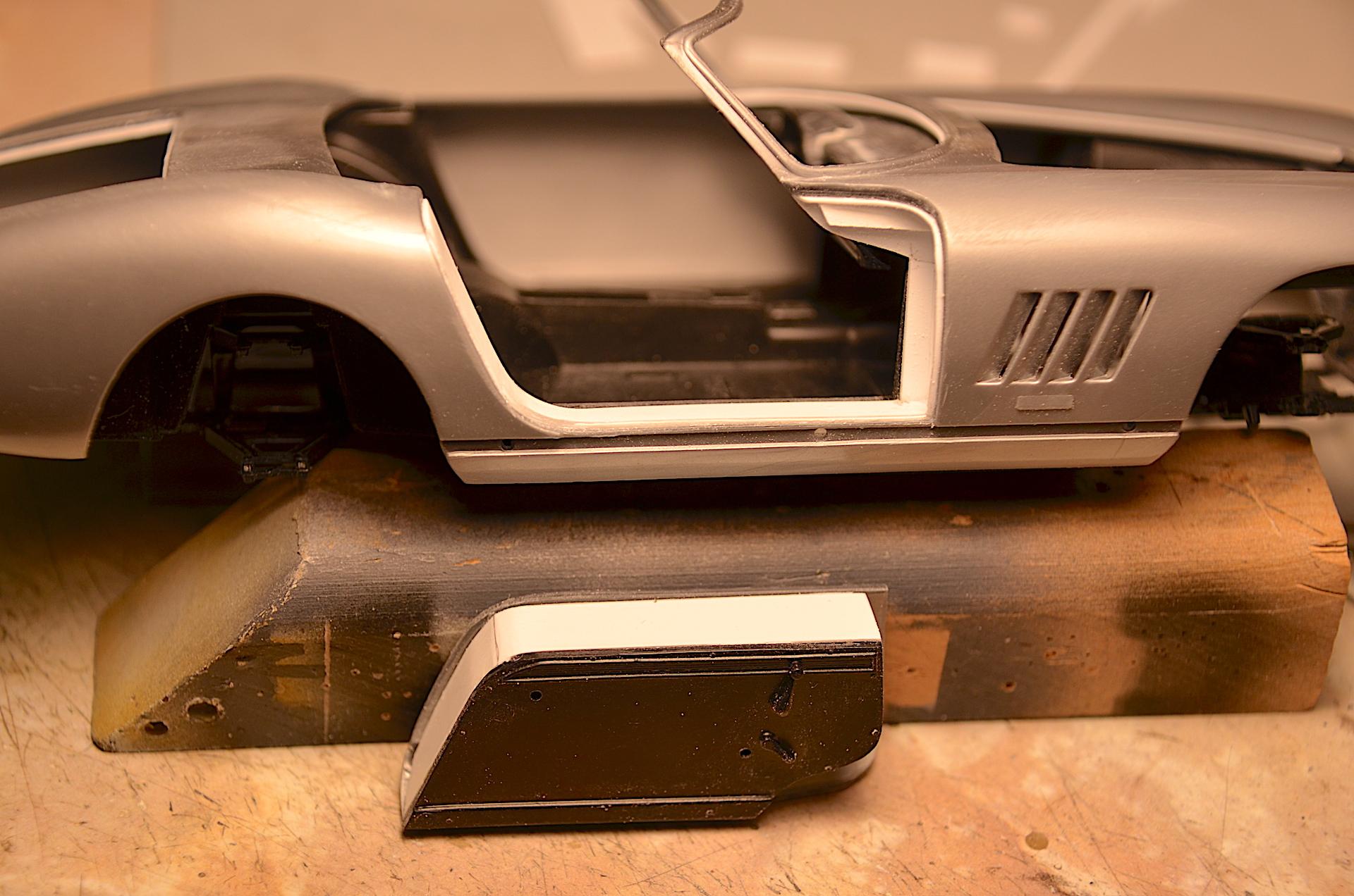

That's not scaring me. But something else came up.... Glued in the transaxle. But it rises up through the plane of the trunk floor I added. Wouldn't be an issue otherwise. The easiest solution is to grind off the top to clear, don't tell anyone! ? Brush painted the steering wheel rim. Wanted to simulate the aluminum sandwiched between the wood. Added the aftermarket horn button. I wanted to take a better picture of the pedals and footrest. Can barely see the tiny prancing horse on the consul. ? The last scratch-built section, the driver door jamb! Wanted to show how gawd awful ugly this step is. ? We always show the finished product, but not the meat grinder part. Superglue with baking soda, very important to wash before painting to check for tiny holes.
