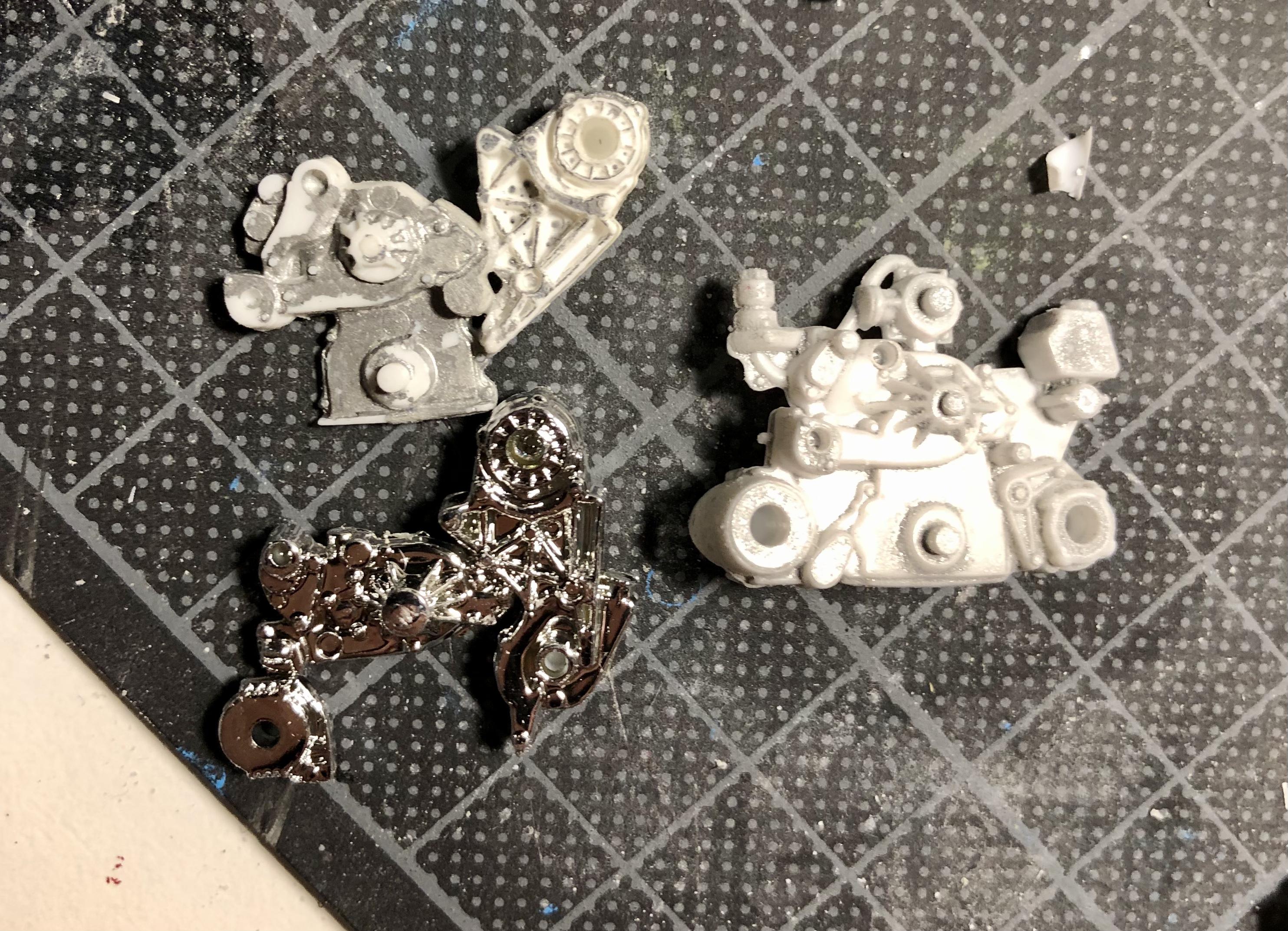

Ok, so i create this content mostly because i am confused. When building my 1971 Cuda and wanted to swap some other parts to it from other kits i noticed that the Cuda engine is huge. Had to do a comparison on my different available Hemi Engines. From the top #1 Chevy LT5 1/24 as refference. #2 2JZ inline 6 tamiya 1/24 as refference. #3 What i found in my 1971 Cuda kit. 1/24 scale #4 1/24 F/C revell Nitro methanol Hemi #5 Parts box 426 with manual gear box, this engine is most likley from 1/25 1967 revell Charger. Engine L Head L Gearbox L Cuda. 28mm 25,8mm 32,8mm FC Hemi. 23,1mm 22,4mm Revell 1/25. 22,6mm 21,7mm 35,5mm Doing the scale math on the 1/25 revell engine wich i belive to be quite accurate since the kit came out in 2000. A Heami cylinder head should have a length around 542,5mm wich in 24 scale would be 22,6mm wich is close to what the FC Hemi has so far so good. But then the cuda engine is 3,4mm longer, that would be 81mm in 1:1! This makes me come to the conclusion that the Cuda engine actualy is in 1:21 scale. Body wise seems ok being a 1/24. Whats your thoughts on this topic? I will proabobly end up putting the Revell engine in it since it in my opinion looks more right than the original engine. Best regards Anton -

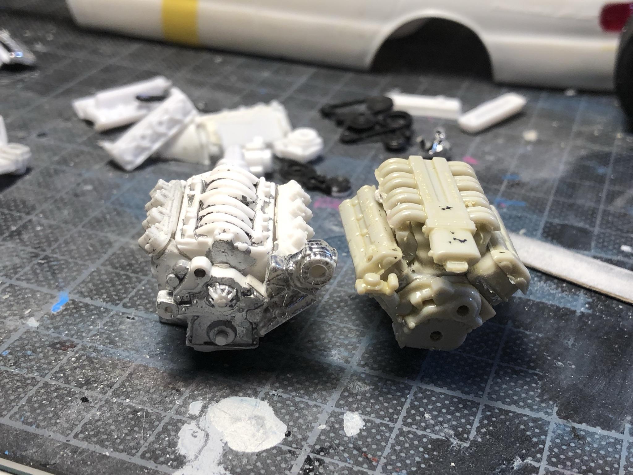

I think that i have decided on engine. The monogram ZR1 engine and the AMT one is almos identical in length, just that the Monogram is way better in detail. And if remember correctly.. I already mocked up this engine back in the day for this build. I have two issues though, one head seams to be glued on not straight, and this being a glue bomb engine its not easy to se where it should have gone, but i might use the PE blade and cut them of and glue them back better aligned. O and the serpentine belt is wasted... will have to make some thing about that. I cut the manual trans of and installed a TH400 from the AMT´70 Monte Carlo low rider kit i have, much more dragracing friendly than ZR1 trans. Have also been playing around with the front part of the frame, more on that in an other post when its there. The supercharger in the mockup is equivalent to a Procharger "12 for race use only
