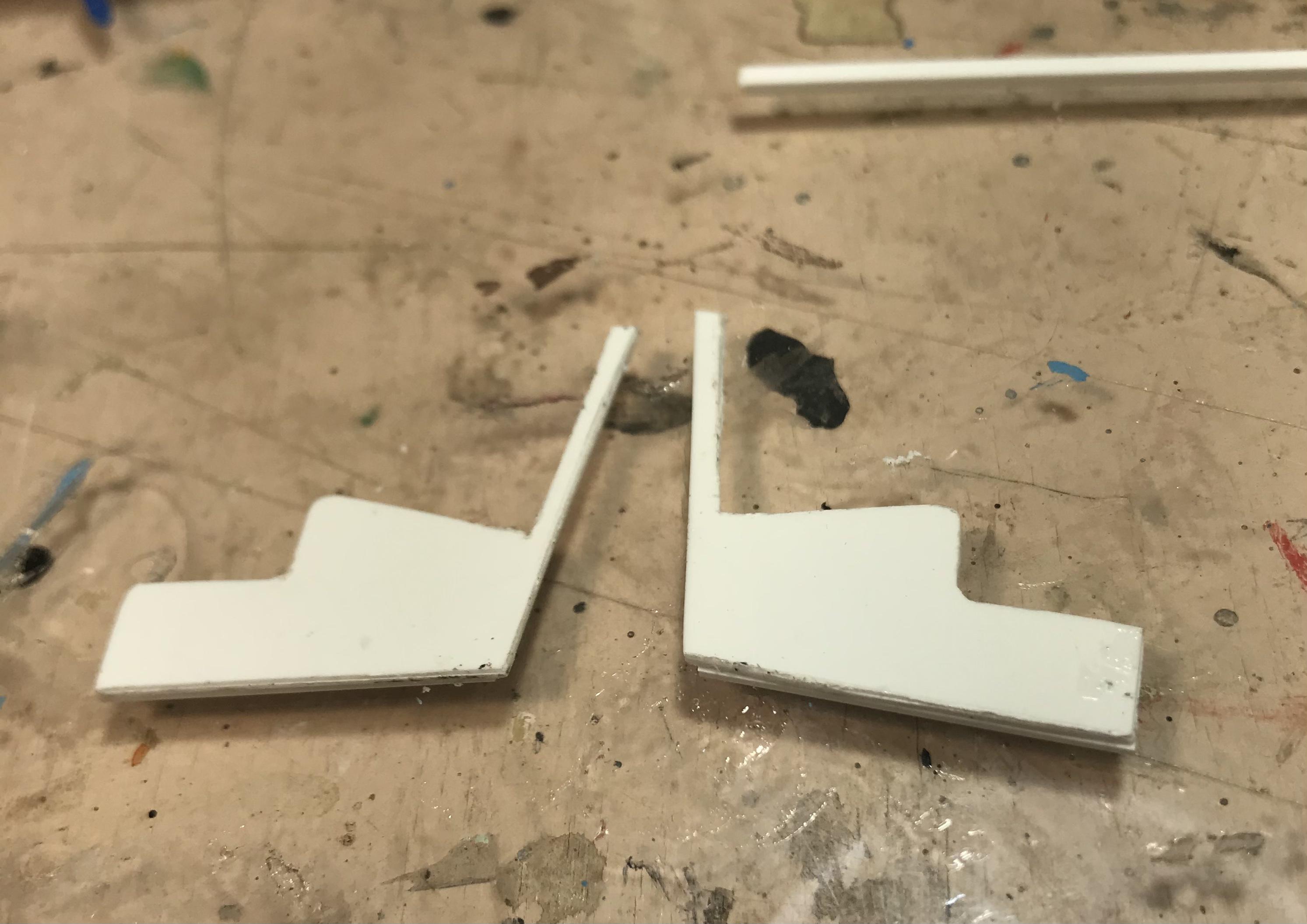

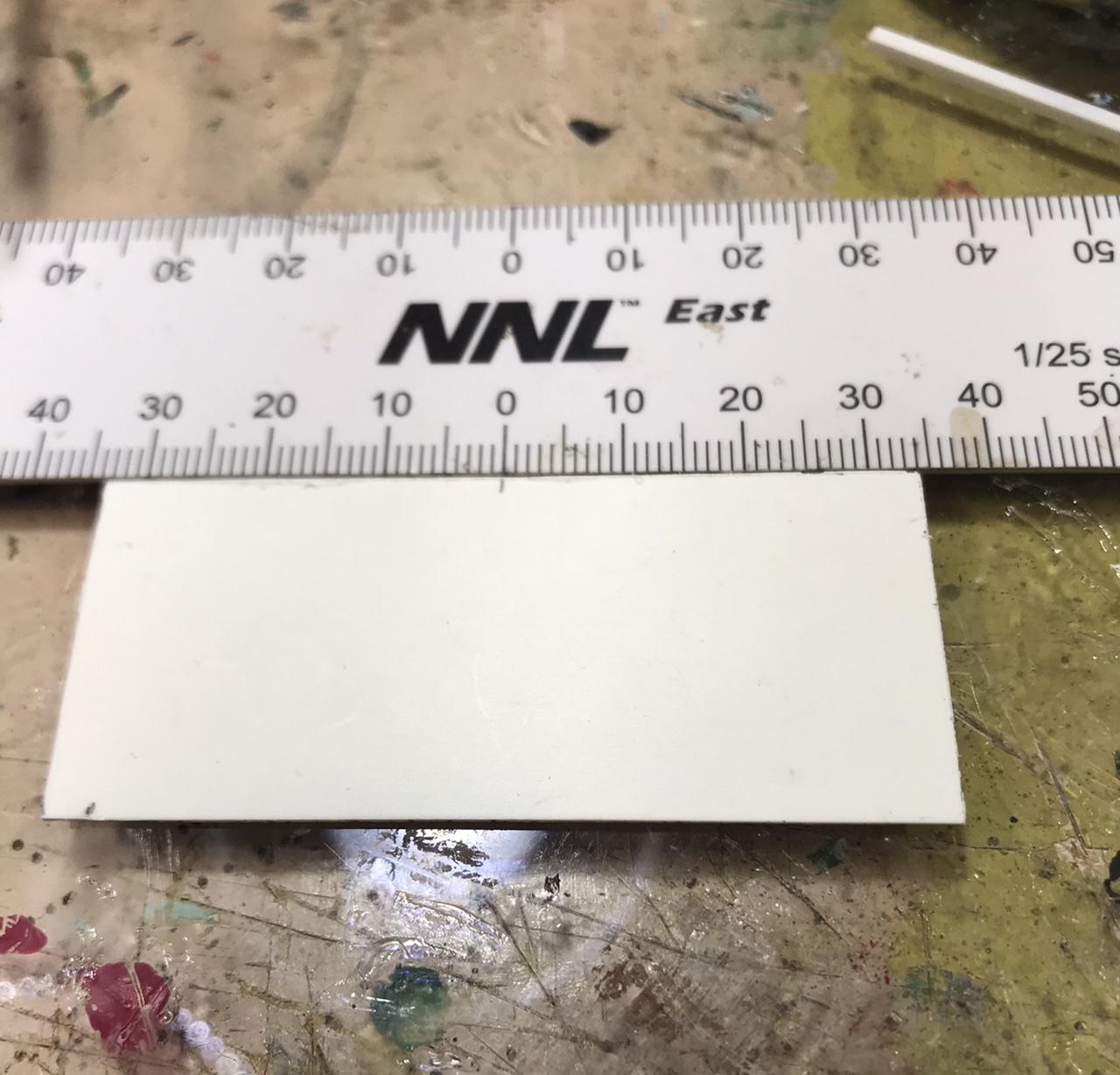

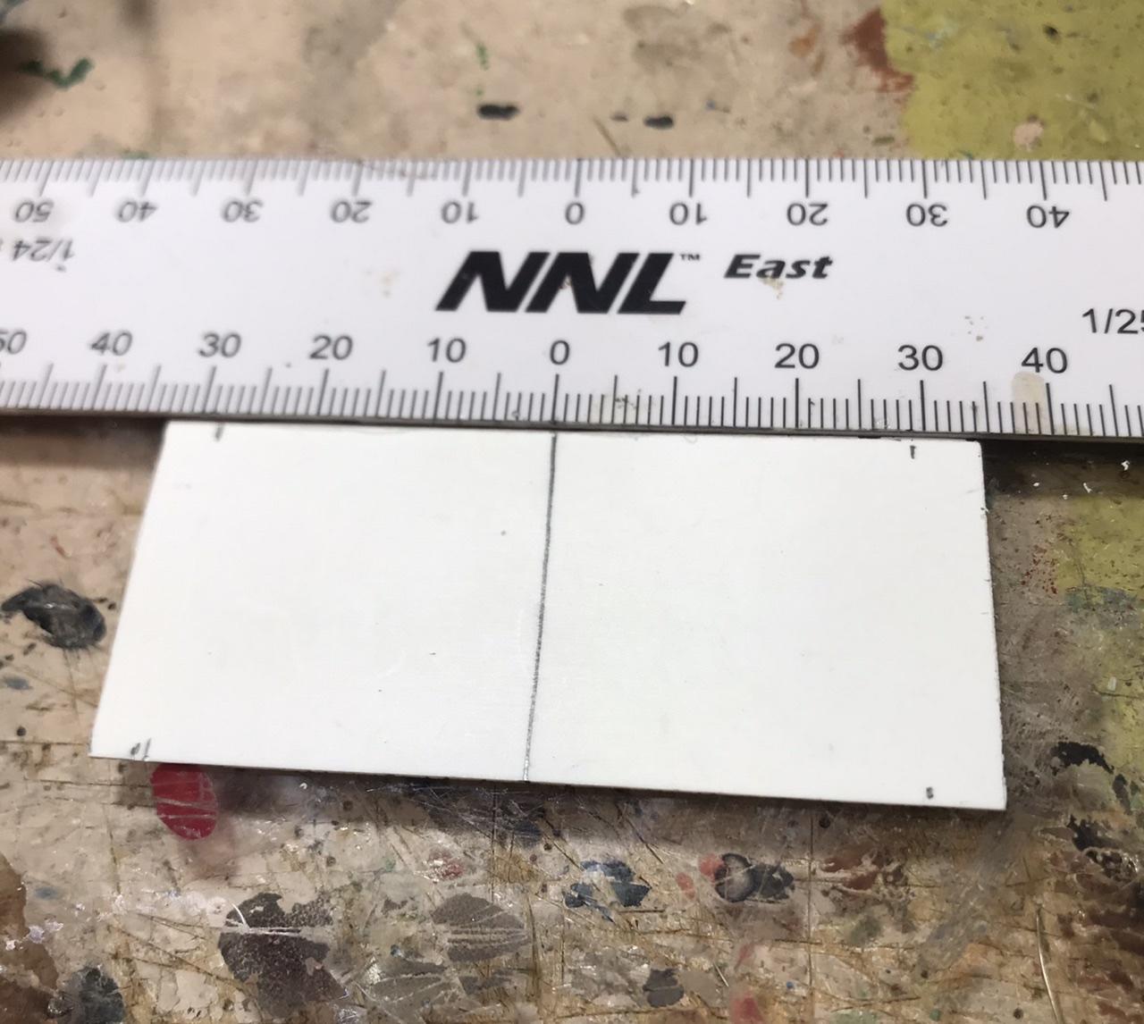

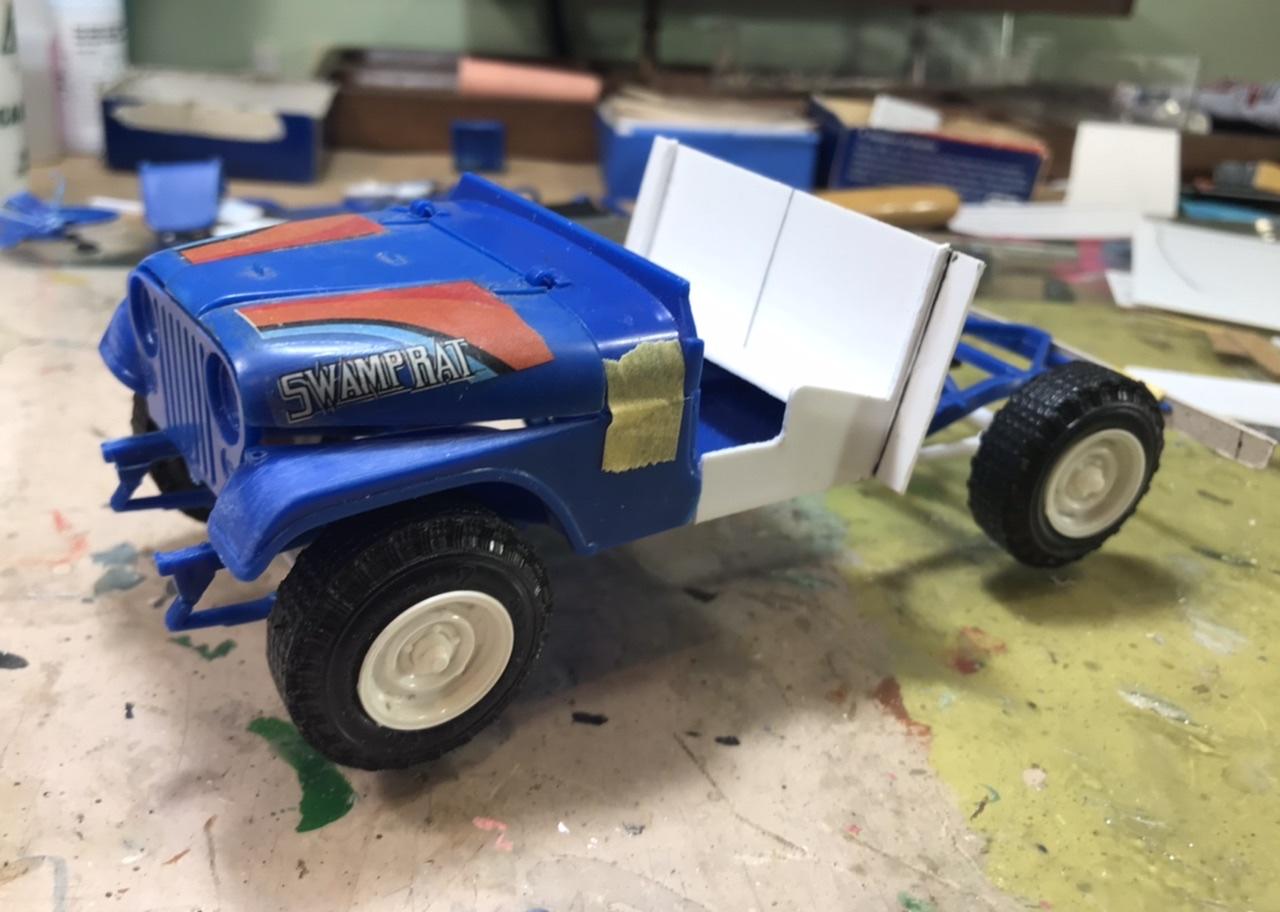

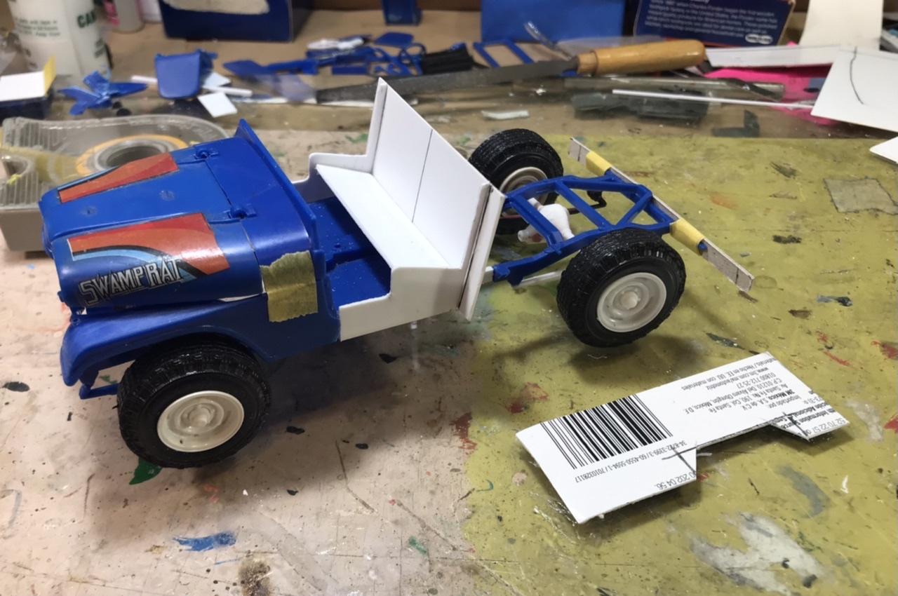

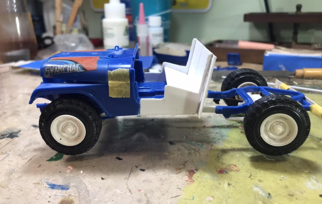

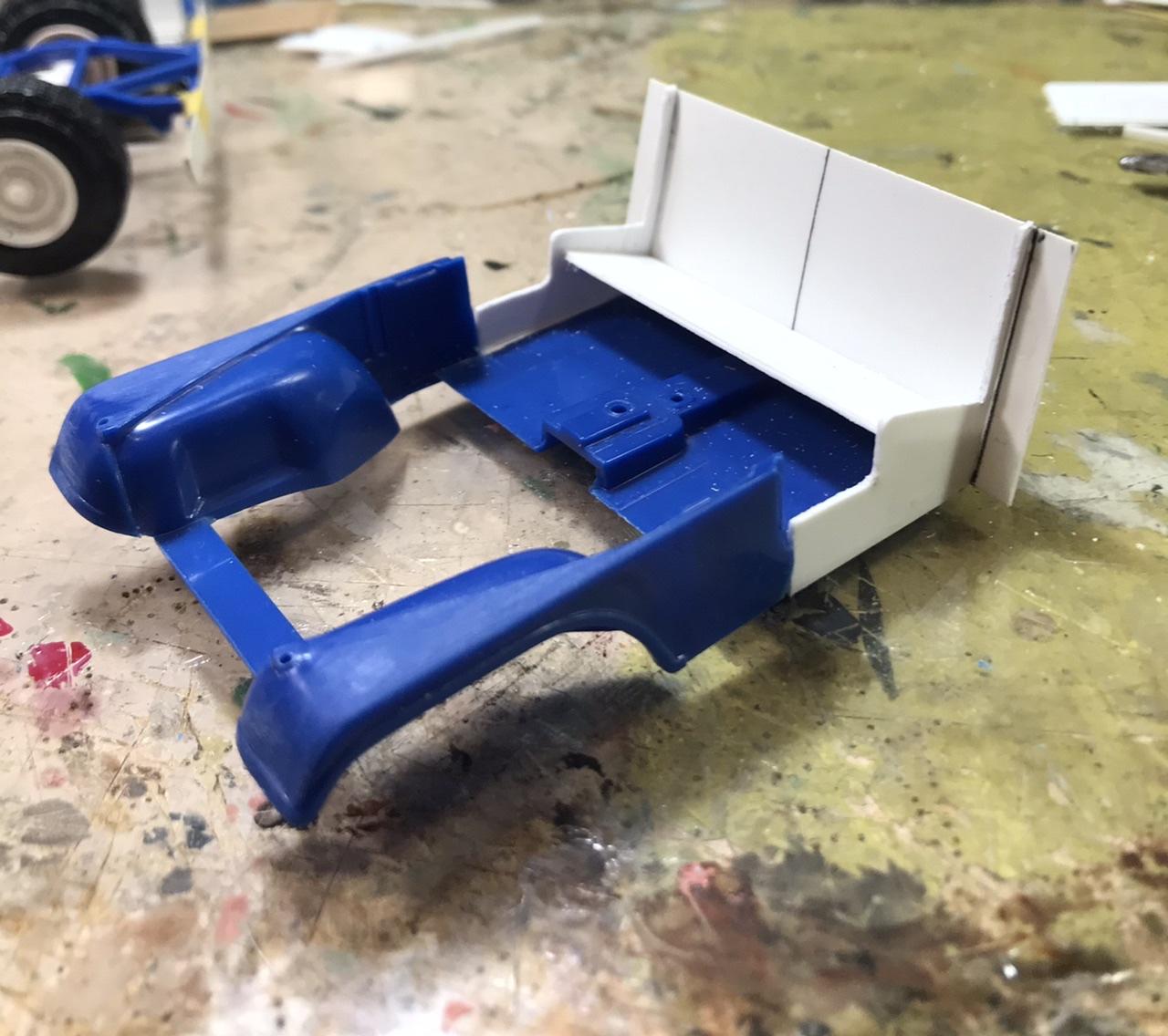

That would be great! I may go snoop around Google Maps some more! It would be an incredible score! Some more work today. I have the entire box worked out In cardboard and 1:1 dimensions. I prefer to work in real world dimensions from my years designing and building office space. I’ll go through this bit of progress in detail, hoping folks will find it useful. If not I’ll go away! You already saw my cab side panels so here’s the back panel. The main pieces are all .040” Evergreen sheet, their item 9040. There are two 6” x 12” sheets to a pack. Cost about $3.50 so not all that expensive, but still I work my patterns in cardboard before committing to plastic. I measured the new fabricated body width as 68” across. So in the above photo you see the panel was cut to 68 scale inches. I used my nifty centering ruler to mark off the center point. We will be working all of our dimensions off the center. Note that I had determined the height of this panel needed to be 30” as it is parallel to the windshield’s bottom glass edge. I measured the Jeep’s width at 58”, giving the rear box 5” wider on each side. Here we have measured that off. The cab side panels I cut off were a bit thicker than the .040” plastic so I added a bottom edge to them. Once that dried, I was able to center the back panel right in place per the measurements I drew on it. The metal bench seat was one of the things I found interesting on the truck! That was easy, since it fit between pieces. I just measured off what I needed and glued it in place. Next step will be making the rear bed box. I have the pieces all templated in cardboard, and I was waiting for that angle to be defined at the front of it. The parts may not be perfect, but I’m having fun! -
