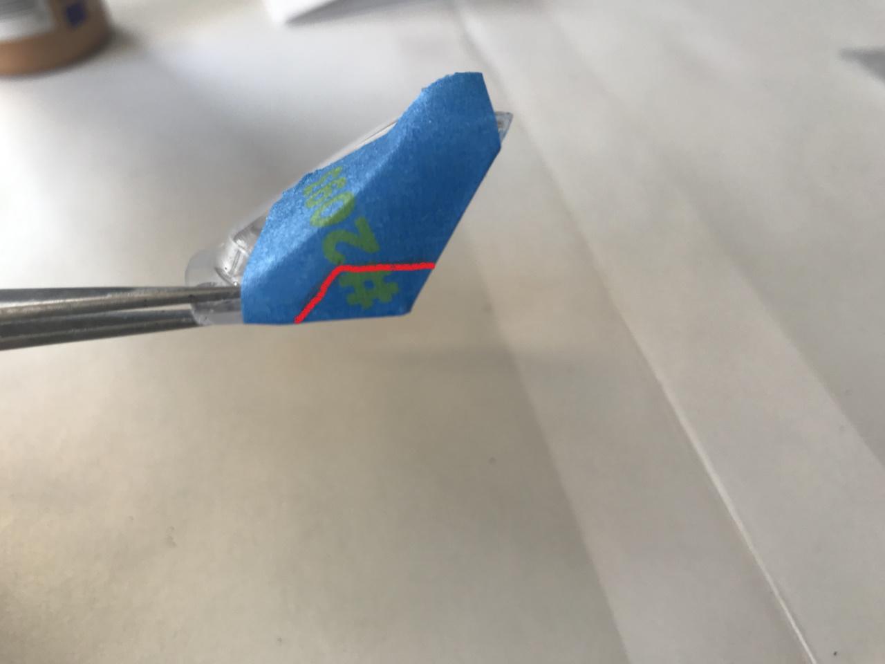

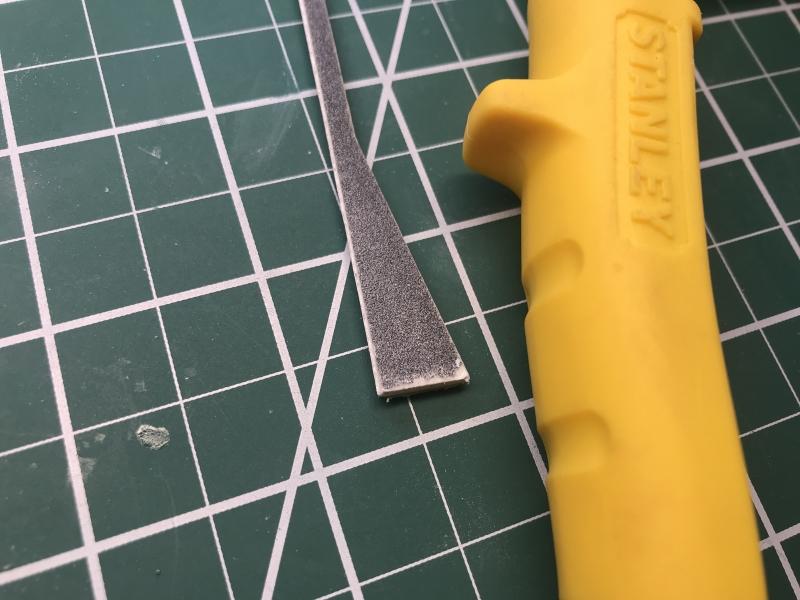

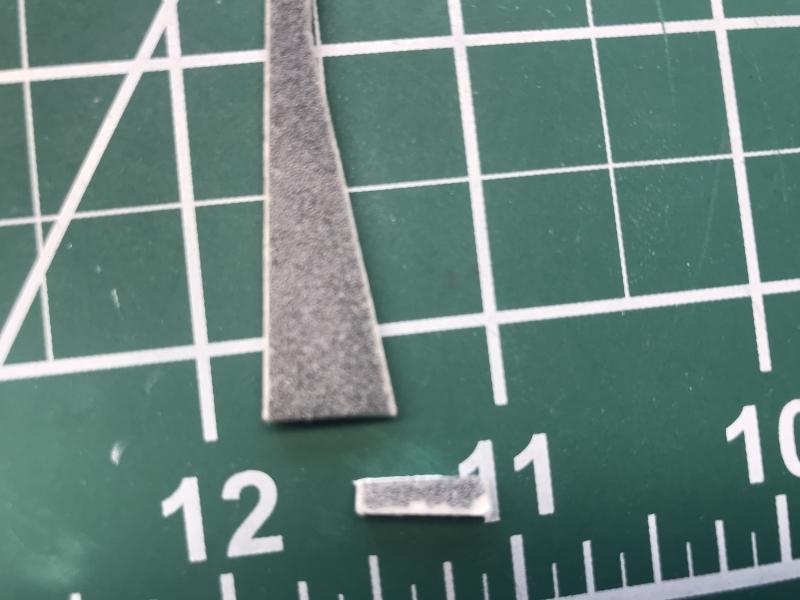

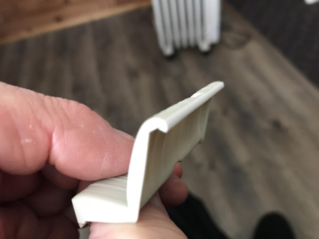

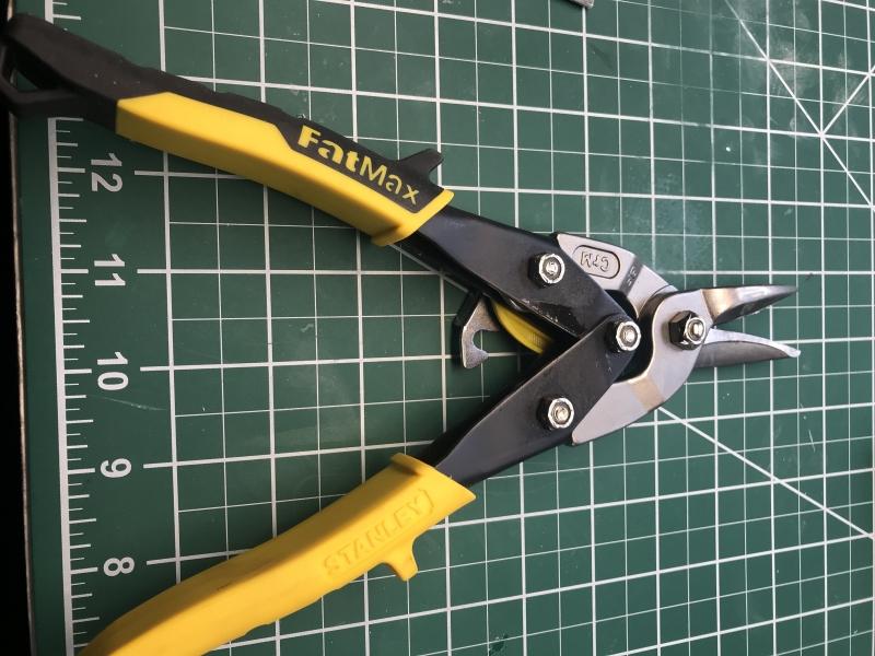

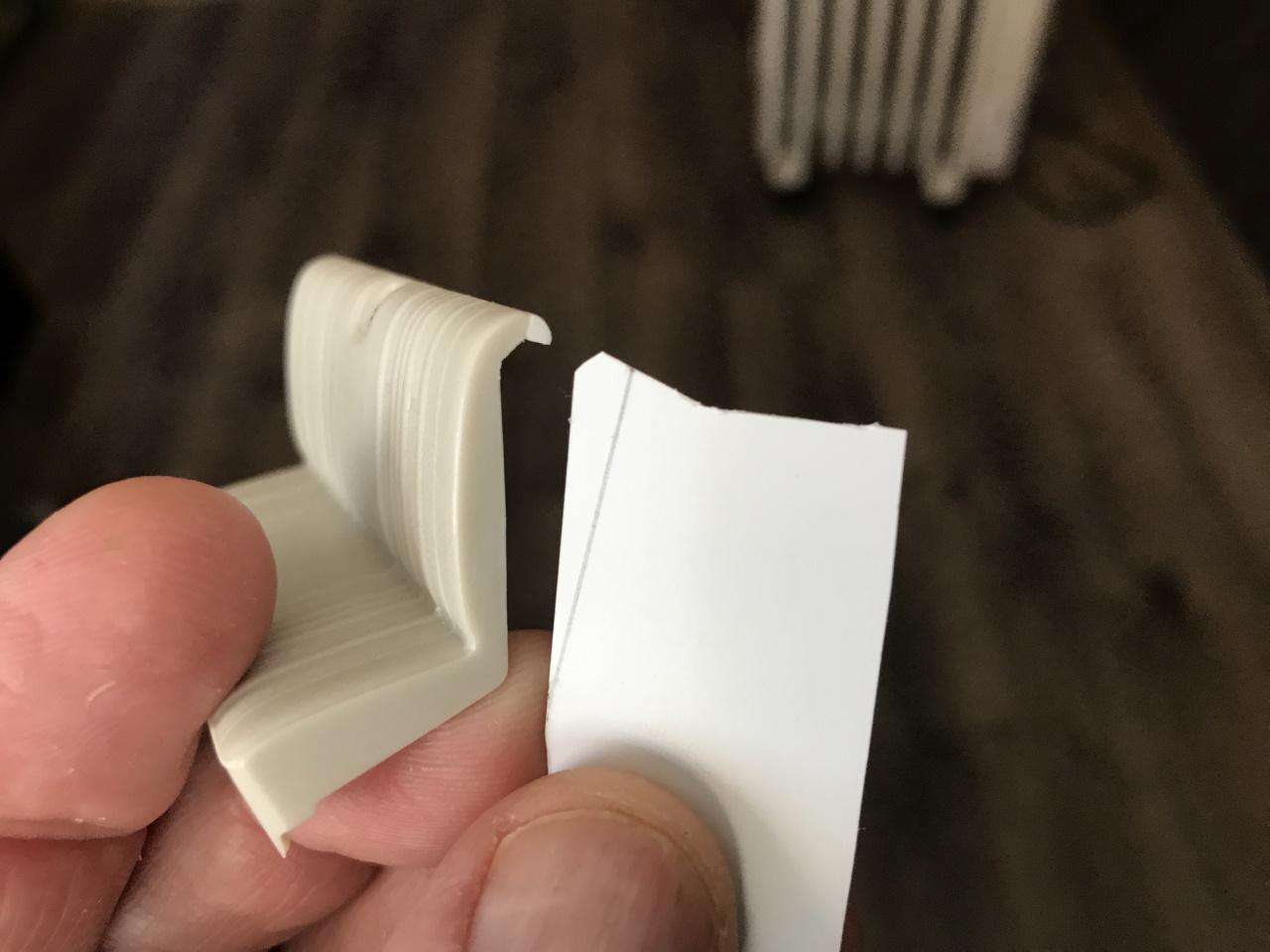

It's probably been mentioned here before, but if you're like me and use Flex-I-File sanding sticks (or other brands sponge-based sticks) the ends can get worn before the remainder of the sticks. I found that the Stanley Fatmax snips work the best to cutoff just what's worn and leave a nice sharp edge. Not saying Stanley is the only brand that will work, but I have other "cheapie" snips and they don't leave a sharp edge. I've never had luck with any scissors that I have around here either. The example I show isn't really worn too much but you get the idea ?

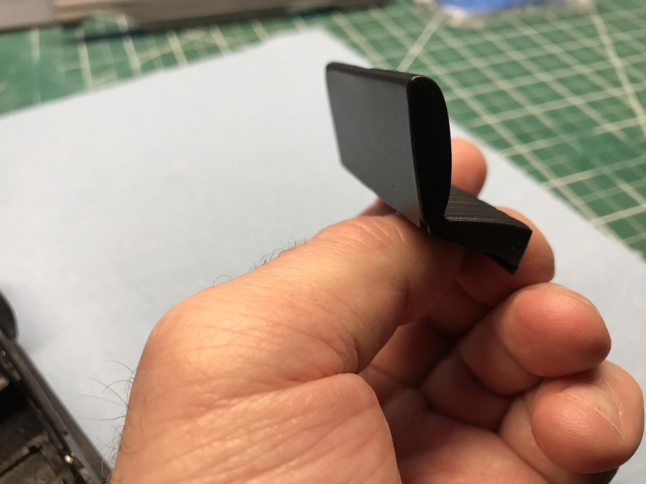

The texture is probably a bit too coarse for the scale, but I'm happy with it. I tried spraying flat black from a rattle can at a distance a couple of times but I just couldn't get enough of a texture. Thanks

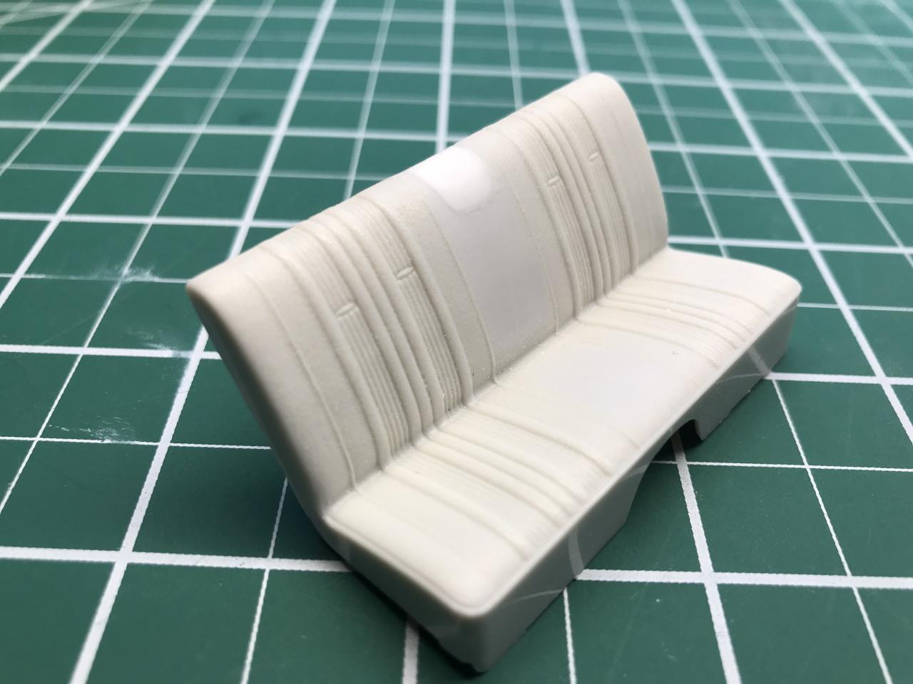

Yes the wheel cover decals are from Speedway and they worked great. The front seat wasn't really hard to do but you need a spare rear seat to convert and then fab up the backside. I like keeping the stock pleats and those chrome tabs. Thanks for the tip about Speedway Decals Lee ?

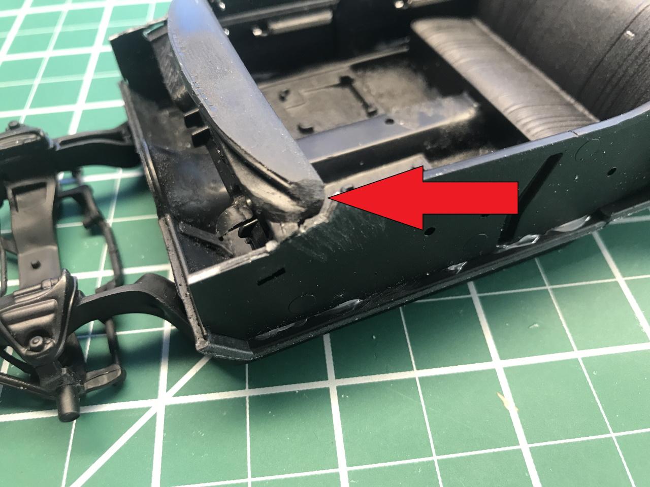

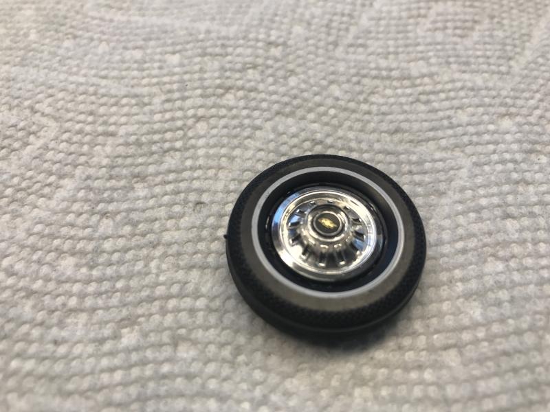

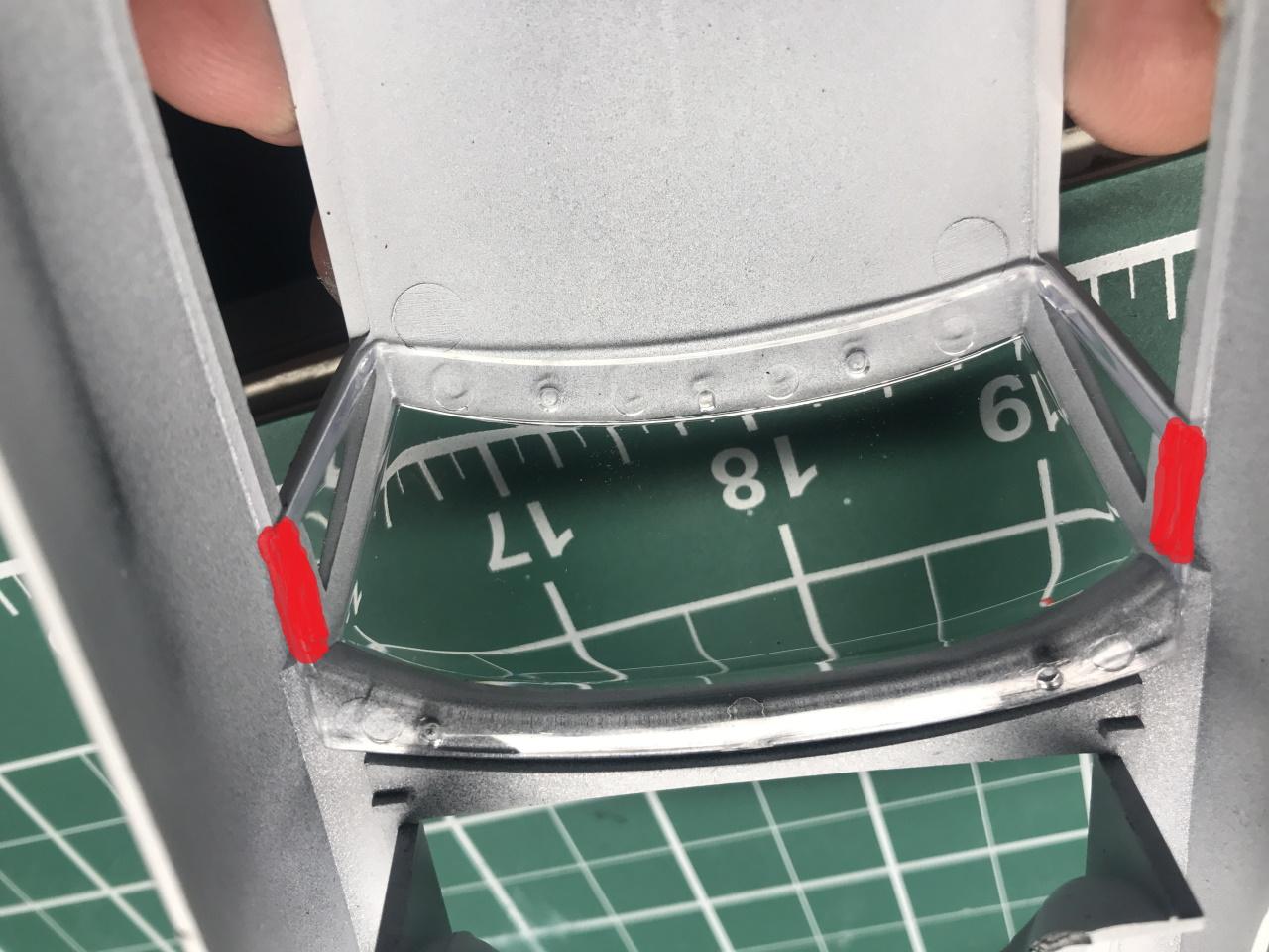

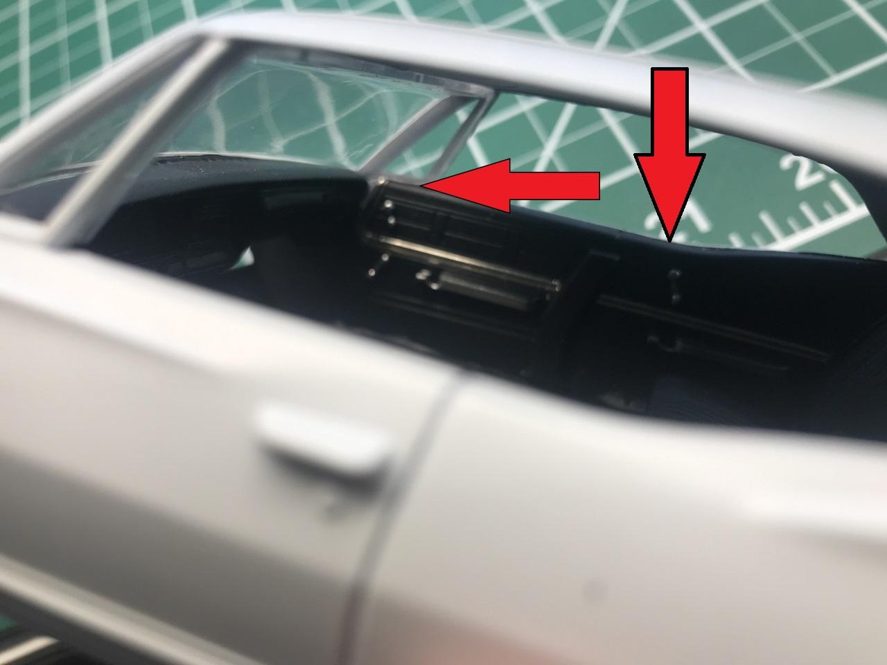

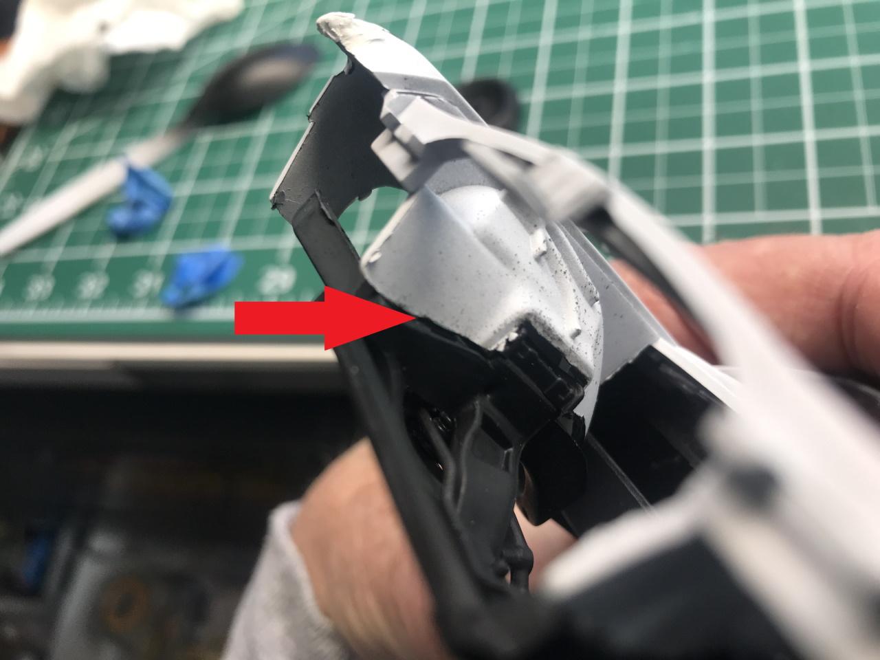

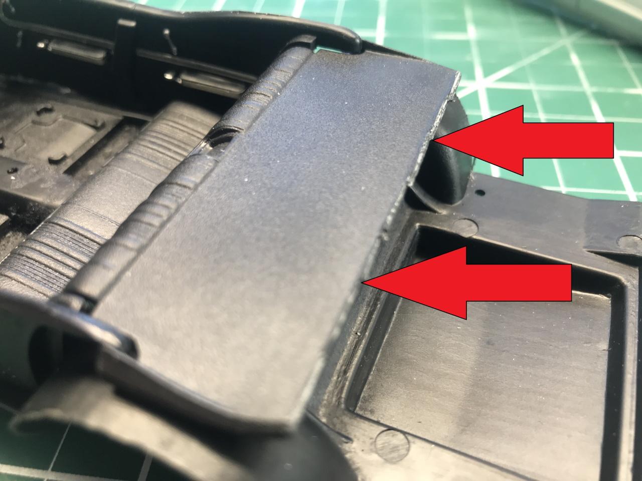

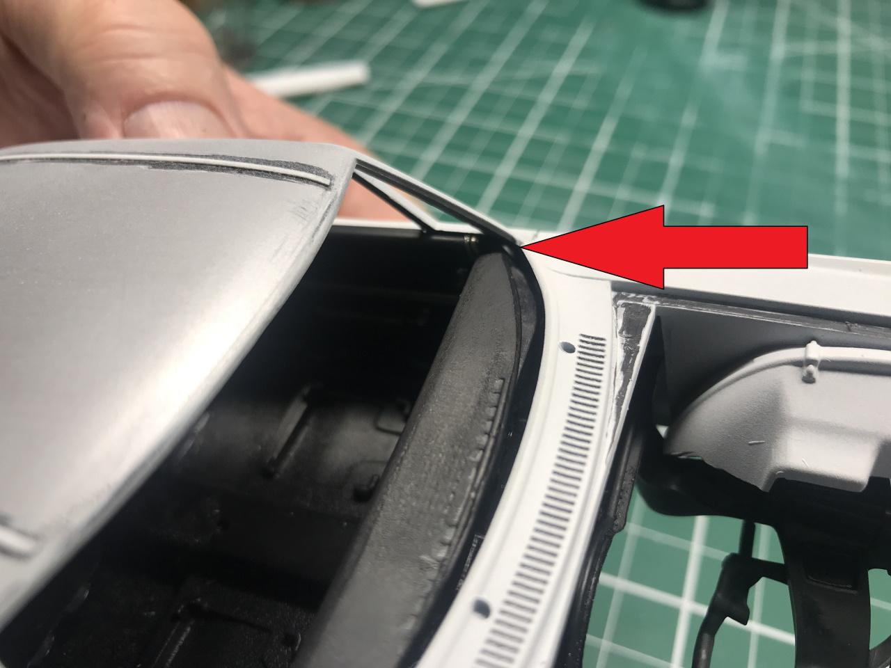

Doing test fits of the glass/dash/interior tub to the body/frame I noticed right off that there was a problem getting the body down to the frame at the front fender well. To me, not getting it down would keep the front high. There was interference at the spot marked where the dash met the body. Filing on the corners of the dash and part of the tub. Interference with the vent window glass kept the body from being flush with the top of the tub at the door panels. I cut a section out of the glass and filed until it all fit. I've marked in red the material I needed to remove. Also needed to remove part of the package tray for the tub to sit high enough in the body/glass. I used wheel covers from the SS annual but wanted to replicate the stock bowtie center. I punched out small discs from 015 sheet, painted black, and added homemade decals to the discs.

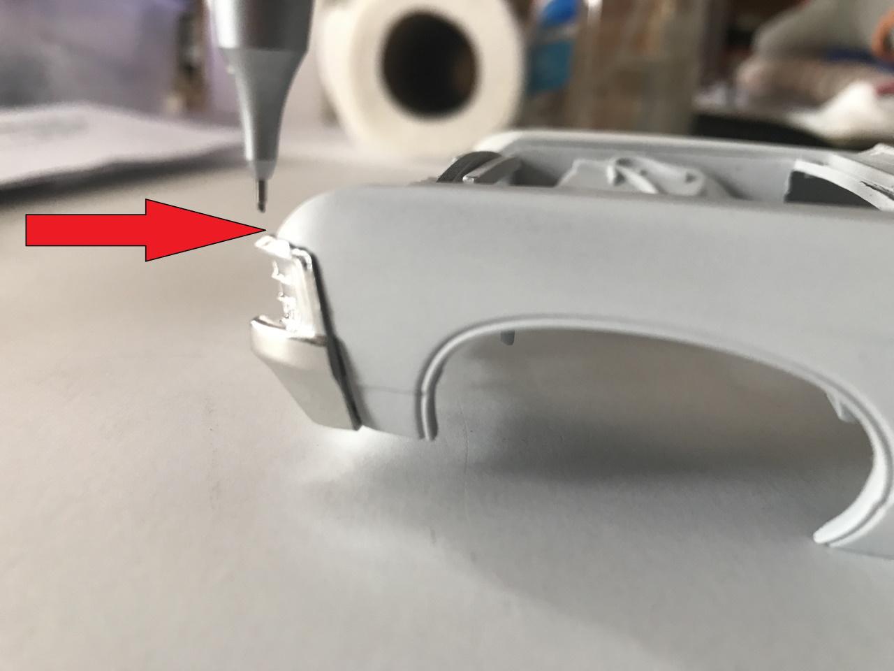

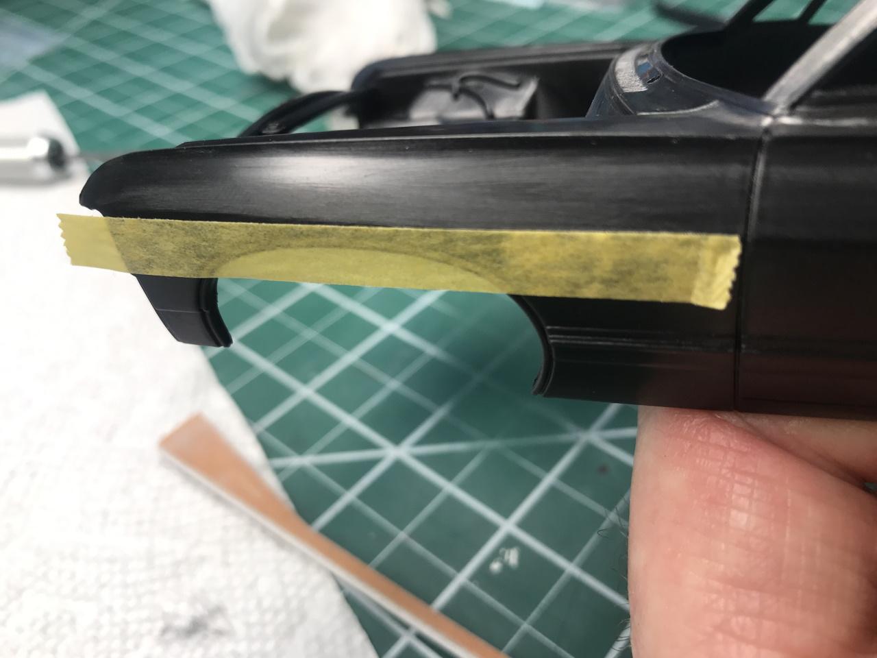

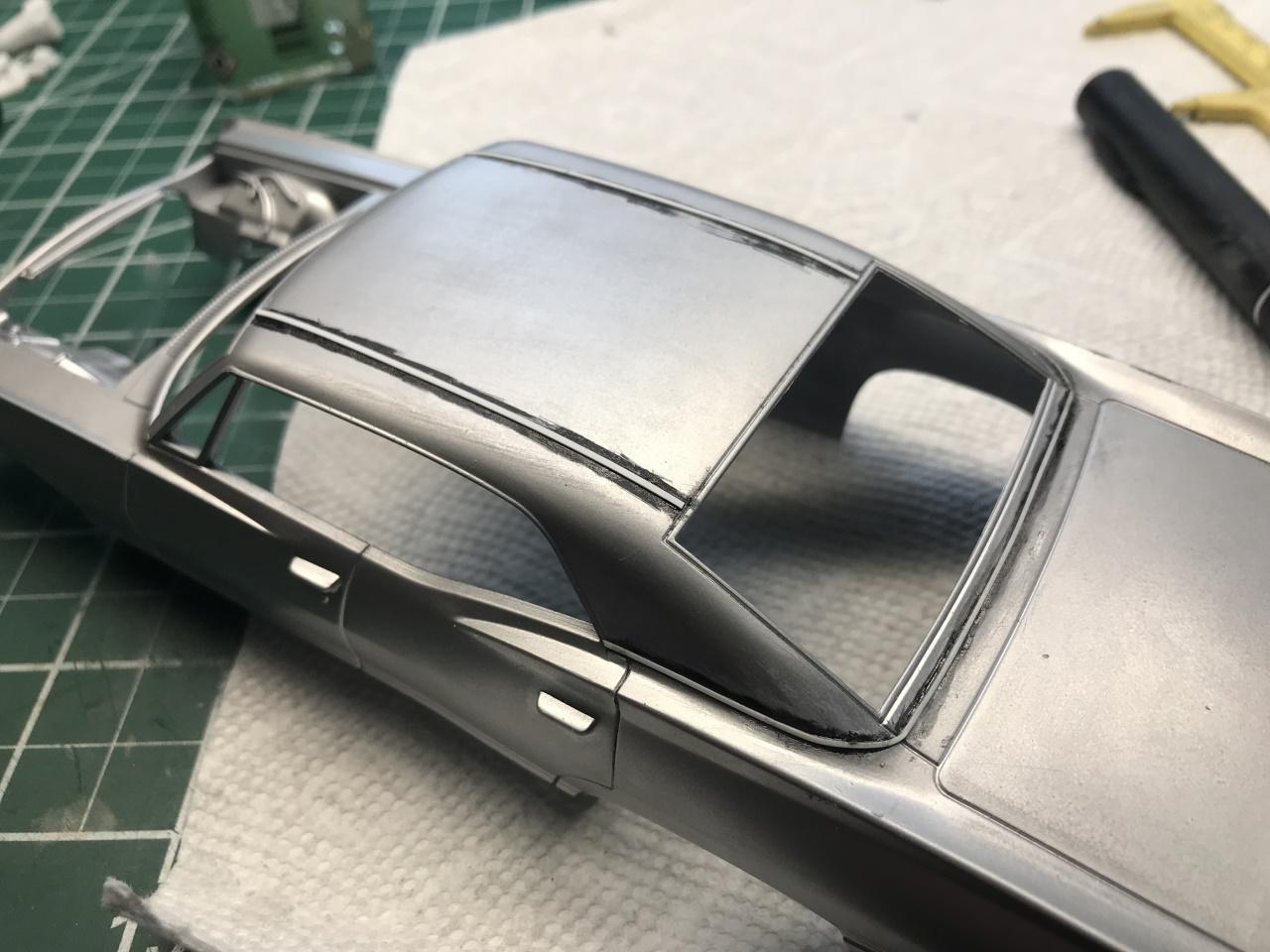

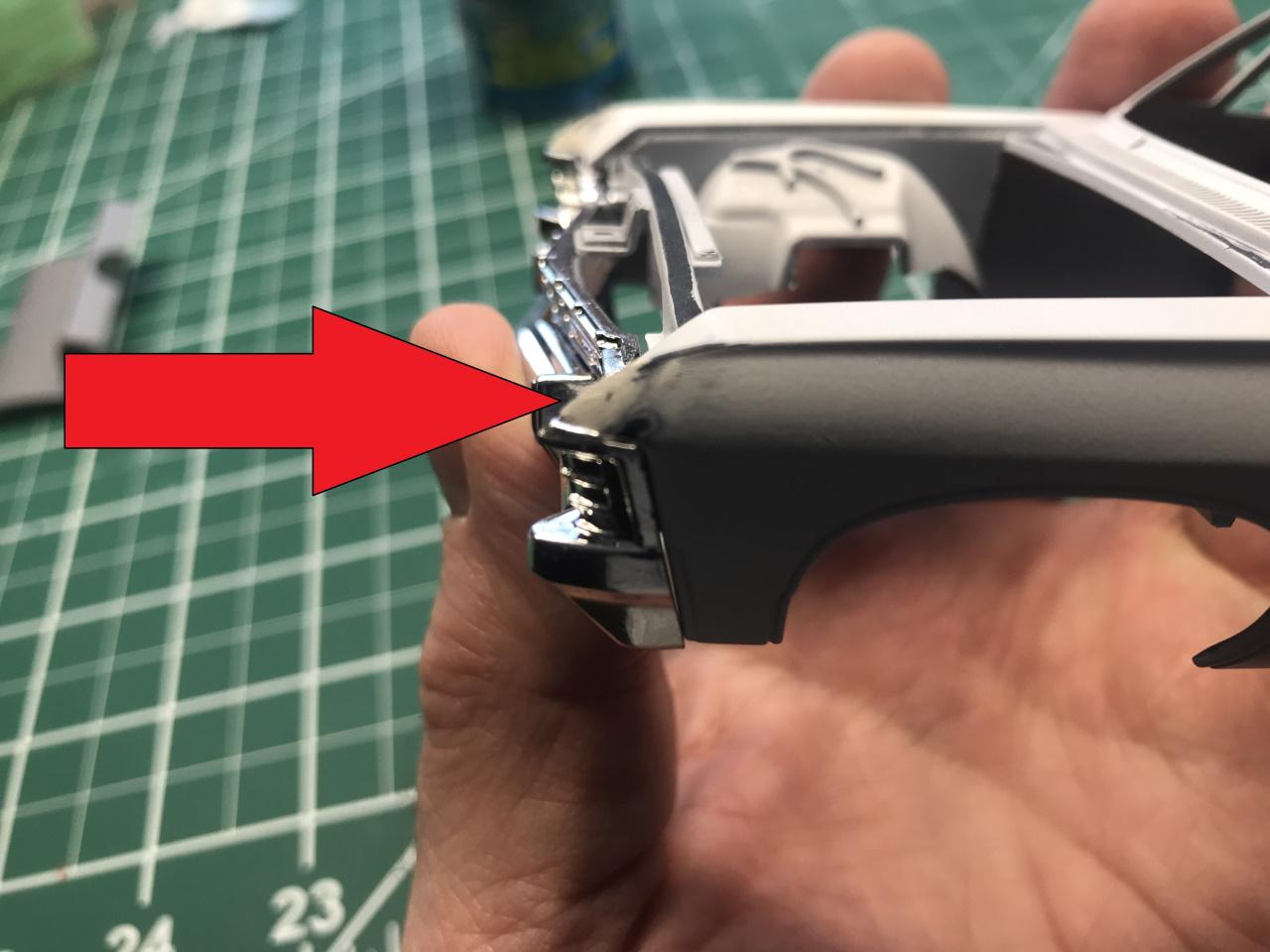

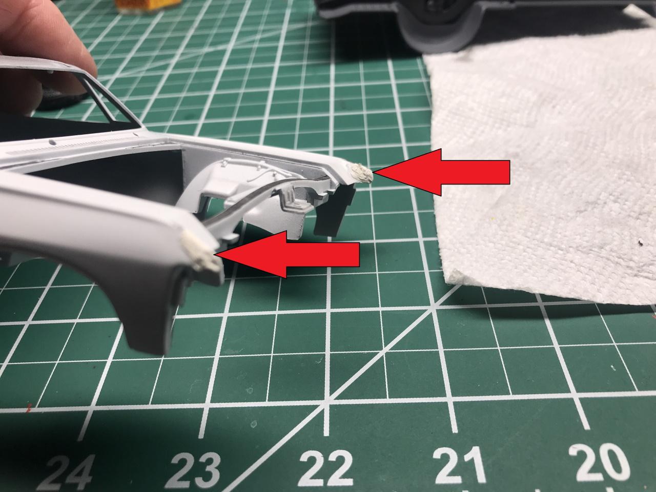

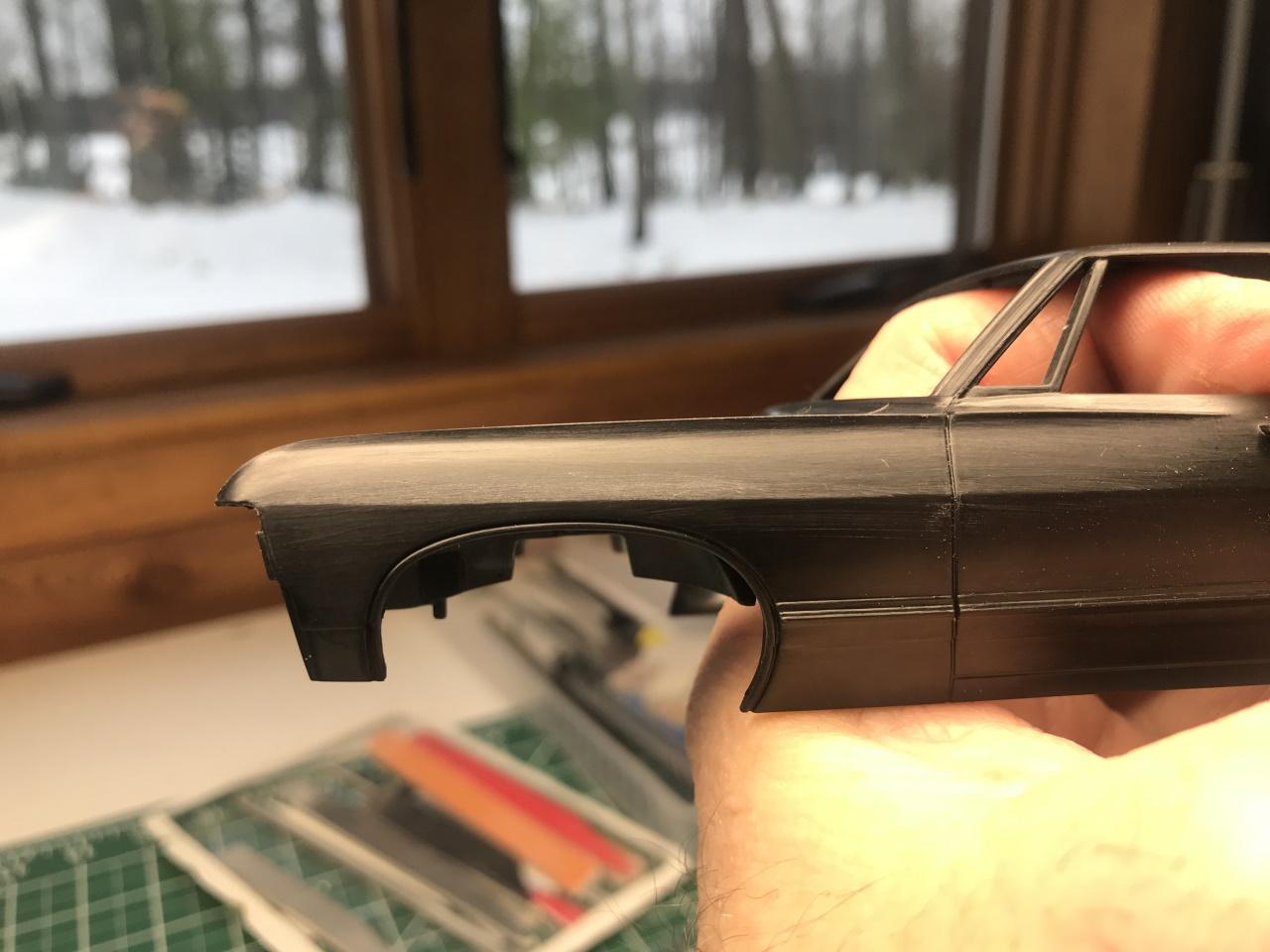

I'd been working on this build along with the '61 Impala 4 door for the past couple of months. This '67 build is about as close to our family's car that I could realistically get it. Dad bought it new in early '67 and it was the car I took my driver's license test on my 16th birthday in October of 1968. At times this was a frustrating build, trying to correct a number of issues that I found with the Supernatural kit. At least on my kit there were issues. I'm not embarrassed to say I built this into a curbside, although I'm sure many of you will roll your eyes . I saved a number of photos while I was doing the build and after I've got them all up I'll do an Under Glass on the finished car. First thing I wanted to try and correct was what I saw as an upward swing of the body line on the front fenders. After some shaping I was happier with the look, however that was only part of the story with how the front end just didn't look right. Too high and that upward swing. I'll post pics of how I dealt with the whole body/frame/interior/windshield fitment. Next I wanted to correct the leading edge of the fenders where they meet the grille trim. My kit needed an extension puttied in to correct it. We had a vinyl top our car and this was the first time I've tried replicating one. I needed to add the trim at the rear and the C pillar (or would it be the B pillar on a hardtop?) and ended up using Testors Fabric Black which I was happy with. I wanted to try and replicate the stock Impala pattern on the front seat rather than use the Supernatural bench. I used the rear seat from a spare '67 kit, filled the speaker, and then needed to fab a seat back and sides. I used quarter round and flat sheet and I think it looks pretty good. Not a perfect front bench, but at least the pattern is correct. The rear seat was easier as I only needed to fill the speaker opening. Our car did not have that option but had a speaker on the package shelf.
