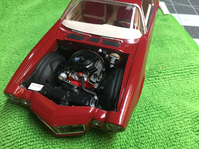

I picked this one up at the flea market last Sunday. After reading some opinions on here about these AMT Corvettes, I decided to build it quick and not worry about getting too precise or detailed, since there is only so much you can do with a kit like this. I think the body is not too bad, except for the headlights. The chassis and engine are pretty horrible!

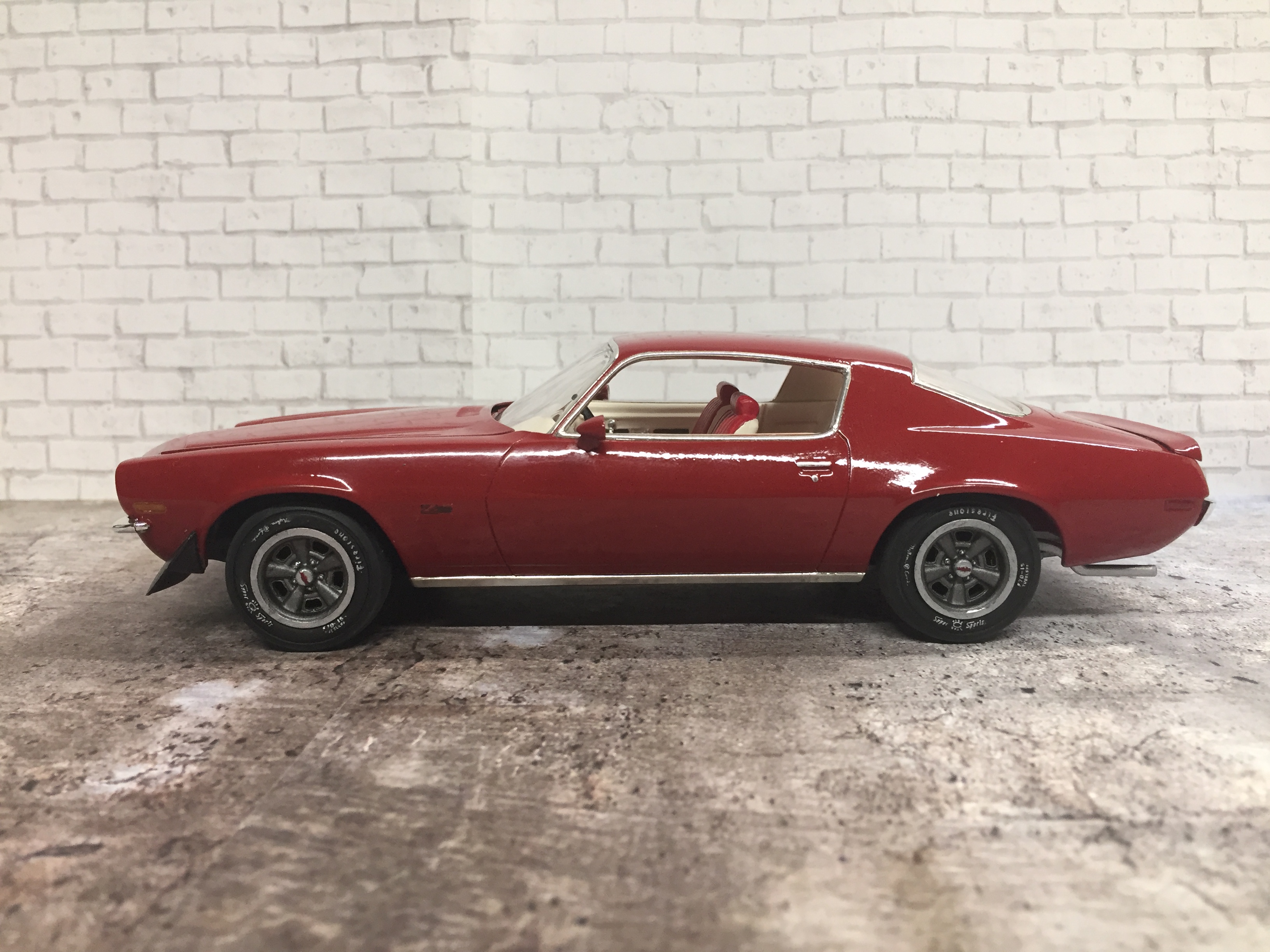

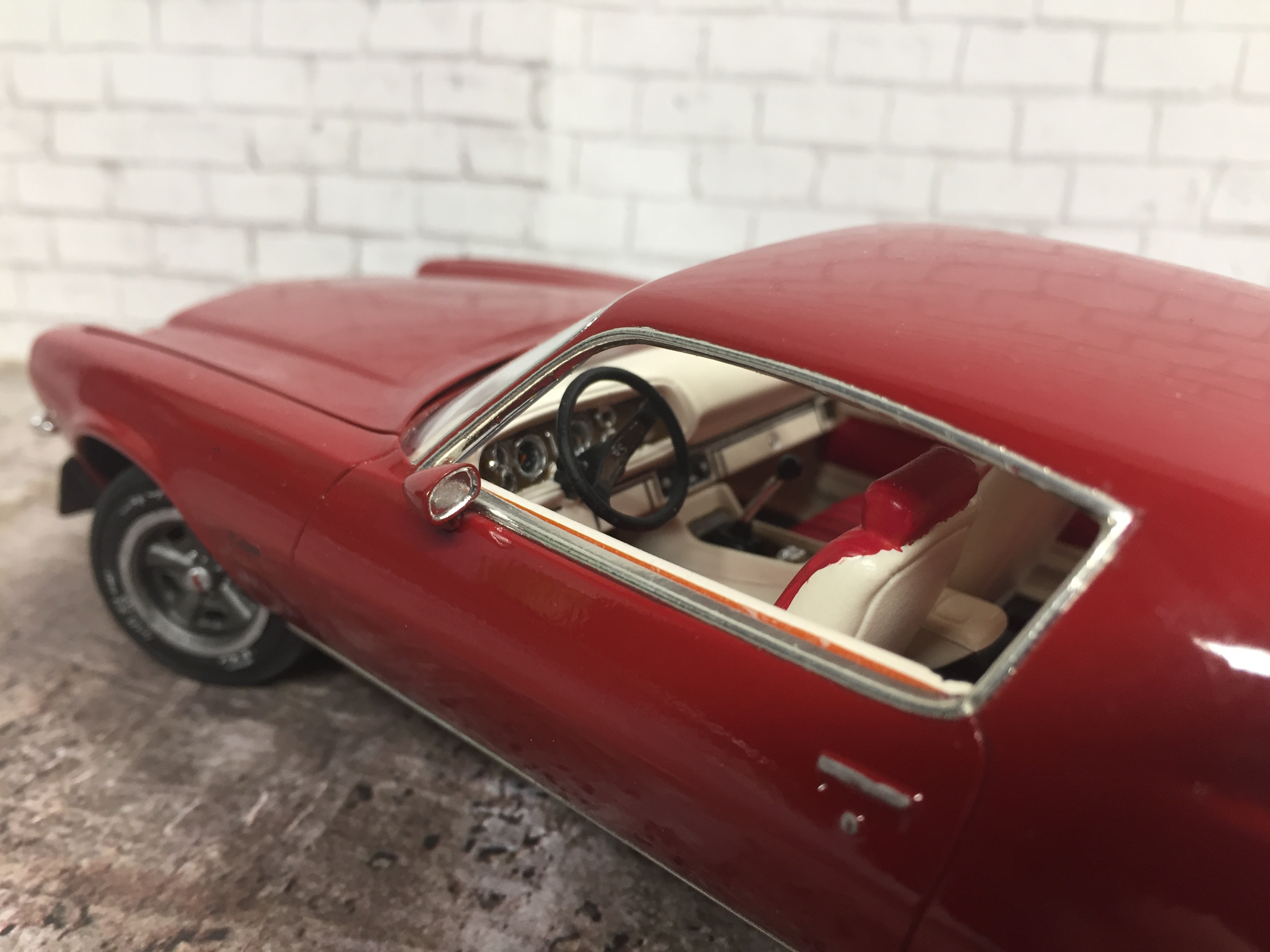

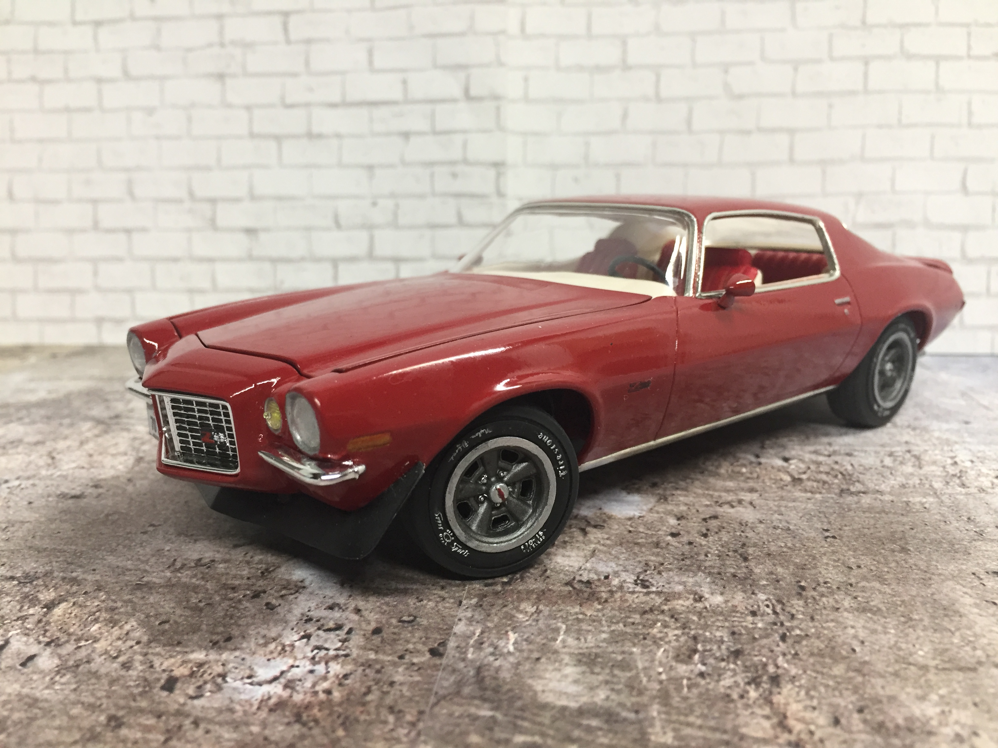

This one is pretty much done. I still have to fix the door panels so the orange plastic doesn't show, re-coat the side mirrors with molotow and raise the exhaust tips some as I think they are hanging to low. I am not thrilled with how the paint came out, but good enough for this one. I will try to do better on the next one. Baby steps...

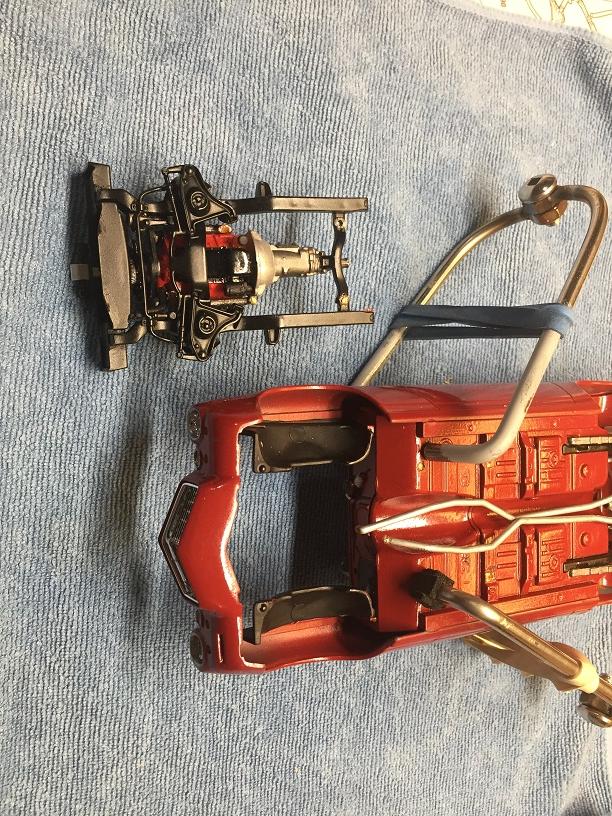

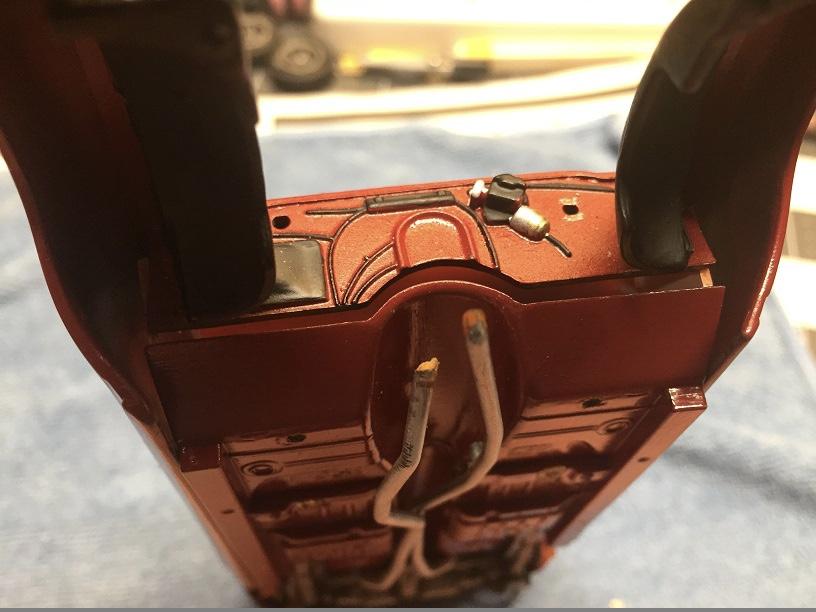

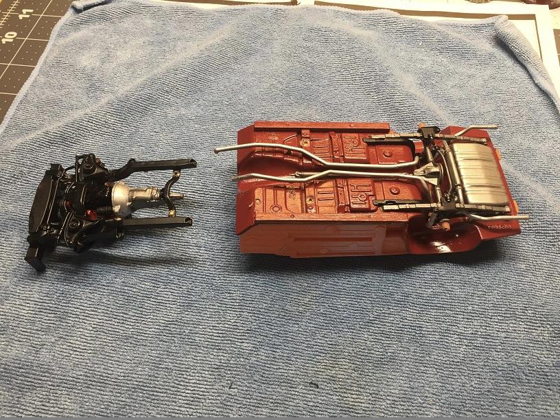

After all that mucking around I finally got the floor pan to meet up nicely with the firewall. Then the front sub-frame c/w engine and radiator support just slid nicely into place as if it was supposed to be installed last! Big sigh of relief!!

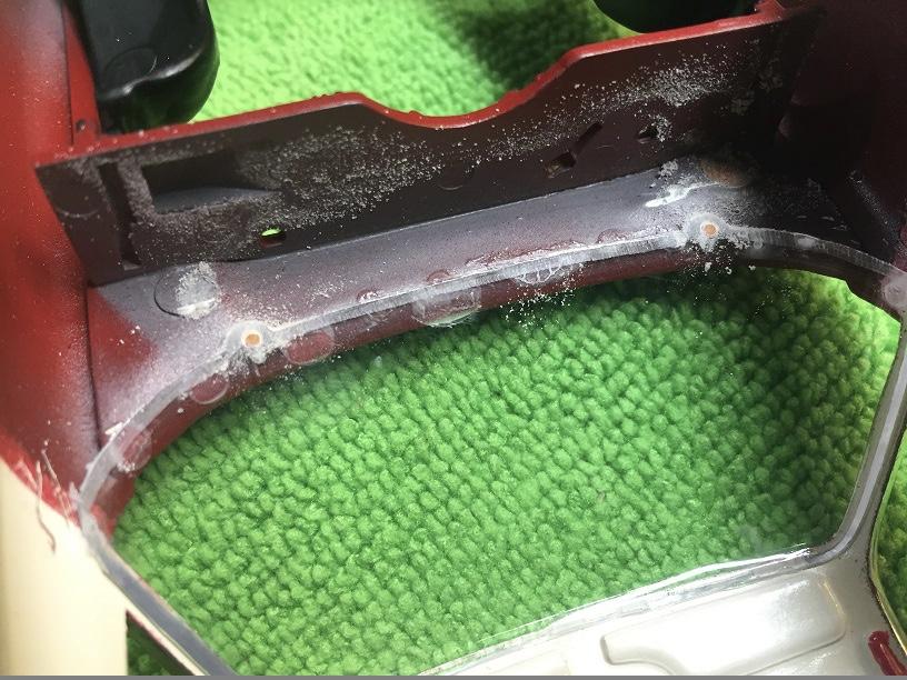

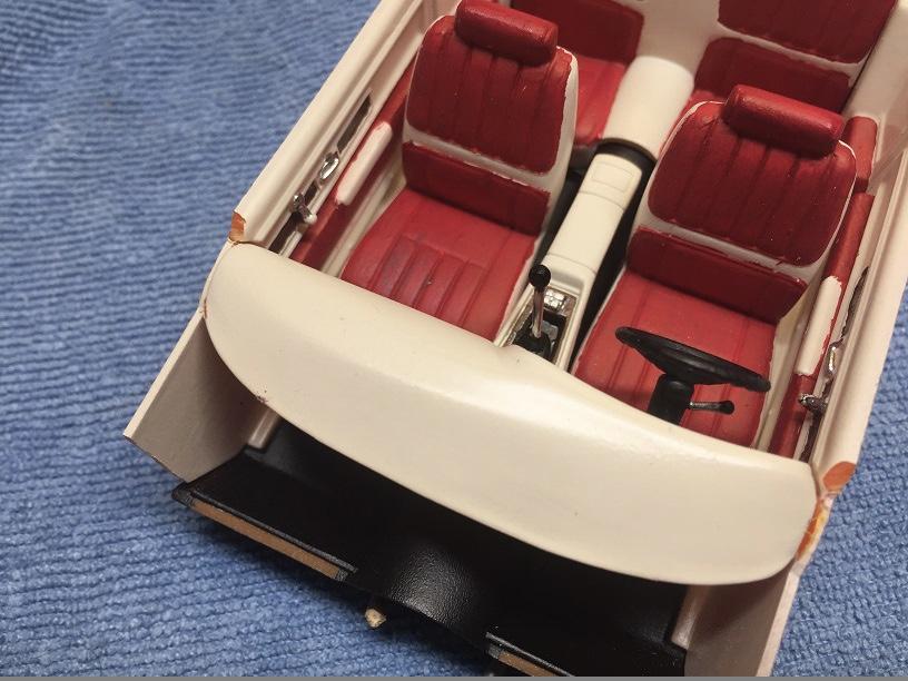

Thanks! I made a big mistake in assembling this particular model. I glued the front and rear lower body panels on so that I could fill the seams and do a nice paintjob. However... once that is done, it is impossible to fish the floor-pan/front sub-frame into place. I determined at this point, that the best solution would be to remove the front sub-frame from the floor-pan and install it after the floor-pan was in place. It came apart with minimal glue points. Whew! Now, I go to install the floor pan, which is no longer easy, since the rear body panel (that holds the tail lights) is in place. It was a process of: fish the floor-pan in so that the rear wheel wells are inside the body, pull it forward and stick a finger in through the side window and pry the floor pan downward so the two locating tabs would mate up while pushing the floor-pan rearward again. I thought the first attempt was a little tedious... and then the front of the floor-pan would NOT meet up with the fire wall like it was supposed to! Well to make long story short...there is a huge fitment problem between the dash/inner door panels and the grossly thick wind shield. after 20-30 repetitions of trimming and fishing the floor-pan/tub in and out, I got it to fit. Some pre-fitting would have saved me a lot of work.?
